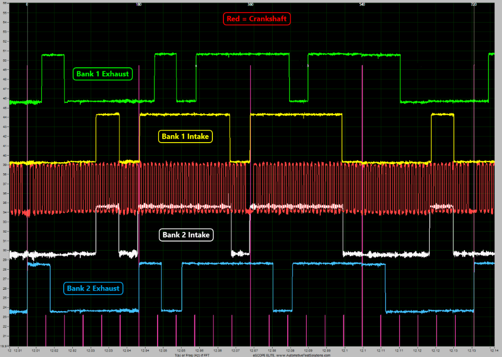

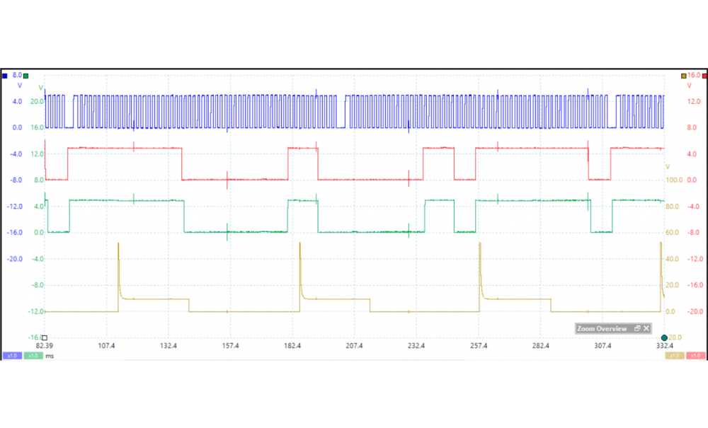

Thanks for this! There are lots of the older 3.6 waveforms out there but this newer LGX 3.6L is quite a bit different so I'm not confident in using those. I'm hoping someone has the later LGX, 2016 and up, 3.6L waveform.
I did find one on an 2010-2017 Equinox LFX 3.6L engine that looks very similar to yours, if not the same.

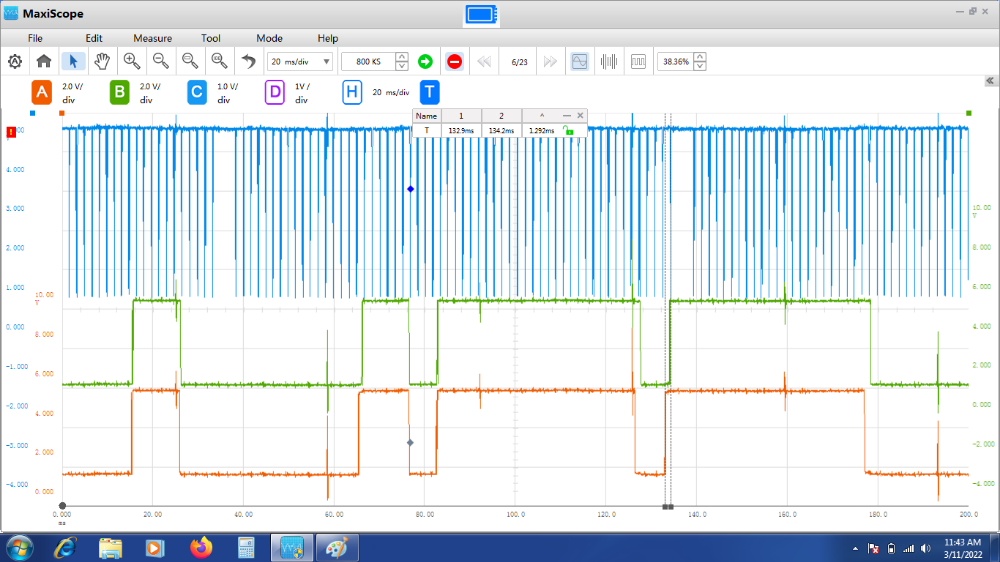

I got a cam/crank waveform today. It's just the intakes since that's what I had codes for. Bank 1 is on the bottom, Bank 2 in the middle and crank on the top in blue. My crank waveform looks different than all the others I've seen but appears to be a 60 -2 reluctor. If the above are known goods for the LGX engine then, as far as I can tell my bank 2 intake cam appears to be retarded about one reluctor tooth, or 6 degrees. The bank 2 cam appears to be retarded about 8, maybe 9 degrees.
I've watched a ton of Paul's videos (and others) on this but this is the first time I've actually done one of these myself. I welcome any other opinions on what I'm seeing in my capture.
