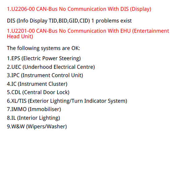

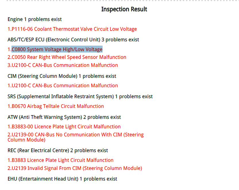

Opel Astra 2005 engine xep16 Radio not working I guess I start there to test power and grounds but what do you think with this fault codes

I would first clear all the codes and see which ones come back.
If you got a scope and break out box, check the Can Bus communications high, low.
Identify how many modules the car has and how the they are connected wiring wise.

Replied by spit64 on topic Where to start troubleshooting
Thanks I do that next time I got the car I have 2 ch Pico and Godiag GT100
