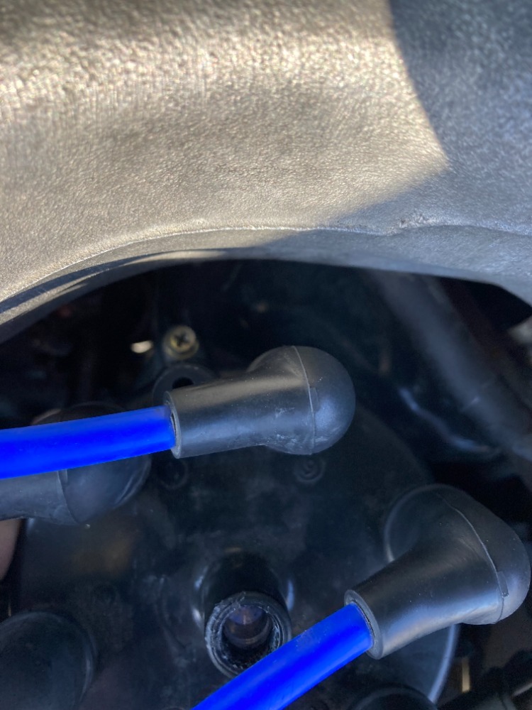

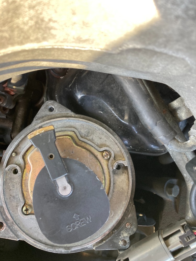

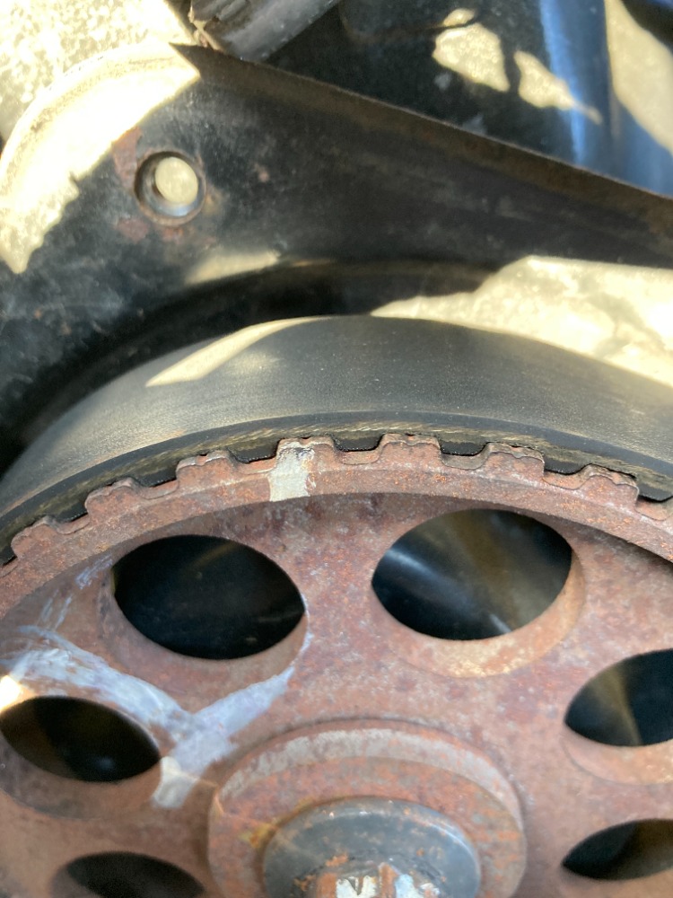

I had it towed to my friends and started looking for air leaks. I pulled the o2 sensor to see if its a exhaust restriction. One wire was basically frayed off and it was still getting hot. I messed around with the timing and was able to get it running without the MAF plugged in but it misfires and backfires through the intake. I checked that cylinder #1 was at the very highest point with the cam mark and a scewdriver as the photo shows

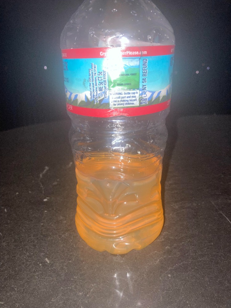

I put the fuel line in a bottle to look and see if the gas looked dirty and attached the photo. I sprayed some starter fluid in the throttle and didn't seem to improve the condition. It had a full tank of gas when it died but I know the bottom of the tank was a little dirty from sitting. It has a new amazon fuel pump in the tank directly wired to the fuse box. All the injectors on the rail are new OEM style.

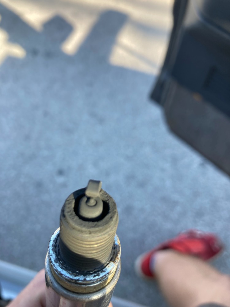

I just reset the engine timing as shown in photos. Black soot on the plug #1. It cranks nice and cylinder one 1 had 155 psi compression checked. Still just cranks....

If you have a scope, check the signal wires. You won't be able to pick up drop outs with a slow DVOM. Absent that, check for play in the shaft of rotor which might be bearing failure and debris on the slits of the disc like this case study from Paul:
www.scannerdanner.com/scannerdanner-prem...-start-no-spark.html
