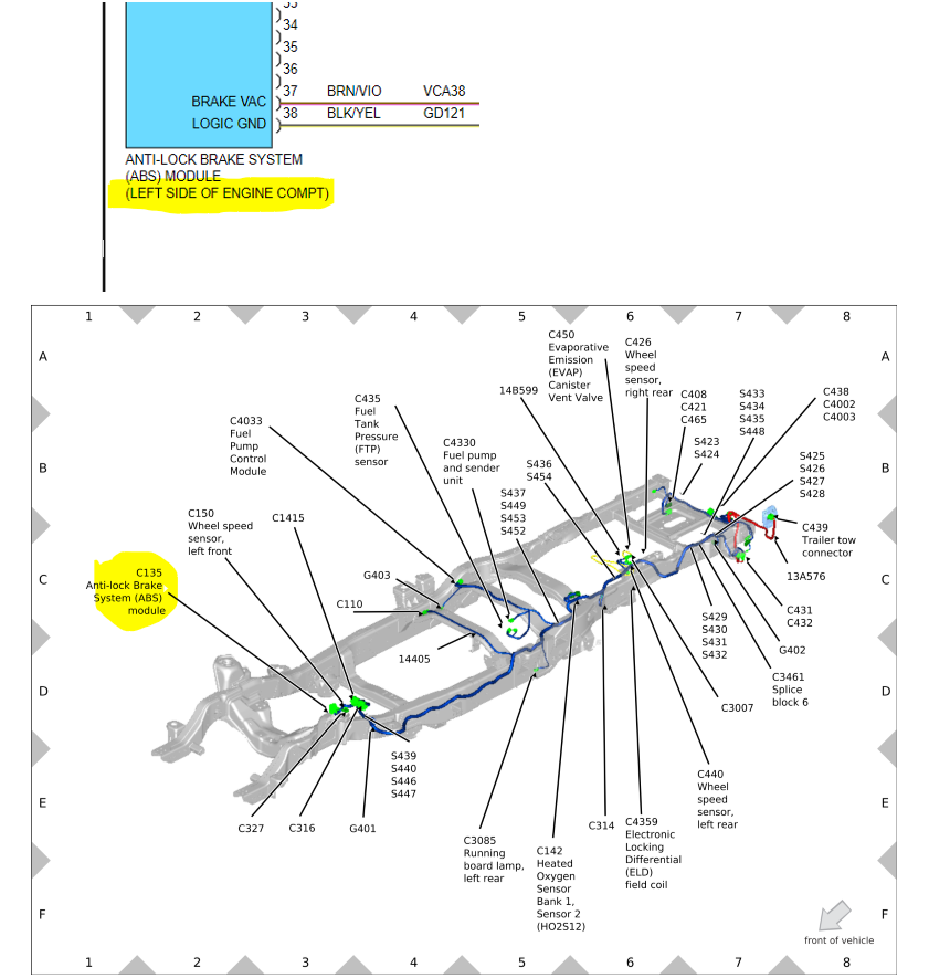

I forgot to ask again, do you know where the ABS control module is on this truck?

4 years 7 months ago #55504 by jreardon
Diagrams attached at bottom of this post.
I had cleared the codes but the ABS and advance track lights came back on immediately.
abs module must not like something about that circuit, try ohming it at the abs module.

Thanks. When he brings the truck back, I will do as you suggest and inspect the wiring from the ABS module back to the connectors.
