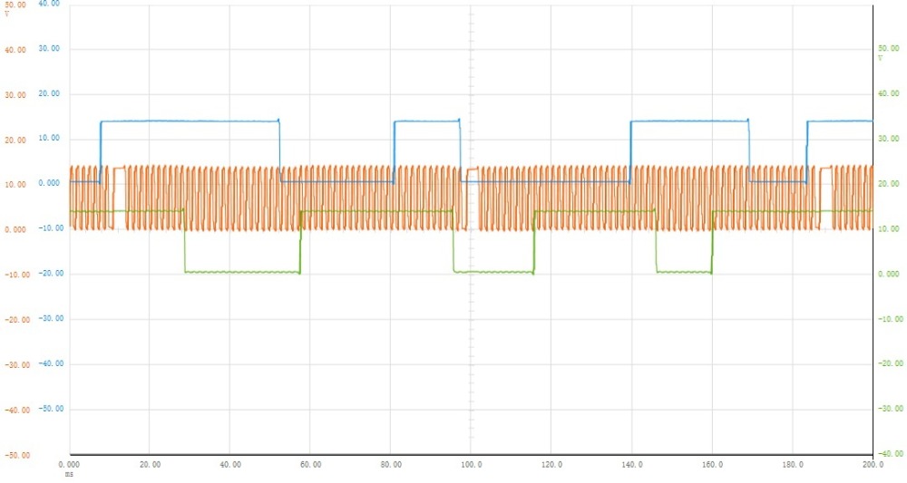

Good dayI need some advice on this mini. Came in with a rattle noise from front cover. Removed valve cover and saw that the timing chain guide was broken. We replaced the timing chain and guides. Put it back together and ran fine. Engine light came on right away with code 296b exhaust camshaft sensor. We checked sensor and it looked good. we swapped it with intake sensor but the code didn't follow sensor. checked the solenoid. all good. swapped the solenoid but still the same code. took it apart again to check the timing. timing was right on. bought another timing alignment tool thinking that the first one I bought was not good quality. Aligned it again. still the same. we did adaptation reset. still same code comes up. checked wiring to sensor to make sure no shorts to ground or power. all good there. finally hooked up an oscilloscope to see cam crank signals. compared the capture with 2 that I found online. That's where I'm lost now. to my untrained eye it looks like this car should not run. but it runs good. would appreciate any advice you could give.

Those captures all look the same to me. Did you accidentally upload the same one four times?
