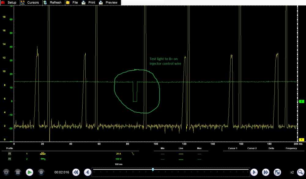

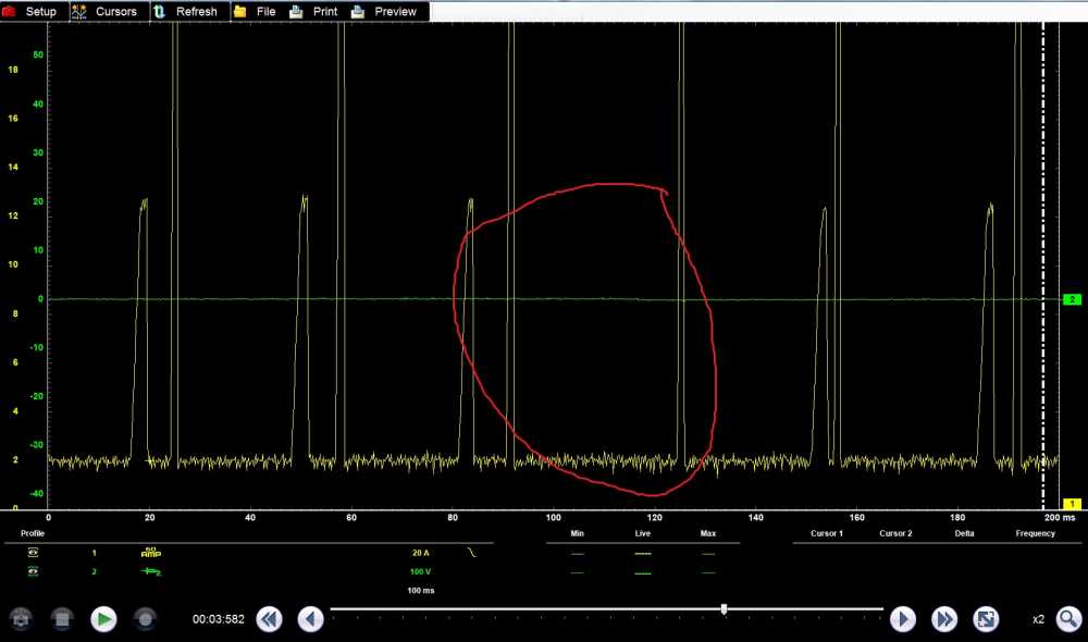

100% agree, injector is gonna fix this one. B) Good work with the test light, BTW. A scope waveform would have been fun, but I think you proved the failure without it.
If it helps you (or anyone else following along), here's a couple captures I took off the Charger 3.5L with a P0206 and P0306. Yellow is a amp probe on the power feed fuse for the injectors and coils, green is connected to the #6 control wire. The super tall towers are the coils, the shorter ones are injectors. There's one missing because it's electrically open, and 0V on the control wire, indicating a complete open in the injector.
Then, I added a test light to the injector control backprobe. The green trace now shows a pulse where an injector current ramp should be, confirming PCM control.
