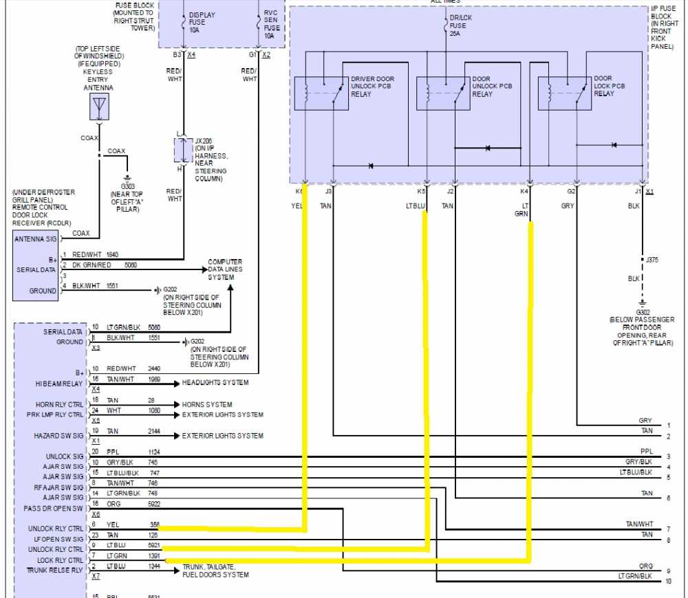

I'm trying to troubleshoot the locking/unlocking of a 2008 Chevrolet Impala 3.5L 6cyl
Here's the problem all of the signals work except the shift out of park ( the only signal that the BCM does not see is the shifter)
So my question is does that signal come from the A/T shift lock control solenoid or does it come from the Acces wakeup serial data?
To make my question clear Where does the BCM get the signal to lock/unlock the doors once the car is in gear?
I would think A/T shift lock control solenoid because that's the only thing that makes sense to me.
Am I wrong?

9 years 6 months ago #8417 by gav09
Replied by gav09 on topic Where does the BCM get the signal?
Here is a wiring diagram. I highlighted the control wires in yellow. The BCM controls the lock and unlock relays.
Do you have a scan tool to look at the BCM inputs? The lock and unlock relays are PCB relays soldered to the circuit board in the instrument panel fuse box. Looking at the BCM input data would be helpful.
Is there an option on the instrument cluster to disable this feature?
Do the locks work with the switch?

Yes, the locks work with both Key FOB and the switches but not when the shifter is put in drive when they should lock.
And I have this wiring diagram

9 years 6 months ago #8511 by Tyler
Replied by Tyler on topic Re:Where does the BCM get the signal?
Albee9 wrote:
Tyler wrote: Just looked over the diagrams, the signal does come from the range switch inside the transmission. Goes to the transmission module, which goes out over the network.
So are you talking about the acc wakeup data line?
Because I was thinking that or the A/T shift lock solenoid.
Ok, I think I see where the signal comes from now which is the hi-speed data line from the transmission module.
just wanted to make sure my thinking is right.
I don't want to waste too much time when I do get the car which will be the end of this month.
Am I right??
If I'm right I want to thank you all for your help.
Your thinking is right! :cheer: Pretty sure it gets that data from the high speed network, and not the wake up line or the solenoid.
