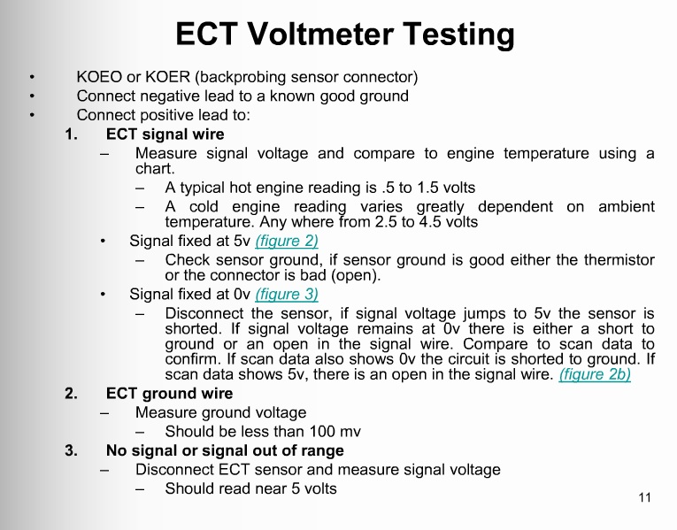

9 years 6 months ago - 9 years 6 months ago #8515 by Tyler
Replied by Tyler on topic 2008 civic si 5th and 6th gear lockout
SamMagiske wrote: So after some investigating I found that the wires to my speed sensor were cut. I soldered them back together and wrapped them up. So my speedometer is working again, the reverse lockout is back to normal (the computer didn't register movement since the wires were cut) and my power steering issue is gone.
Makes sense to me! I knew there had to be a connection. :lol: I didn't know that the reverse lockout was associated with the speed sensor, though. Interesting.
It is still throwing a code for the coolant temp sensor. I topped off the radiator, and overflow. I erased the code and it just came back. No over heating issues, runs at normal temp, and the temp gauge works like normal. So don't know what's going on there
If it's ECT2, then that'd be the sensor monitoring the thermostat for proper operation, and not the primary temperature input to the PCM. A hard code (one that comes right back) will make this much easier to diagnose. ;)
First step will be to find ECT2 and take some voltage readings on both wires, plugged in and unplugged. Those tests will let us know if you have a sensor problem or a wiring problem.
