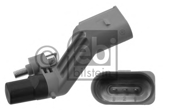

Hey guys i have a problem with an 05 vw polo classic 1.6 BAH.
The vehicle came in last week with a no start condition.
I have scanned for dtcs and found a crank position sensor intermittent dtc. Strange thing is that I somehow have rpm but 0volt on the signal wire, no spark and no fuel. (I dont have a scope so I got no choice but to use a dvom) So I have checked wiring integrity - 100%,. So I replaced the sensor, and problem fixed. Exactly 1 week later the car has the same issue again no start - crank position sensor intermittent dtc I dont know if its a coincidence or if something is causing the sensor to fail. I have rpm again, but no fuel or spark.
I cannot check the pick-up because I need to remove the gearbox to do so as the pick-up is through the rear main seal (the ckp sensor bolts onto the rear main seal housing).
Has anybody experienced these problems? Any input will be appreciated before I remove the gearbox to inspect the seal

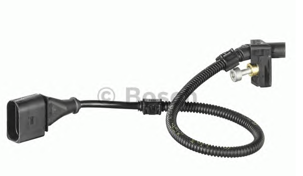

Thanks for your reply dzof.
But, I worked on BAH engines twice and Im quite sure that they dont have a separate rpm sensor.
It does have the exact same crank sensor though (febi/2nd pic)
And, another test confirmed that - unplugged crank sensor and the rpm signal dissappeared.
This vehicle only misbehaves after being kept on idle for more than about 15min (when it heats up abit) and it will eventually cut off on its own and will not restart unless left for a few hours. The owner did also notice the tachometer (rev counter) jump around strangely just before the second sensor could get faulty.

Regarding the brand of sensor..
I replaced the OEM sensor with a DELPHI sensor.. Febi was not available at that time and an OEM sensor is just stupid expensive.
Sent from my SM-G531H using Tapatalk

This is also fixed - crank sensor pickup was damaged and somehow also caused the coilpack to burn out..
