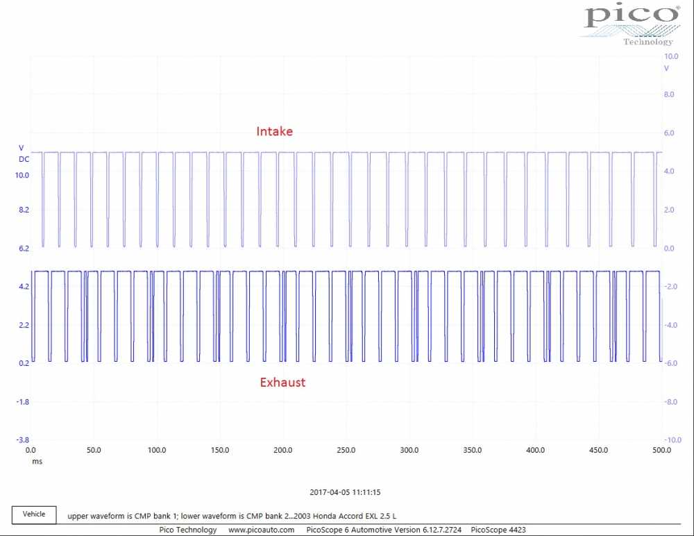

Thanks Tyler...as to the camshaft sensor, the topmost pix is intake side (bank1?) and lower the exhaust (bank2)...wondering which is a normal. Also I think I should post steps on uploading waveform from PICO files...

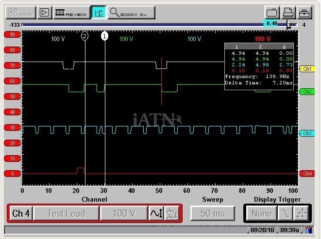

I marked up your original waveform with the intake/exhaust labels for my own benefit:
After you let me know which was which, I started to make sense of it. Here's a known good I grabbed:
The yellow in this capture is the intake, and green is the exhaust. You can see how the valley of the intake pulse is intersected by the downswing of the exhaust pulse. The intake and exhaust pulses on your capture never seem to line up, ever. :unsure:
Are there any running issues on this engine, or any other codes? I think it'd be useful to look at both the CMP signals with the CKP as well, to determine if one or both are out of time.

Tyler...sorry for the late reply. The car is running smoothly except for the DTC PO341. Capture I made was not at the same time. They were seperately probed; unfortunately the owner had to rush and drove his car for an important appointment that is why I did do any other test. Have not heard fro him though. But if he does, yes I would like to do a test with the CKP and CMP at the same time...i will update you.

I would love to be able to look at those waveforms and tell you what your problem is but I am not well versed enough. I can tell you from experience that when you have this trouble code- and the engine runs fine.... whether or not it sets on cranking or 10 miles down the road- your cam chain is beat. Pop the vc- put it up on tdc- and you will see the cam marks look like this : ____

Oh OK, gotcha. ;) Like fudgie mentioned, if the engine is running well, then it is likely to be a chain slack problem. :( How many miles on this Accord?
