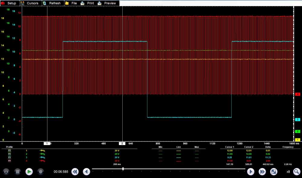

If the FPDM outputs a 50% duty cycle, the FPDM is functioning normally.

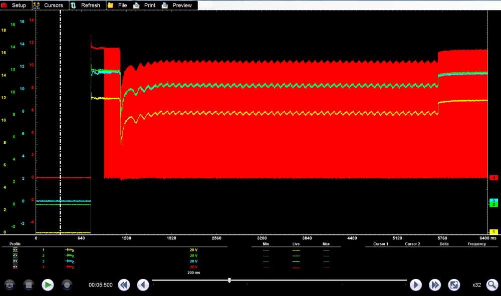

I have some captures of this system from a newer F-150 - different truck, same system. Green is fuel pump power, yellow is fuel pump control, red is the PCM's fuel pressure command, and blue is the FPDM's feedback. This was taken KOEO.
During cranking (and starting), those signals should look something like this:
Note the yellow trace starts pulsing, showing FPDM control of the pump. Blue keeps pulsing the whole time, which is good.

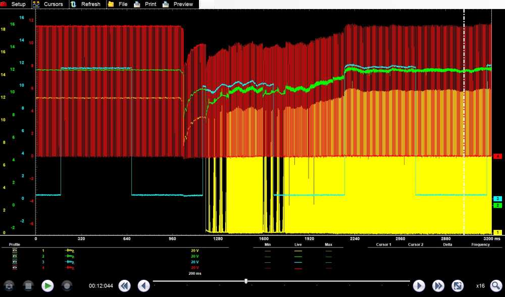

This next one is the same truck when it wouldn't start due to no fuel pressure.
No signal on the blue (fixed high), and no control of the pump. The lack of activity on the blue trace is what the PCM is using to set the P1233 and P1237.

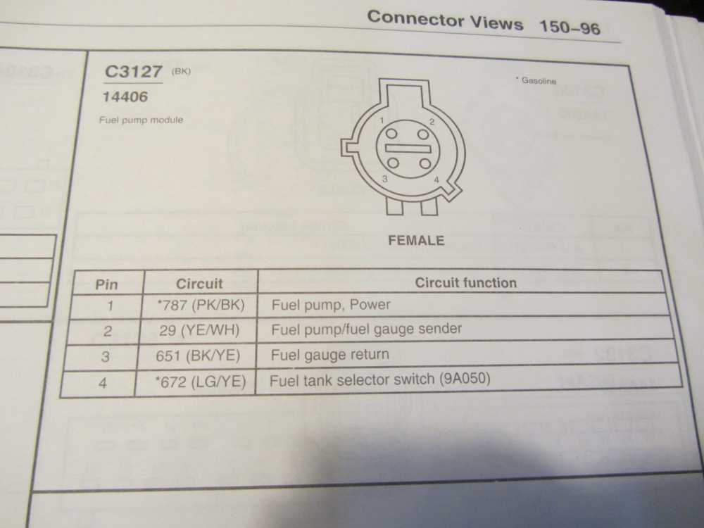

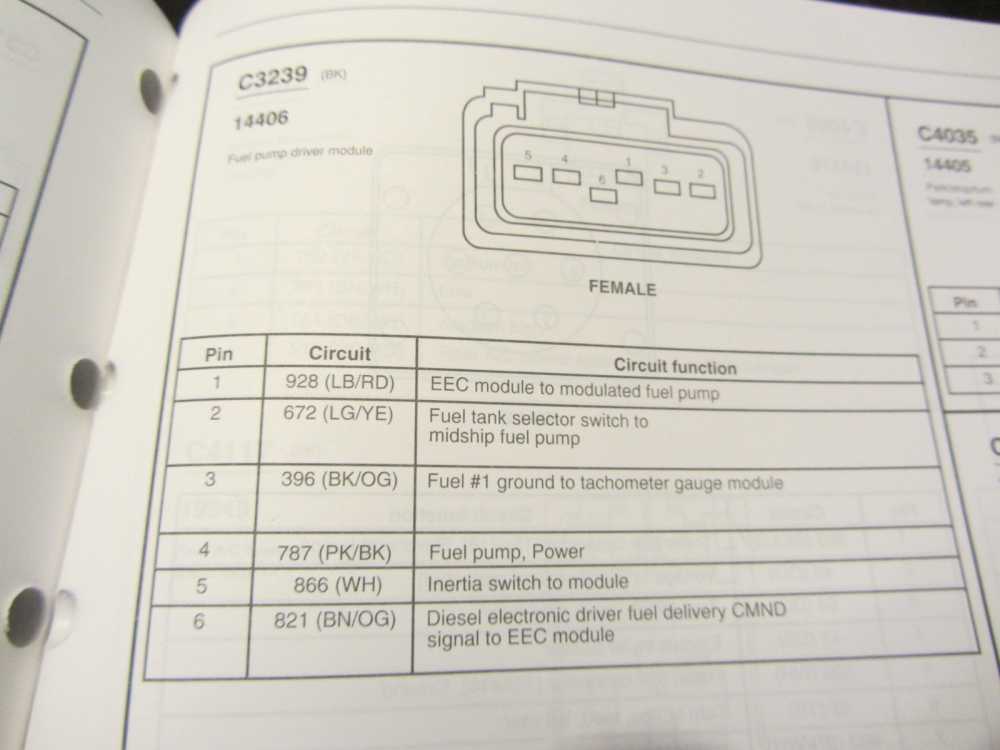

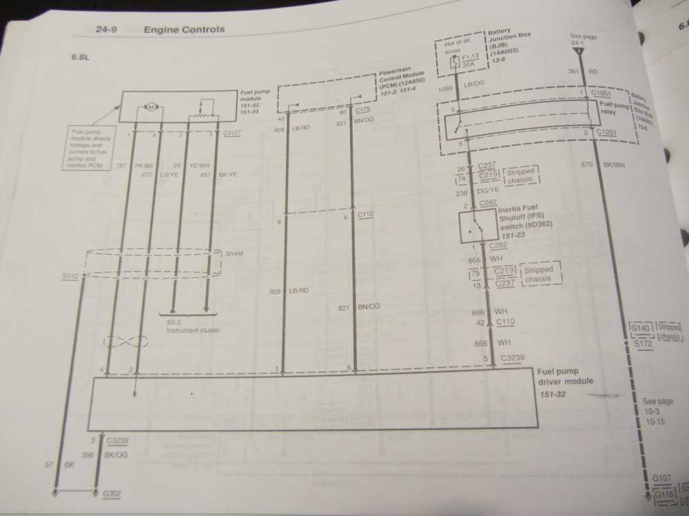

I have not performed any voltage drop tests on powers or grounds. There is a connector that is under the vehicle that is between the inertia switch and the FPDM connector. I could check voltage drop on the power wire here. I can then work my way back from there to the fuel pump wiring harness to conduct the voltage drop tests. I think I do need to take a good look at the grounds as suggested as well.
