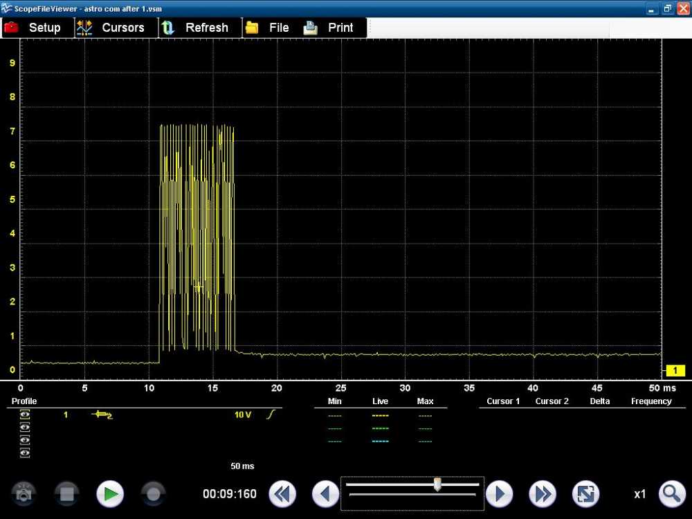

The DLC is about as basic as they come. Everyone I mention it to thinks that the inspection machine must get it's power from a different pin :pinch:
Thank goodness we know better than that.
I loaded the power and two ground with a headlamp bulb (although I arrived at the same logical conclusion as Tyler that they must be fine since my tools play fine with it), and it was super bright.
I did a half assed job scoping the data line at work, so I took the van home and did it again in the driveway just now.
KOEO, KOER (no loads & all accessory loads) 10v scale, 50ms sweep ( :lol: ) all I saw was tightly packed 0v-7v square waves with longer periods of low voltage in between signals. So, nothing remarkable, no real noise or hash. I could be wrong, but it looks about what I expected to see :unsure:
I'm working on uploading a capture. I zoomed in too much (because you can only zoom out on captured waveforms with the Verus) and ended up with a short buffer, so the best one I saved isn't great.
I wiggled and tugged the PCM connectors, and tapped the PCM with a screw driver. I tugged the DLC harness and looked for any alarm system or aftermarket garbage.
The only real work I can suggest is changing the DLC. The pin fitment seems nice, but it's the only common denominator I can see.
I just can't recreate the fault.

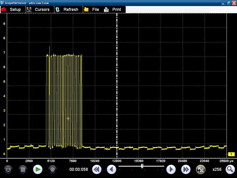

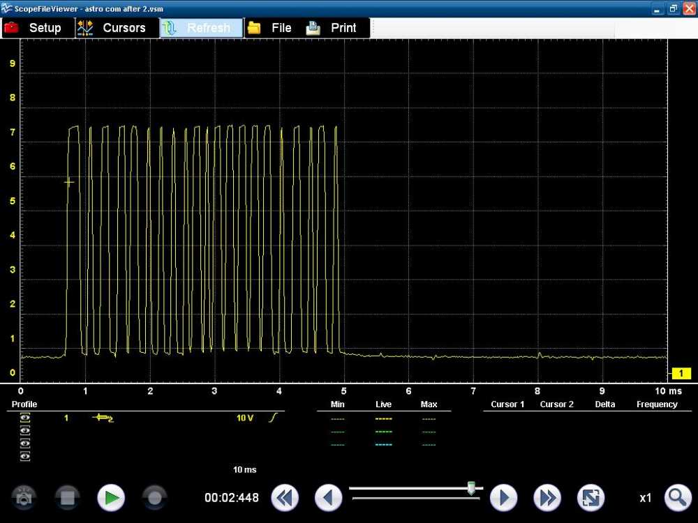

9 years 6 months ago - 9 years 6 months ago #8645 by Noah
Replied by Noah on topic 03 Chevy Astro no com
SniperDan wrote: I see you fixed it :). Think you can upload an after capture of the data communication?
Yup, got it sorted out! Thanks for your help, that's an interesting idea about conflicting configurations. Honestly, I never thought of that!
I ended up changing the DLC connector with one from the junkyard. It was about the only conclusion I could come to, and when the problem was brought to my attention by the mechanic working on it at the time, that was my first response to him. So I went with it. Maybe it's parts changing, but it was the most logical failure I could think of.
I checked the pin drag on the new (used) connector and it felt the same. I guess I need to develop a better method to gauge pin fitment ;)
(Wasn't there a thread about making a tool to check DLC pin drag? Maybe on the last forum?)
Here's the after captures. They look the same to me, but I expected that.
The first one is set up like the original capture for comparison, the second one is a little shorter time and easier to see.
I have the .VSM files if anyone want's them to view in Shop Stream.
Thanks again for the help and ideas B)
