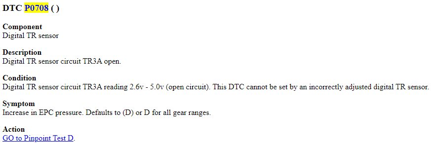

DTC P0708 ( )
Component
Digital TR sensor
Description
Digital TR sensor circuit TR3A open.
Condition
Digital TR sensor circuit TR3A reading 2.6v - 5.0v (open circuit). This DTC cannot be set by an incorrectly adjusted digital TR sensor.

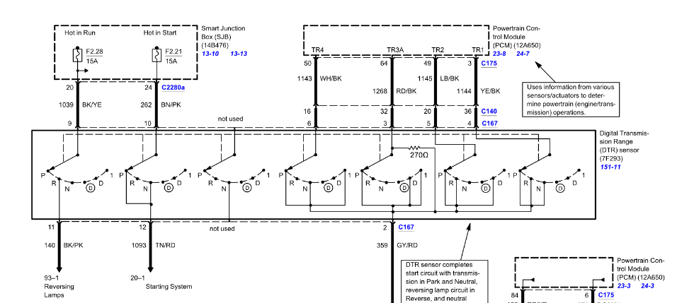

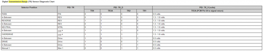

So, according to that, this code has specifically to do with the TR3A circuit. I attached the diagram. I also attached a Transmission Range sensor diagnostic chart that spells out what TR3A should read in each shifter position.
Basically, TR3A should never read more than 1.8V (or 2.6V, according to the code set criteria). I'd probably start with connecting your multimeter to the red/black wire at the range sensor, KOEO, and shift into Overdrive. Block the wheels for safety. ;) Monitor the voltage while gently wiggling the sensor connector, the harness and the sensor itself. When you can make the TR3A voltage go high, you're in the right area.
Alternately, you can have the multimeter on the windshield while you cycle the shifter between Drive and Overdrive. TR3A should consistently read zero or 1.3 - 1.8V. If you start getting erratic readings, you're likely looking at a failing range switch.

Tyler, I followed the procedure you provided. All the voltages were to spec per the diagram, about 1.6 volts, but when I put the gearshift at "1" I kept getting a reading of 6.87 volts. When I wiggled the gearshift lever, sometimes I could get it to read close to zero volts with shift lever in position "1". But then with more wiggling of the lever it would go back to 6.87 volts. Even though my son (who drives the car) never selects "1" with the lever, are we looking at a bad Trans Range Sensor? Or are there other tests i can do to confirm? Thanks! - Pop

Well isn't that interesting. :huh: If I understand the wiring diagram correctly, that adds up to a resistive contact in the switch itself.
The only other test to do is to monitor the grey/red wire under the same conditions. That's the ground for the range switch. It should read 100mV or less, regardless of what you're doing with the shifter. ;) If you get excessive voltage on that circuit while manipulating the shifter, dig deeper into a harness or PCM problem. If the voltage remains less than 100mV, stick a fork in the range switch, 'cause it's done. B)

If I'm reading the code definition correctly it's a 5V pull down circuit that is getting >5V from somewhere. Possibly leakage from the reverse light circuit inside the switch. Could try pulling F2.28 to see if the voltage goes away.
That's a good idea. B)
From what I understand, the TR3A circuit gets 5V, but all the other switches get 9V. Not sure why they thought that was a good idea...
Anyway, that could also be the source of the excessive voltage.
