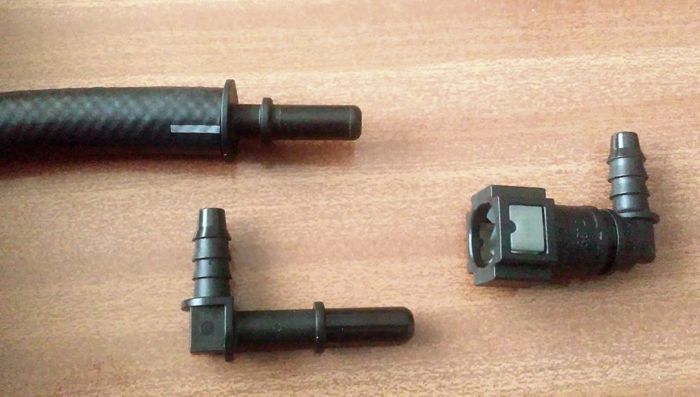

I recently bought some right angled quick release adaptors for my fuel pressure gauge so I can do most euro boxes without faffing. They are especially good for connecting at the in-tank fillter outlet on Valeo systems I would post a link but the ebay seller has disapeared.
