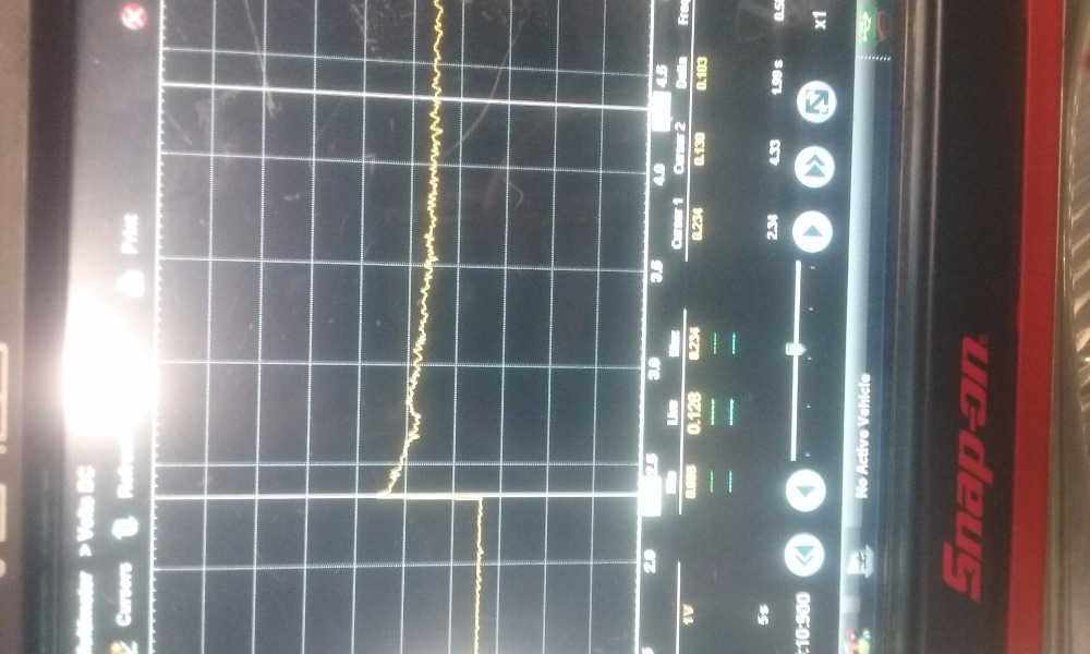

I don't think so Noah. The graphing meter of the VP will catch a 300 micro second change in a signal regardless of time base. I specifically chose the graphing meter so I could not only show the initial turn on, but also, the run time after without messing with sampling of the scope.
Does that make sense? I don't think the lap scope would have shown the spike to be higher. I may be wrong but I think 300 millionths of a second glitch capture should have been good to catch that spike.

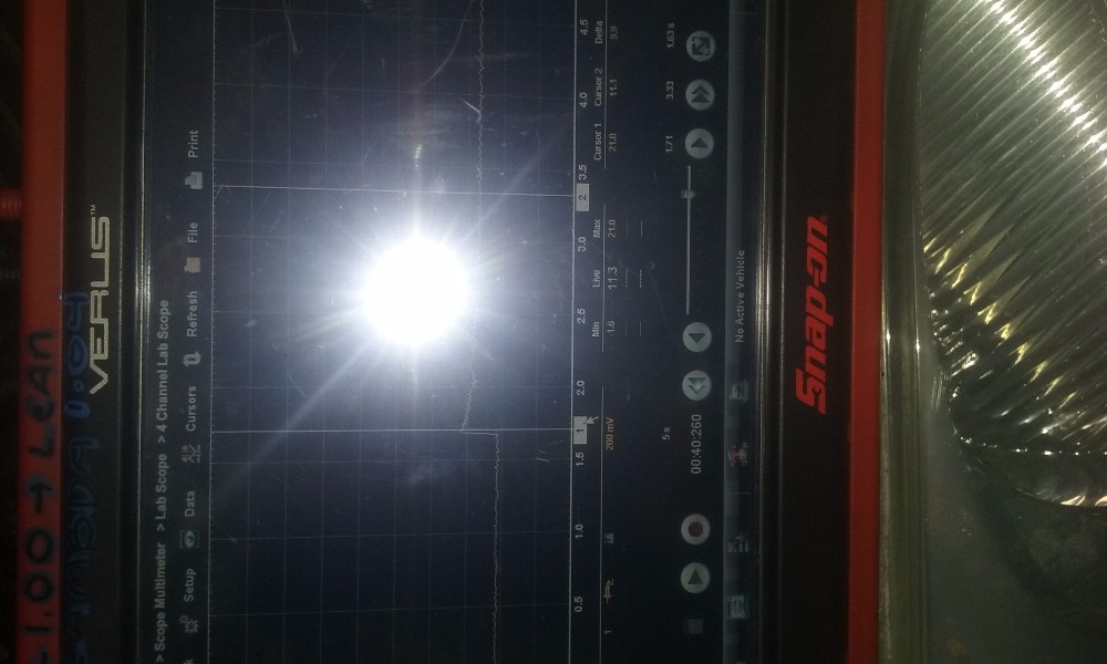

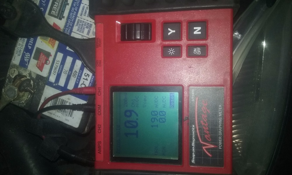

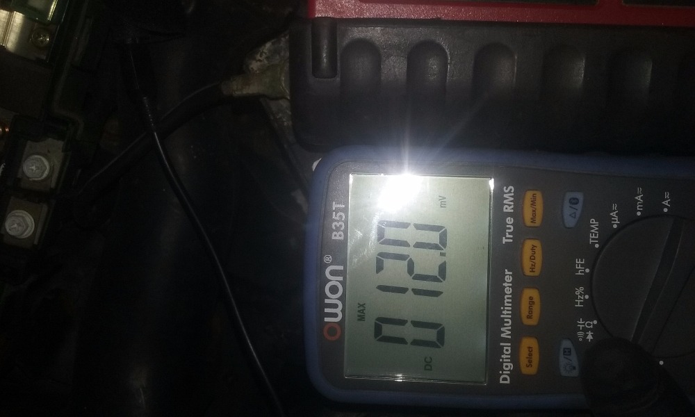

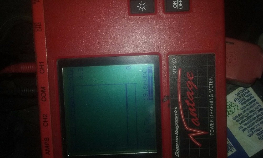

Well, it's not an electric motor, but I got to do some comparison testing today with the amp clamp and my meters.
The pics aren't great, I apologize ahead of time.
2001 Honda Civic LX.
AC compressor clutch measured at 20amp fuse in under hood fuse box.
The clutch was using around 10 amps on average.
The min max of the Vantage picked up 19 amps on turn on. nearly 20amps using the graphing function.
The min max capture of the Owon meter was less impressive, only reading 12 amps on turn on.
The lab scope picked up 21 amps at turn on (20 amp fuse circuit) and the graphing meter function picked up 23 amp at turn on.
So it seems that as far this instance is concerned, the scope and the graphing meter are on even ground as far as capturing initial turn on spikes.

Yes, it's been almost a week long fiasco of everyone at the shop swapping relays and poking at the power wire of the pump.
Original complaint was no AC. The mechanic that drew the job wanted me to make sure he was right, and it needed a pump.
The was no continuity through the clutch, but I warned him it still wasn't getting powered up.
Pump changed, no engagement (no surprise).
Three more days and 3 more guys scratching their heads.
The boss let's me use the shop after hours, so I told him it's look at it between jobs.
Blown fuse....
So I took some extra time to do some current measurements for us!
I wasn't expecting 10 amps, but it falls within the 80% usage Paul mentioned in the Jeep video.
So that's the new clutch on the replacement compressor? :huh: 'Cause man, I've never seen a clutch draw that much... I consider four amps high on most systems. It uses a 20A fuse?
