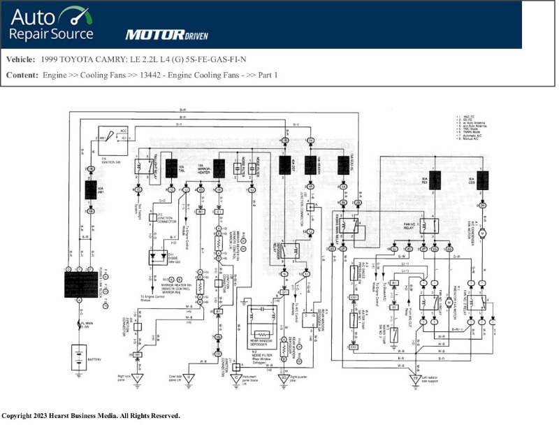

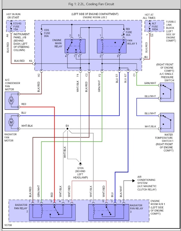

I'm having trouble trying to determine the powers and grounds of the cooling fans in the schematic attached.
Any help would be much appreciated.

Attachments are a little tough right now, I just assumed your Camry is a 4 cylinder automatic?

Yes, 2.2L 5sfe
Had to convert the pdf to jpg.
My schematic is not laid out well like yours.
