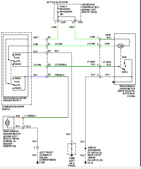

I just finished watching chapter 3 videos ,on youtube, for the second time. I took notes and made sure that I understood the principles on this chapter. I went to my car to apply what I learned the last 6 days, so I thought the rear whiper would be a good choice. it's a ground side switched circuit. so I back probed the control wire to a ground using my test light, nothing happened except the test light lit. so I took i jumper wire instead of the test light, the whiper worked for a few times and then it stopped because the fuse had just popped. can anyone explain to me what happened? why it won't work with a test light? why did it work with a jumper wire? and why did the fuse pop?

9 years 3 months ago #11021 by ScannerDanner
This is the rear wiper circuit on a diagram I have. It may not be the same as in your market. Can you take a look at it and let me know.
Don't be a parts changer!
9 years 3 months ago #11022 by Sako
I don't have a wiring diagram but this looks similar to what I have

9 years 3 months ago #11023 by ScannerDanner
Pin 1 GRN harness side GRN/BLK motor side (hot all the time)
Pin 3 LTGRN harness side GRN motor side (this is your "control" wire, not "signal" wire, "signal wires" are inputs,)
Pin 4 LT GRN/BLK both side of connector (park circuit of motor, this is a mechanical switch controlled by the motor itself)
Pin 2 BLK both sides of connector (constant ground)
The first thing is a test light is never going to have enough current flow capability to energize a DC electric motor.
Second, can you tell me on what wire on this diagram you used a jumper wire? Was the jumper wire connected to power or ground?
What position was the wiper switch in when you jumped the circuit?
9 years 3 months ago - 9 years 3 months ago #11024 by Sako
according to this diagram it must be the pin 3. (light green wire). position of the switch was off. and the wire was connected to ground

9 years 3 months ago #11025 by ScannerDanner
Sako wrote: according to this diagram it must be the pin 3. (light green wire). position of the switch was off.
Jumping pin 3 to ground with a jumper wire would absolutely NOT blow the fuse, regardless of switch position. You had to have mistakenly jumped the wrong wire. This is the dangers of using a jumper wire.

So how did this fuse blow? What happened? Did you accidentally touch another pin in that connector? Do we maybe have the wrong diagram?

9 years 3 months ago #11034 by Sako
well, here is what happened. yesterday I put the T-pin in the right pin (the light green one) and the whiper moved for a few times and then the T-pin fell of, I took it and put it in the wrong pin (the green one beside the light green pin) and this is what blew the fuse. I have just tried both pins and the wrong one blew my fuse again (did it just to make sure that this is what happened yesterday)
