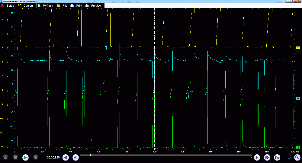

So I don't know if this subject has been beat to death or not. I know you've got a few videos already on them but I had one come by the shop and managed to get some great captures. There's a before and after screenshot. I've also included the full captures as Snapon .vsm files inside the captures.zip. Even if you don't have a Snapon product you can download their viewer program,

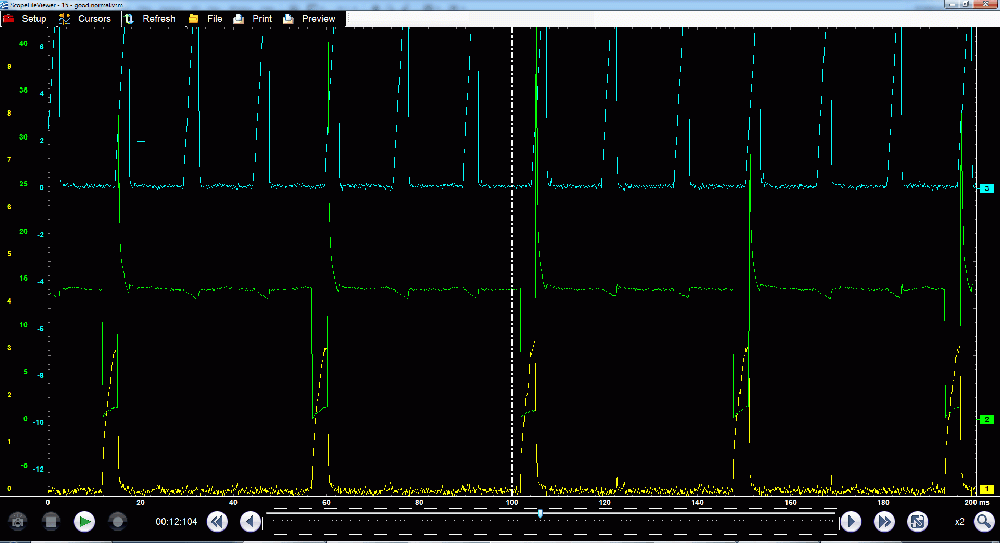

It was an 89 Pontiac 6000 with the 2.8L V6 distributorless wastespark ignition system and group fire injectors. Complaint was stalling when warm and then hard starting. The stalling was very abrupt. No stumble or hesitation. Just dead. Then it would be a cranking no start. Wait a couple minutes and it'll fire right up.
The problem was shorted fuel injectors and the fix was 6 new injectors. The bad fuel injectors ranged from 4.4 ohms to 10.6 ohms at room temperature. The spec that I found was 12-13 ohms at room temperature. The new ones were all 12.2 or 12.3 ohms.
In the before capture the car is running then stalls after a rev. After which it becomes a cranking no start. I managed to catch the moment where the injectors completely failed. You can watch the current waveforms become squarewaves and the voltage spike dropping right off. The after capture has proper ramps without initial current jumps and has much bigger voltage spikes.
Unfortunately the before and after captures were a few days apart and I goofed on the capture colors... Sorry about that
Before capture:
Yellow - 20Amp clamp on power feed to all ignition coils
Green - 20Amp clamp on power feed to bank2 injectors
Blue - Cylinder #6 injector control voltage
After capture
Yellow - 20Amp clamp on power feed to bank2 injectors
Green - Cylinder #6 injector control voltage
Blue - 20Amp clamp on power feed to all ignition coils

Well, those images didn't survive the resizing that well... Here are some fullsize images from imgur.com
shorted fuel injectors - stalling
new fuel injectors
new fuel injectors
