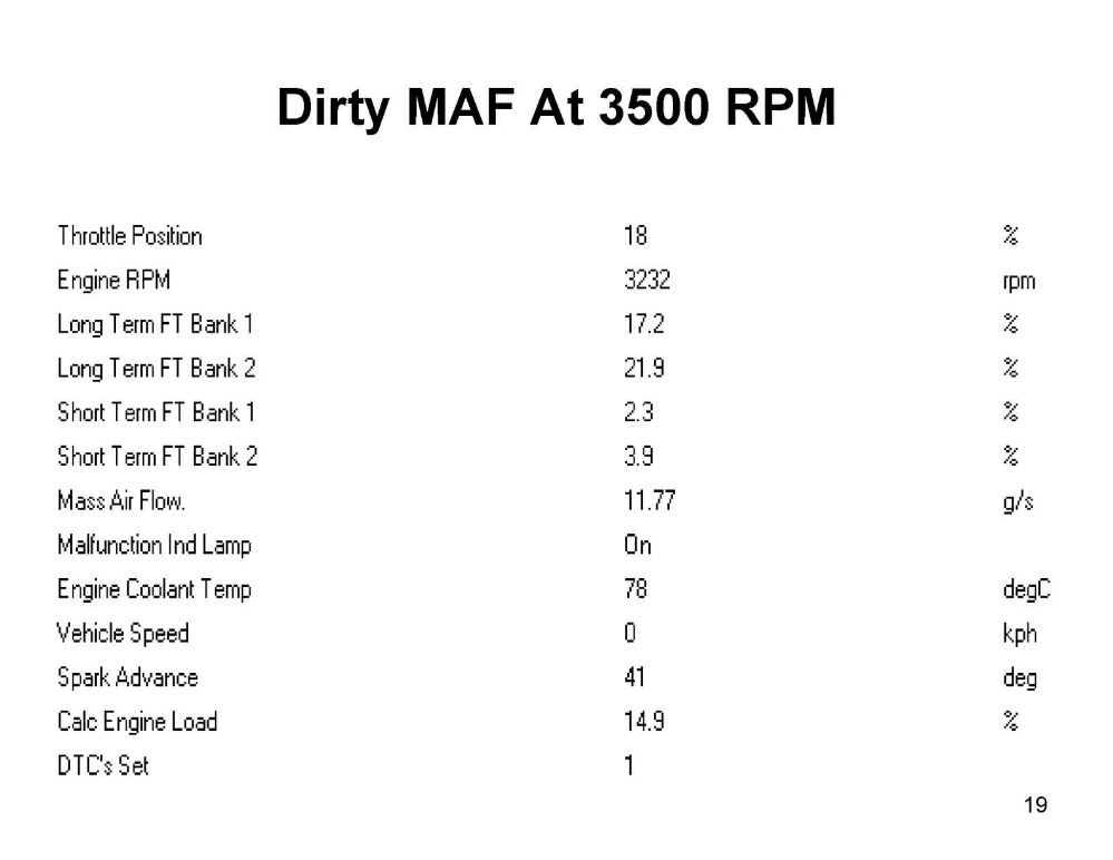

Dirty MAF as RPM increase

9 years 2 months ago #12155
Replied by Andy.MacFadyen on topic Dirty MAF as RPM increase
The total fuel trim on both banks is way above normal. Normally for each bank STF+LTF should not exceed 10%
Any relatively difference between each bank could be due to any number of issues -- such a partially choked cat on one bank or a cylinder with a low compression.

9 years 2 months ago #12211
by ScannerDanner
Don't be a parts changer!
Replied by ScannerDanner on topic Dirty MAF as RPM increase
Both banks are affected. LTFT is 17.2 on bank 1 and 21.9 on bank 2.
Remember also this is one data frame on the scan tool.
Thanks!
Thanks!
