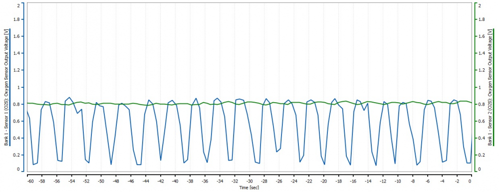

9 years 11 months ago - 9 years 11 months ago #1939 by Andy.MacFadyen
Replied by Andy.MacFadyen on topic Oxygen sensor functioning
Once you fix it you should see something like this at normal idle when the engine and cats and senors are hot and working.
