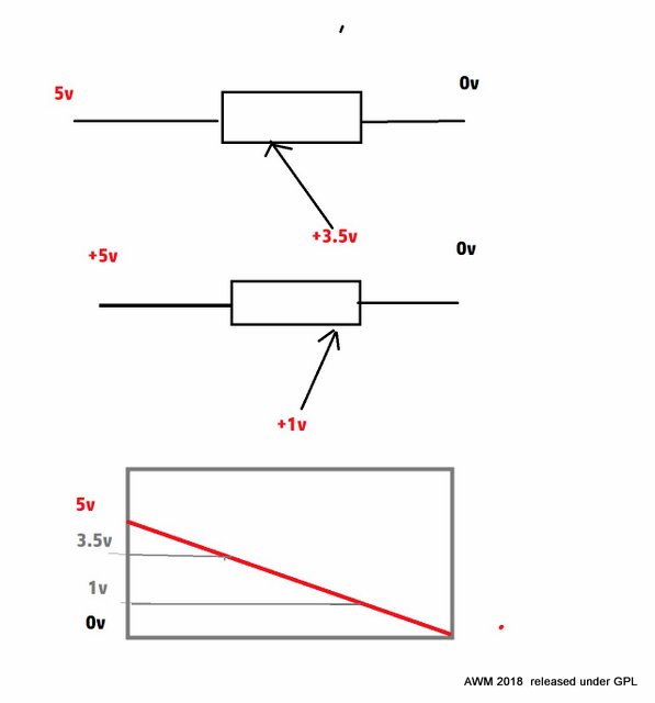

hello guys,,i have a question, where do we use 5 volt ref? in input switch ,like map,tps ? or means that we use 5 volt ref,in every input and autput,switch ,and solenoid? i dont undestud this,, help me pls,,

5v ref is a very stable voltage it is clean of any spikes a very stable voltage needed to get good accurate signals from the sensors, it can get pulled down by a shorted sensor but this is unlikely to damage the PCU.
5v is chosen for a couple of reasons, firstly it is well below the battery voltage during a cold start, secondly it fits in well with electronic computer logic voltages.
The 5v ref can be just that a reference voltage as on a TPS or refrence and power supply as on a hall effect cam sensor.

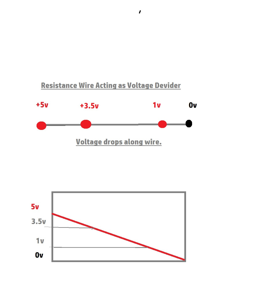

With the name "reference," is it used as a comparison? Keeping a constant voltage to reference?
8 years 7 months ago #18839
Replied by Andy.MacFadyen on topic Re:5 volt ref.
It can be both a highly accurate datum reference free of ripples and spikes and an accurately controlled supply voltage. Most automotive sensors work as voltage deviders.
Some sensors such as MAFs and 3 wire pressure sensors use the 5v ref as a power supply and reference datum.
