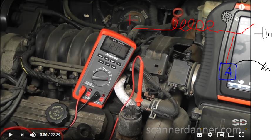

So I just finished watching one of Paul's older videos on a 95 Buick lesabre with a P1406 EGR code. He used his dmm set to amps to jump the ground side control to activate the EGR valve!! I thought this was absolutely brilliant!! This is the first time I've ever seen this. Not that I have a whole lot of experience with electrical/electronic diagnosis. My question though is that when he did this he back probed the control wire, wouldn't this be hooking your ammeter up in parallel? I was always taught that doing this will always blow the fuse in the meter. How is this possible? What other circuits can you use this on? Is there any advice or things needed to be taken into consideration when doing this? This is definitely something I want to add to my bag of tricks!
7 years 10 months ago #24158 by Chad
Replied by Chad on topic Using your ammeter as a jumper wire?!?!
Wood wrote: My question though is that when he did this he back probed the control wire, wouldn't this be hooking your ammeter up in parallel?
No. The red lead of the DMM is connected to the GROUND side of the circuit. It is reading 12 volts because the ground side switch is open.
The ammeter is in SERIES with the GROUND side of the circuit.

Ok! I think I understand what you're saying. So it would be in parallel if the driver circuit was being grounded (obviously if it was there would be no need to jumper it) but since it is essentially open from not being commanded on by the computer then your meter becomes the series connection to ground. Thank you for clearing this up for me.
7 years 10 months ago - 7 years 10 months ago #24160 by Chad
Wood wrote: So it would be in parallel if the driver circuit was being grounded
No. It would be in parallel if one lead was on the POSITIVE side of the circuit, and the other lead was on the NEGATIVE side of the circuit.
Yes. The Ground side was open. The ammeter leads Connected the GROUND side of the circuit to a GROUND.

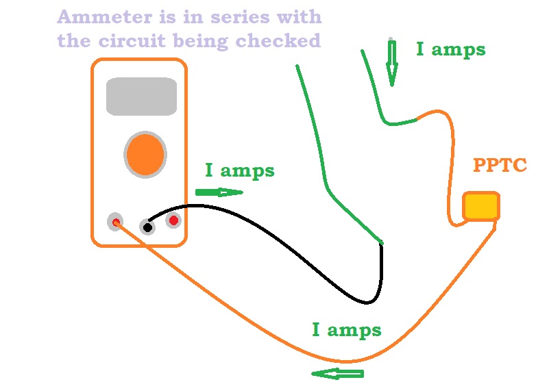

The guiding rule with using ammeters is they always connected In the circuit and Not Across the circuit, but even connected correctly the pitfall exist of the current being high enough to blow the fuse. There are a couple of work arounds to prevent the chance of the fuse blowing.
The one Paul has used in couple of videos is a self-restting solid state PPTC fuse between the meter and the circuit As most DMM are fused at 10amp choose lower value PPTC device

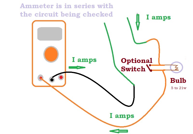

An alternative for low current circuits I was taught by my High School Physics Teacher is to use a bulb in series with the meter.
