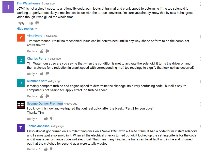

Decided to go digging in the comments on this video, found this gem:
Looking more and more like an internal trans problem :unsure:

9 years 11 months ago #3792 by ScannerDanner
Replied by ScannerDanner on topic 2005 Pontiac Vibe P0741 TCC Solenoid troubleshooti
Part 2 is now available. I'll try to contribute to this thread after you guys watch it. Thank you!

9 years 11 months ago #3854 by ScannerDanner
Thanks so much guys for the great contributions to this thread. Sorry I wasn't able to get inside of this transmission to do the air checks that I mentioned in the video. But honestly after reading #ecwurban posts, I'm kind of glad I wasn't able to :-)
For me, this case study was a win from a standpoint of understanding bias voltage on a power side switched output. I'm not sure I've been able to show it with such clarity in the past. So even though I screwed up on the call initially, I'm super happy with the outcome of this. So many lessons learned for my students on this one.
Bias voltage
Bi-directional control variables
The importance of knowing trouble code setting criteria! (when is it an electrical fault or not)- major screw up on my part here
Just because the "PCM" is one of the options for a fault, does not mean it is always electrical in nature (computer logic in this case)
