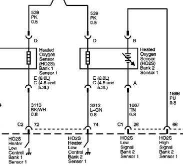

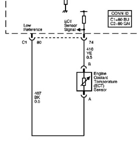

printed out a wiring diagram from Mitchell on a 2006 5.3 liter 4x4 Tahoe under engine performance and pasted all five pages togather according to wire numbers. Page 1 on one end has a picture of PCM with 80 pins and page 5 on the other end has a picture of a PCM with 80 pins and wires.
what I don't understand is that pin 74 on page 1 at PCM is a ect sig with yellow wire but page 5 at the PCM pin 74 is a lt grn wire/ho2s low control. What don't I understand?

Good question, nori! The answer is that this PCM has two 80-pin connectors, C1 and C2. I don't have access to Mitchell, but I looked this up on the BBB Industries site to be sure.
Here's the ECT sensor wiring:
Sure enough, pin 74 of C1. Note the CONN ID box in the upper right, identifying the two connectors by color.
Then there's the O2 wiring:
And there's the other pin 74, on C2. It's easy to get confused when the diagrams get this big! :lol:

nori wrote: does that mean that the PCM has 160 pins?
Total, yep. I dunno if the PCM actually uses all those pins, but they're there.
