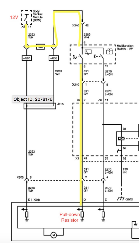

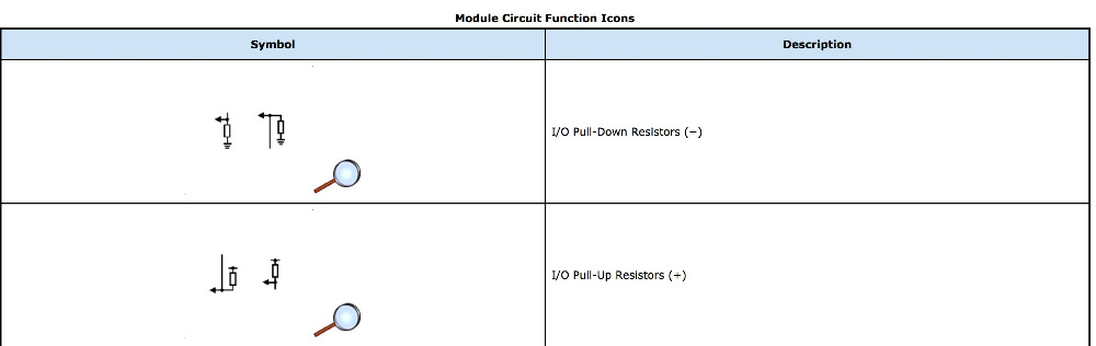

Hello, been watching a couple of videos in the premium section and noticing that pull-up and pull-down circuits are being identified wrong. Namely in this video,
switch input identification and bypass testing live example gm acadia
. Where as the circuit being discussed is actually a pull-down circuit but is continually called a pull-up circuit. The pull-up resistor is keeps signal voltage high where as without it there would be a floating signal voltage. Signal voltage is high until the switch is closed and then signal voltages goes low. I think this is where alot of people get confused because with a switch closed and then the voltage is pulled low, it is then called a pull-down circuit where that is not the case. Likewise with the pull-down resistor the signal voltage is kept low. When a switch in the circuit is open signal voltage is low and when the switch is closed signal voltage goes high which for that reason people tend to call the circuit a pull up circuit, which again is not correct. Circuits are inverse logic.
please see attachments for schematic of circuit being discussed in video.
Would love to see Paul respond and have a discussion about this.

In all seriousness and with all due respect, it sounds counterintuitive and directly contradicts what is being taught here, so I'm sure you must have expected it to not be a popular position.
But, in the interest of keeping an open mind and expanding my own knowledge, I'll spend some time on the Google machine.
Is there another source you could post as reference?
EDIT:
I think I see both sides of the coin now.
In the example you provided,(and, to your credit, many others), emphasis is on the state of the resistor. I assume that is how the engineering side of the world would quantify the internal construction of the PCM.
For troubleshooting purposes, we've been defining pull up and pull down switch inputs by the state of the switch.
Paul (Scanner Danner) is not alone in this description.
www.google.com/amp/s/autosystempro.com/switch-inputs/amp/
It is an interesting point, thank you for bringing it to the attention of the community!

Not sure I'm following exactly what the disagreement is and I didn't watch the video...
That was a pull-down resistor. There is more than one type of digital logic that could be used, but at the end of the day the input will "float" if it is not pulled down when the input is open. When the input is closed, the pull-down resistor selection will have little effect on the input voltage.
Its not about the resistor, its about giving the logic (op amp, etc.) a specific state so that it doesn't float all over the place.
PCM (etc.) internal schematics are ALWAYS grossly simplified. Unfortunately, wrong as well at times.

I am not sure how it was taught, but within the electronics world, there aren't multiple choices. One is correct and the other is not
To diagnose vehicle faults, one typically only needs to understand the function. But to understand circuit operation at any depth, one needs more than that.
I have seen a number of instructors point to voltage divider sensor circuits (ex 3-wire sensor) as pull-up or pull-down circuits. They are neither. However... on the signal wire it is common to have a pull-up or pull-down function.
In those cases, the input is being sampled by digital logic circuits that must have something to work with otherwise the input will float.
I'm purposefully using the vague term "digital logic" because logic circuits can be created multiple ways.
OEs vary a great deal in their training, but I remember GM training bringing attention to this in their 1994 OBD2 training material. Technicians were making incorrect assumptions of testing PCM driver and sensor circuits based on what they had learned to do with older technology.
