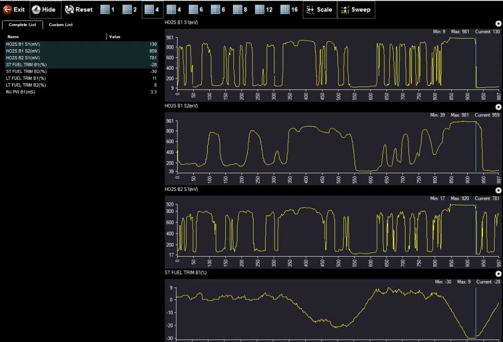

I have been playing around with the oxygen storage test that you show in section 5-13 of the book. I am using a Solus Ultra with 16.4 software is there any way to get the actual time based on the frame rate. I hope this is not a confusing question.

The answer is "sort of " but not with any great accuracy, you would need to find the rate at which the data frames are being read even then it will always be + or - one frame at best. Your graphs are pretty much typical of working cats on most cars I see ie. not new car text book but good enough.
To improve the chances of getting the best possible result you could improve the frame rate minimising the number of PIDs you are reading ie. look at only one pre-cat and its' paired post cat sensor at the same time.
Usually if the cat is working and it has a usable level of reserve oxygen storage capacity it will be fairly obvious. With a non-working cat the post cat sensor will follow the upstream sensor hi-low-hi-low very closely. If the cat oxygen storage capacity is non-existant or marginal when forced rich to lean the post cat sensor will drop rich to lean with zero to less than a second after the pre-cat.

Thanks this car has a lot of miles but no cat codes it is my car and thought I would look at it for comparison.

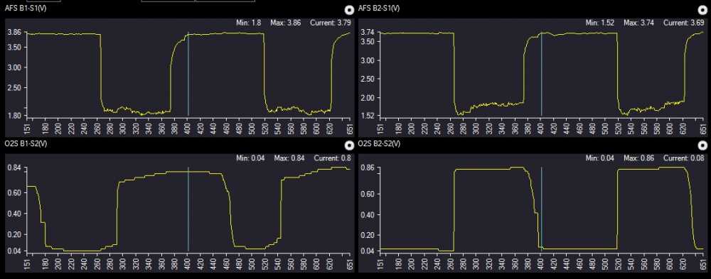

I just happened to look at an '06 Tacoma with a P0430 recently, here's what the sensors looked like while jamming the mixture rich and lean:
That bank two cat isn't storing anything. :lol:

Tyler wrote: Those cats are looking good to me. B)
You must have a giant waveform library Tyler, cool :) The upstream here is an A/F sensor right. Just mentioning for those following along.

Dylan wrote: You must have a giant waveform library Tyler, cool :) The upstream here is an A/F sensor right. Just mentioning for those following along.
Yep, upstream A/F sensors, good point.

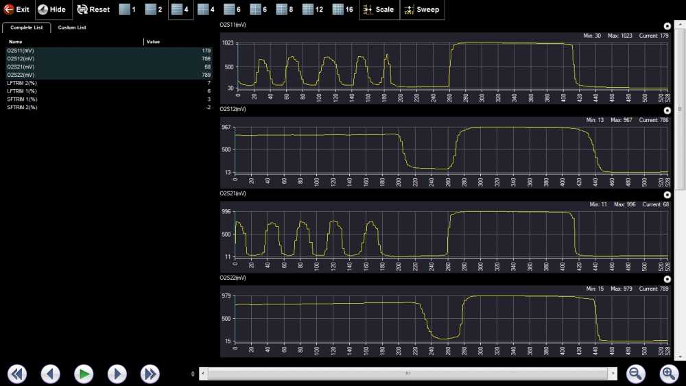

Had a 03 Chevy Blazer 4.3 in with cat code P0420 the main cat has a rattle like the brick has came loose. When I look at the cat cats I can see oxygen storage but it must not be enough have checked 02 sensors and no exhaust leaks fuel trims look good
9 years 8 months ago #6134 by Andy.MacFadyen
Replied by Andy.MacFadyen on topic Cat Oxygen storage test
P0420 works mainly on comparing the crossing counts of B1S1 and B1S2 immediately after intial warm up. The PCM counts every time the voltage signal from the oxygen sensors pass through 0.5v. If the count for B1S2 is following too close to that for B1S1 it flags a P0420. If the output from downstream oxygen sensor is following the hi-lo-hil-lo pattern of the upstream to closely it is a sure sign the cat isn't working for some reason.
In your case rattle test shows your cat is probably rubble, if you tested it with a back pressure gauge it would probable fail. If replacing it would be wise to check that chunks of rubble haven't made their way down towards the muffler.
