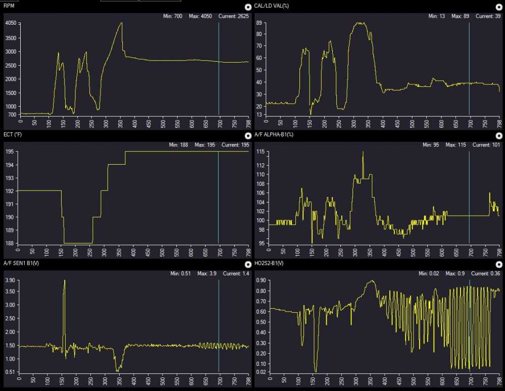

What you read about the ECM still pulsing the mixture rich/lean with air/fuel ratio sensors is absolutely true. And it IS detectable, just not easily. On my Snap-On Modis Ultra, I have to change the scan data scales to 'zoom in' on the sensor signal, and allow the idle to stabilize so the mixture doesn't change dramatically. This is why you'll observe frequent downstream switching on a system with a failed catalyst. I'm trying to find an older capture I had of this off an Acura... :blush: I dig this up and post it.
Another way manufacturers will look for catalyst efficiency is active (maybe 'invasive' is a better word) testing. This is where the PCM will go into open loop and purposefully jam the mixture rich and lean rapidly, looking for the downstream to react. Here's an example from an '05 Nissan Altima with a P0420. The test starts just after frame 600:
When the PCM sees results like this, it knows with confidence that the cat is dead.
Don't forget about downstream fuel control, either. This is now a very popular method for improving catalyst performance across a wider range of driving conditions.

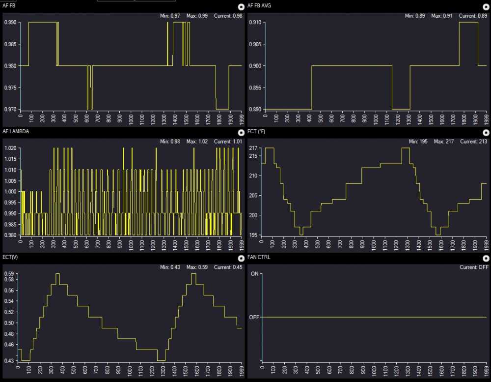

9 years 8 months ago - 9 years 8 months ago #6365 by Tyler
Replied by Tyler on topic Rich Lean switching for cat operation
Noah wrote: That answers my question! Thank you sir.
No problem! I did more digging, couldn't find the Acura capture I was looking for, but I did find this off an '04 Honda Element. I was trying to get it to overheat at idle, but I was watching the air/fuel ratio sensor at the same time. You can see the AF LAMBDA moving around in small increments.

  • Reventon
  • Reventon's Avatar Topic Author
9 years 8 months ago #6371 by Reventon
Replied by Reventon on topic Rich Lean switching for cat operation
The plot you have shown explains it all. Thank you
