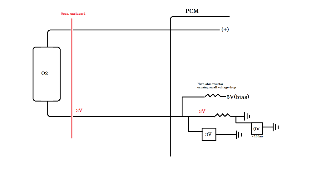

by Cameron76
Bias on ground wire: o2 sensor was created by Cameron76
I am confused how there can be a bias voltage on a ground wire. It seems it would just get pulled to ground all the time. The only way that I can see it is if there was a transistor on the ground wire that would allow/block current flow like on an output with a bias. See picture.

I understand voltage being on the ground wire in a floating ground situation. But if you unplug the sensor and there is still a bias on the ground, it could not be from a floating ground. And Paul Danner said that sometimes there is a bias ONLY on the ground wire. This is the situation that confuses me.

Yes. The dc voltage elevates the ac voltage. The ac "rides" on top of dc voltage that is produced by the sensor. But to have voltage on a ground wire UNPLUGGED would require a positive voltage coming from the computer on the ground wire. Unplugged implies that voltage from the computer on the (+) wire could not be on the ground wire. It also implies that there would be no sensor voltage because it is unplugged. So how can there be a positive bias voltage on the ground wire unplugged?

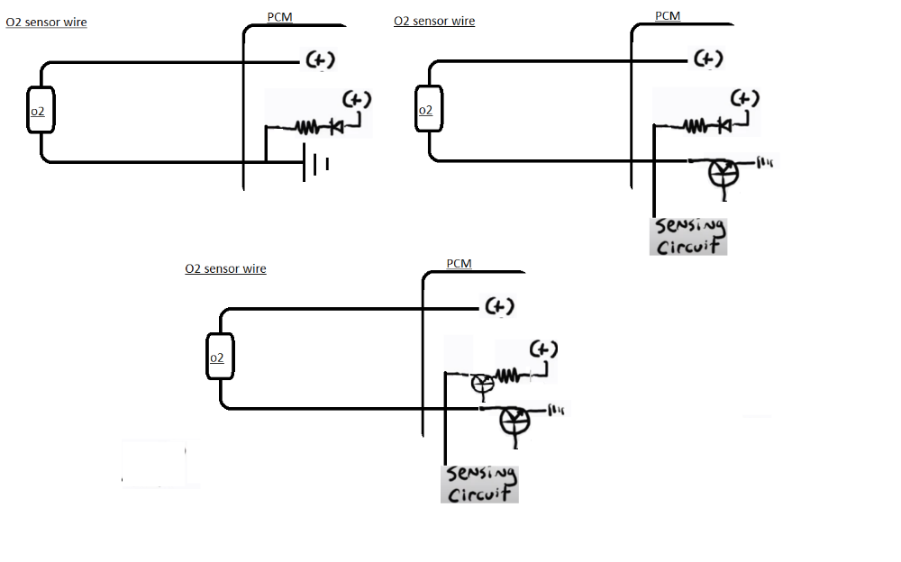

- Cameron76
- Posts: 16
5 years 7 months ago - 5 years 7 months ago #47858
by Cameron76
Replied by Cameron76 on topic Bias on ground wire: o2 sensor
Last edit: 5 years 7 months ago by Cameron76.
