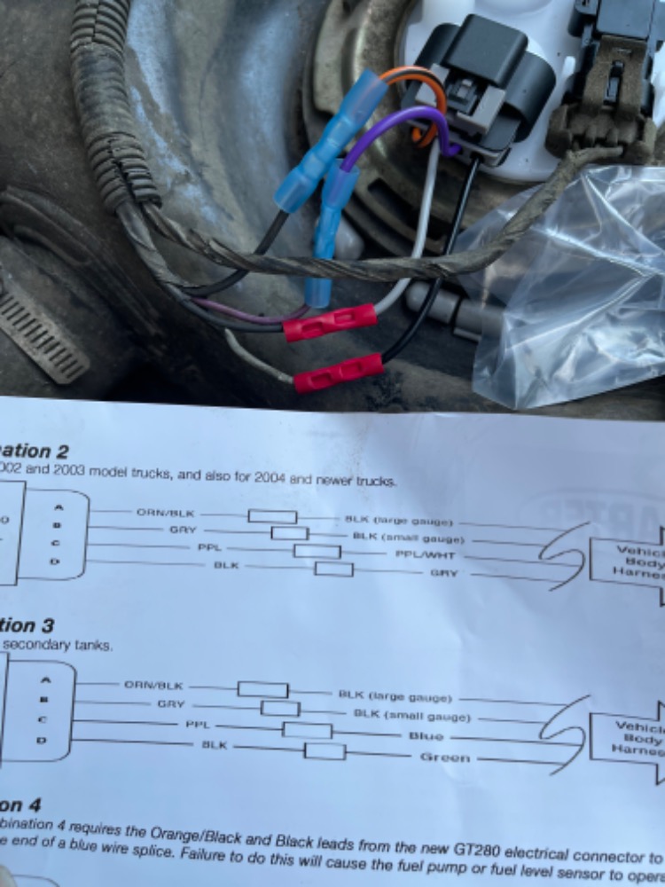

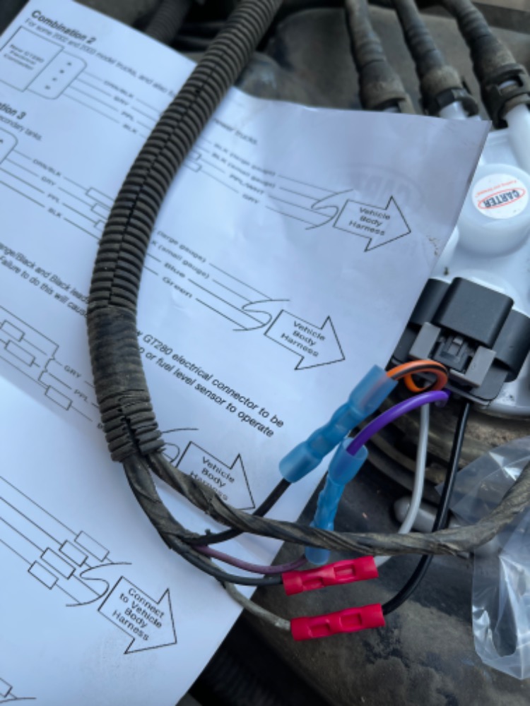

It is important to research your wiring diagrams and pay attention to the size wires you are connecting…. Brand-new Aftermarket fuel pumps for GM where you have to change the plug will sometimes give you the wrong directions..
