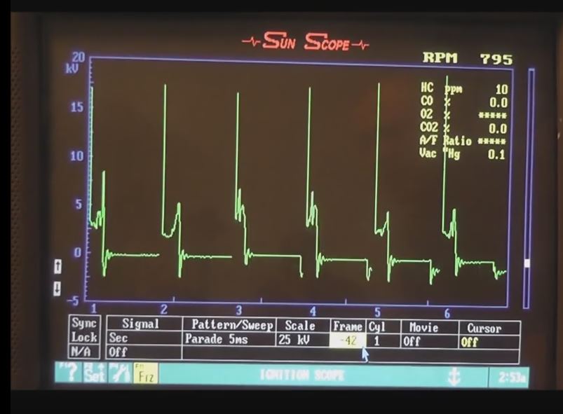

Yes it will show what we call a spark parade, but how much detail it will show I am not sure.
You can do it by simply clipping the supplied DIS HT probe to the HT lead from the coil to the distributer but that won't synch to the firing order. To get the capture synched to the firing order without buying another DIS probe you would need to connect the DIS probe to #1 cylinder and set that as a trigger and another channel to the ignition primary through a 20:1 attenuator.
With the Hantek 1008 the processing power is shared between channels so the more channels you use the less detail you get, I haven't got a capture of a spark parade from a DIS system using the Hantek 1008 but I posted one in another forum for a Rover K 1.8 shared plug top coil system showing ignition pimary current ramp and the secondary voltage and it shows the Hantek's limitations. For your B you would only need half the length of screen of that capture to show one complete 4 cylinder capture ie 2 revolutions of the crankshaft so you would get more detail.
As an former MG owner (ZB, TF1250 and chrome bumper B ) I have spent many hours fiddling with twin sU carbs and worn out Lucas distributers. I would be really interested in in any capures you get.
The sparks on this caputure are reversed polarity so the spark looks odd because it is inverted.

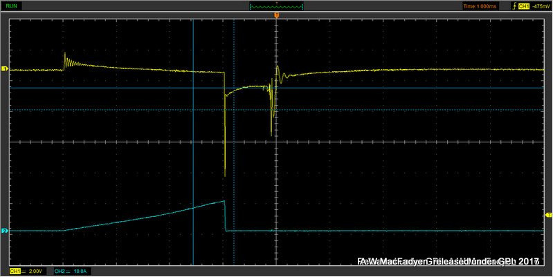

You might also want to consider getting a current clamp as this can give you a very quick and easy way of checking not only the coil but just about every other electrical item on any car.

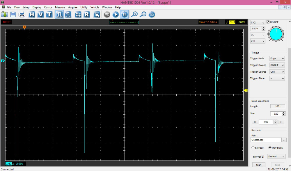

8 years 9 months ago - 8 years 9 months ago #11873 by Andy.MacFadyen
Replied by Andy.MacFadyen on topic Will the Hantek 1008C show 4 spark traces at once?
Okay decent capture --- it is upside down because of the coil primary (12v) polarity I don't know your ignition system but this may or may not be correct for your ignition system modern coils terminnals are marked + and - normally the control (what used to be the contact breaker ) connection is - .
On most oscilloscope scopes you can flip the display over to make inverted patterns easier to under stand -- but not the Hantek 1008
With a ignition parade pattern you look for a cylinder that dosen't fit in with the rest ---- look at the forrest not the trees, in this case one of the cylinders has lower voltage than the other three. This sugest a spark leaking to ground or a bad or fouled plug or the the spark plug gap closed up or low compression there isn't enough detail in the capture to make an informed guess as to which.
What you need to do now is look at the cylinder on it own ---- first capture a good cylinder in closer detail then capture the suspect cylinder with the same the settings.
Last edit: 8 years 9 months ago by Andy.MacFadyen.

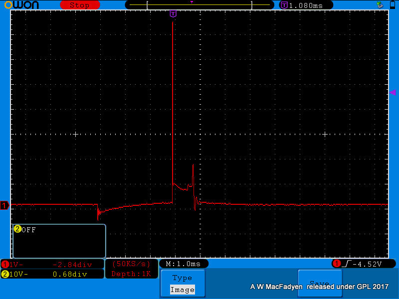

8 years 9 months ago - 8 years 9 months ago #11878 by Andy.MacFadyen

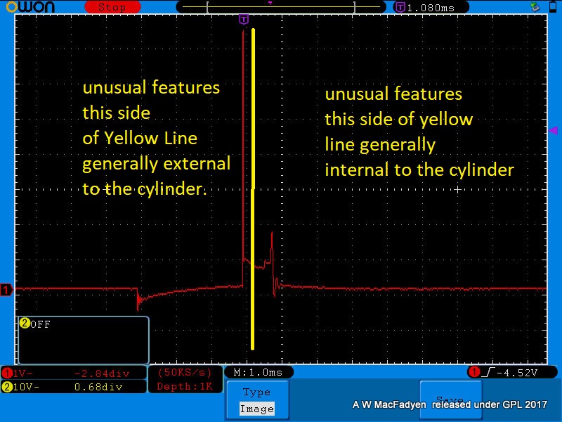

You have got a really useful caputre ---- I download the image and looked at it zoomed in --- it really looks like a spark jump to ground -- distributor cap, plug lead or plug I could only guess at. One other thing I noticed is on the good cylinders the secondary (HT) has a lot of energy left over at the end of the spark --- what spark plug gap are you running ? standard 0.025" (0.625mm) it could be you could open the gap up more.

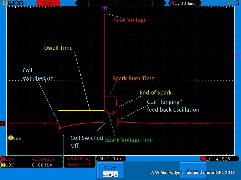

This picture is the classic "good" spark at normal idle
This is explains some of the features

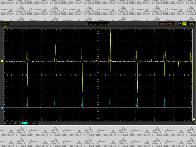

8 years 9 months ago - 8 years 9 months ago #11879 by Andy.MacFadyen

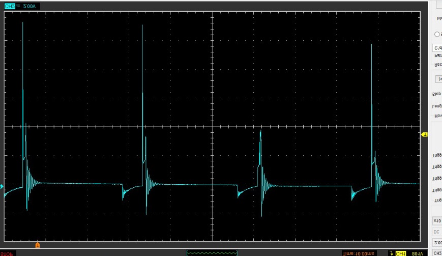

This is the inverted spark actually from a more recent MG a modern TF 135
Inverted polarity sparks can be difficut to get your head round but after a while it becomes easier.
8 years 9 months ago #11880 by Andy.MacFadyen
This is your capture flipped using good old MS Paint

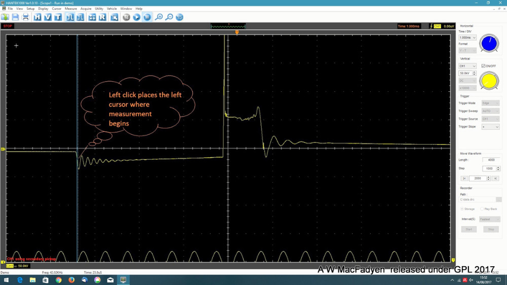

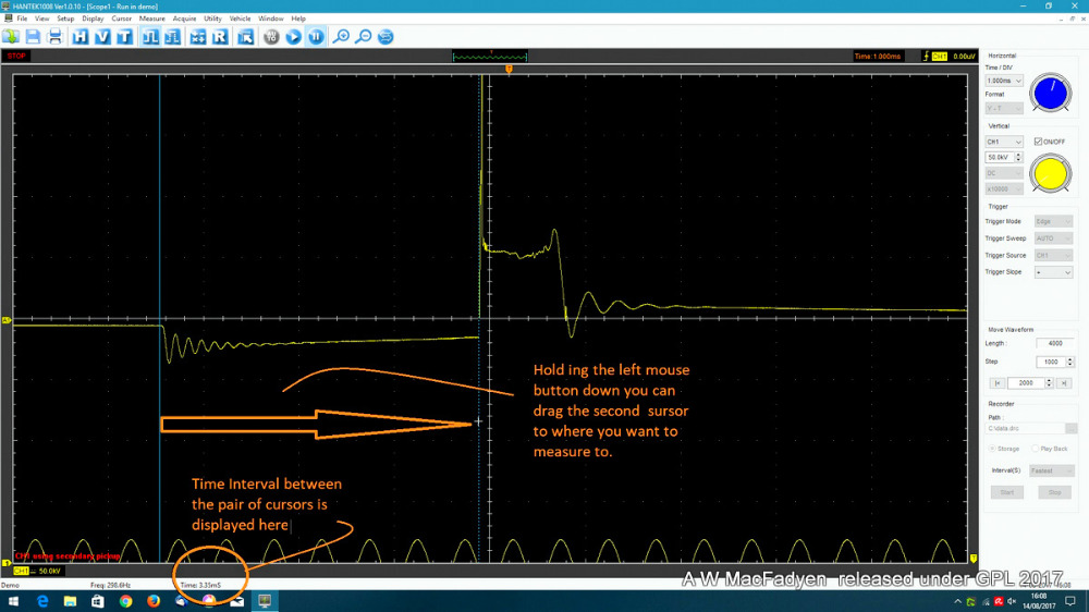

8 years 9 months ago #11949 by Andy.MacFadyen
It should work Okay on windows 8 Hantek software version 1.0.8 works okay on 8 and 10 but won't flip the display.

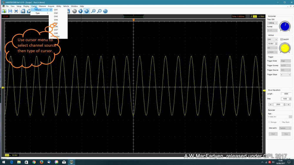

The way to measure Time periods and Voltage differences is to use the cursors This shows how to measure the dwell time, most oscilloscope cursors work in a similar way so if you learn it o the Hantek it will be the same if you ever decide to upgrade.
