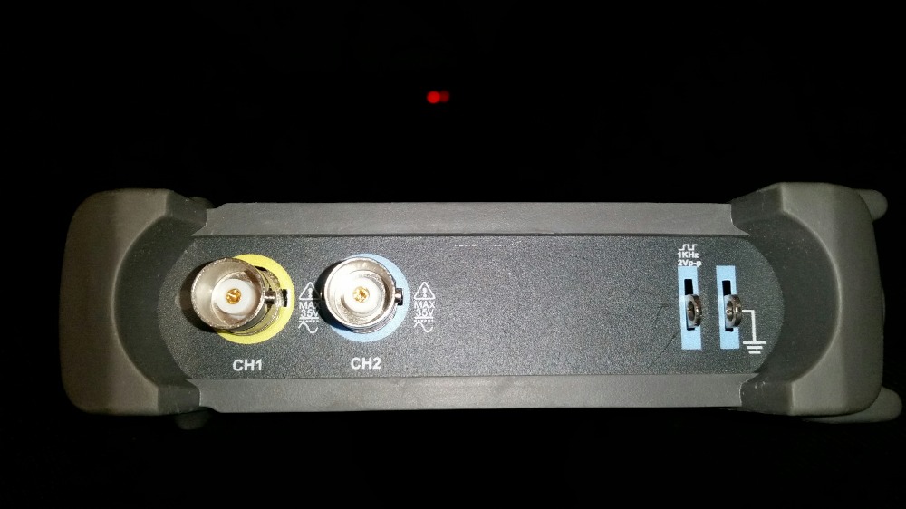

8 years 10 months ago - 6 years 9 months ago #14178 by 1971rscamaro
Replied by 1971rscamaro on topic Will the Hantek 1008C show 4 spark traces at once?
I have the 6022be scope. By the BNC jacks on the scope it says 35 volts ac/dc max.

6 years 9 months ago #35417 by 1971rscamaro
By the bnc connectors on my Hantek 6022BE is labled max input 35 volts.

6 years 7 months ago #37027 by Andy.MacFadyen
Replied by Andy.MacFadyen on topic Will the Hantek 1008C show 4 spark traces at once?
1971rscamaro wrote: By the bnc connectors on my Hantek 6022BE is labled max input 35 volts.
With normal non-automotive labscopes when looking at injector or coil primary wave forms using an attenuator is needed to be sure you don't spike the input circuits of the scope. This especially true with common rail diesel injectors.
