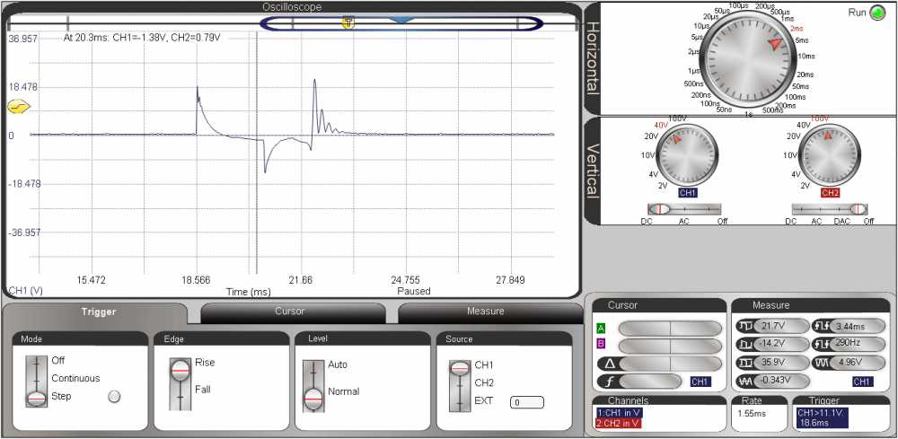

I have this Hantek Secondary ignition probe , the thing is I can not read the waveform , I don't even know if it's working correctly. Can anyone help me understand the waveform or tell me if it is possible to get more info than if I have spark or no , that i can check with a normal spark tester . I would like to be able to use it to have a little more info with it . Thanks !!
10 years 2 months ago - 10 years 2 months ago #1434 by Andy.MacFadyen
Replied by Andy.MacFadyen on topic Secondary ignition waveform
First of all the trace is inverted from what you would normally see in illustrated examples, the inverted trace is from a reversed polarity (ie negative) spark which is typical of a one half of a wasted spark system. Wasted spark systems spark each spark plug once per revolution of the crankshaft. For every two sparks one of the sparks is wasted as it occurs at the end of the exhaust stroke. when the pressure in the cylinder is lower.
On a wasted spark system cylinders are paired as "companion cylinders" one cylinder getting a negative spark the other a conventional positive spark. If you put the probe on the companion cylinder to the one you hooked up to you will see a a wave form which is the right way up.
Also from the low spark voltage in your waveform it would appear it is actually a wasted spark which is of little use for diagnostics. Capturing a proper "useful" working spark is really a matter of setting the trigger level to capture only the higher voltage sparks. On the negatively fired plug lead on a wasted spark system all this is of couse turned upside down and the trigger level required is a high negative voltage.
If your scope has an option to invert the trace it will make this type of primary wave form much easier to understand.

Thanks Andy! Great pictures you got! So whats wrong with mine?? Do I need a better scope or another probe? to get a better quality image , I know the ones you got are way more useful than what I got.

The first thing I would try is moving your trigger point down below 0v volts I would try a -20v trigger set to "Fall", then try going even lower.
Ignition primary (and secondary) voltage waveforms should really be taken at the beginning of a throttle snap as this when the ignition is stressed most.
I don't see any controls on your scope to invert te waveform which is a pain but I have a couple inverted wave forms from different scopes.

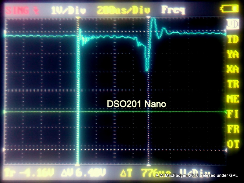

Same family of engine this one was taken on a DSO201 Nano V3 running Ben-F firmware.
[img]http://locostbuilders.co.uk/upload/2016 - 1.jpg[/img]
Both the Hantek and DSO210 give surprisingly good results for very cheap hardware

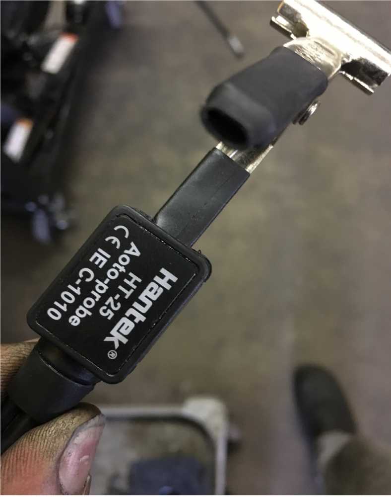

The Hantek DIS probe has a built in protection for the scope so there should be no need for an attenuator. However the quality of these probes s pretty variable I suaspect some sold are not made by Hantek but are clones, so it is more than possiblIe you have a duff probe.
I have a busy day ahead but if I get time I will measure the resisstance of mine.

Would like to know if utilizing COP probes like pico pp357 or hantek ht25 need an attenuator conected to the scope?. (This probes are the ones that have a handle with an a paddle in the end to rest on the coil)

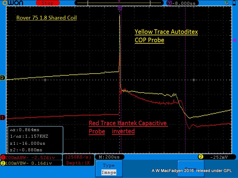

I had a half hour to spare so took a couple of caputures on my daily runner using using my Hantek capacitive probe and my Autoditex COP probe simultaneously on the same cylinders

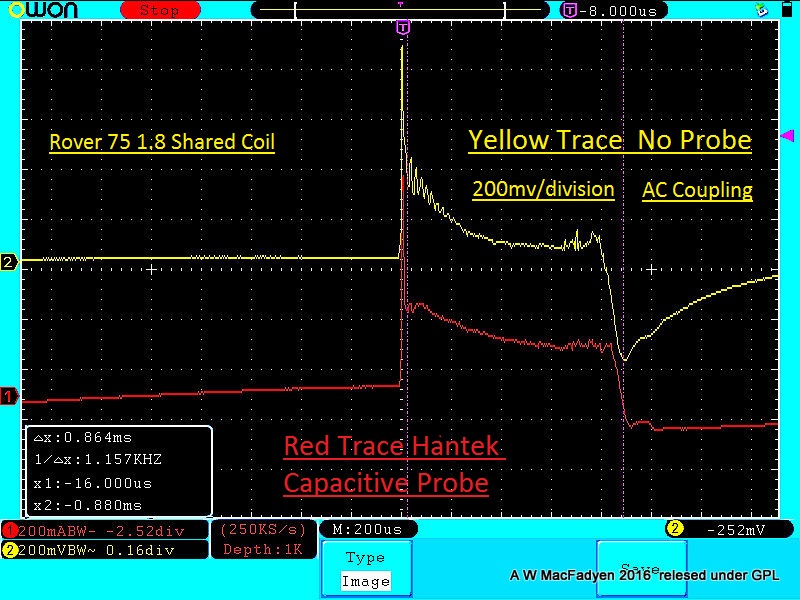

I got a couple of good captures. One of which turned up something unexpected.
10 years 1 month ago - 10 years 1 month ago #2202 by Andy.MacFadyen
Good capture (normal idle)
Red Trace Channel 1 Hantek Capcitive Plug Lead Probe --- inverted by scope.
Yellow Trace Channel 2 Autoditex COP Probe
Last edit: 10 years 1 month ago by Andy.MacFadyen.
10 years 1 month ago #2204 by Andy.MacFadyen
Red Trace Channel 1 Hantek Capacitive Probe 200mv/div
Yellow Trace Channel 2 --- No Probe No Physical Connection ! 200mv/div :dry: :unsure: ?????
10 years 1 month ago - 10 years 1 month ago #2206 by Andy.MacFadyen
The method used to do the capture was to use a basic crocodile clip lead. Scope ground connected to a block ground, scope positive is gripped in one hand while the palm of the other hand is simply held about 2 to 6 inches above the coil.
I have since tried it with DSO201 Nano and it also works nicely with that. ;)
