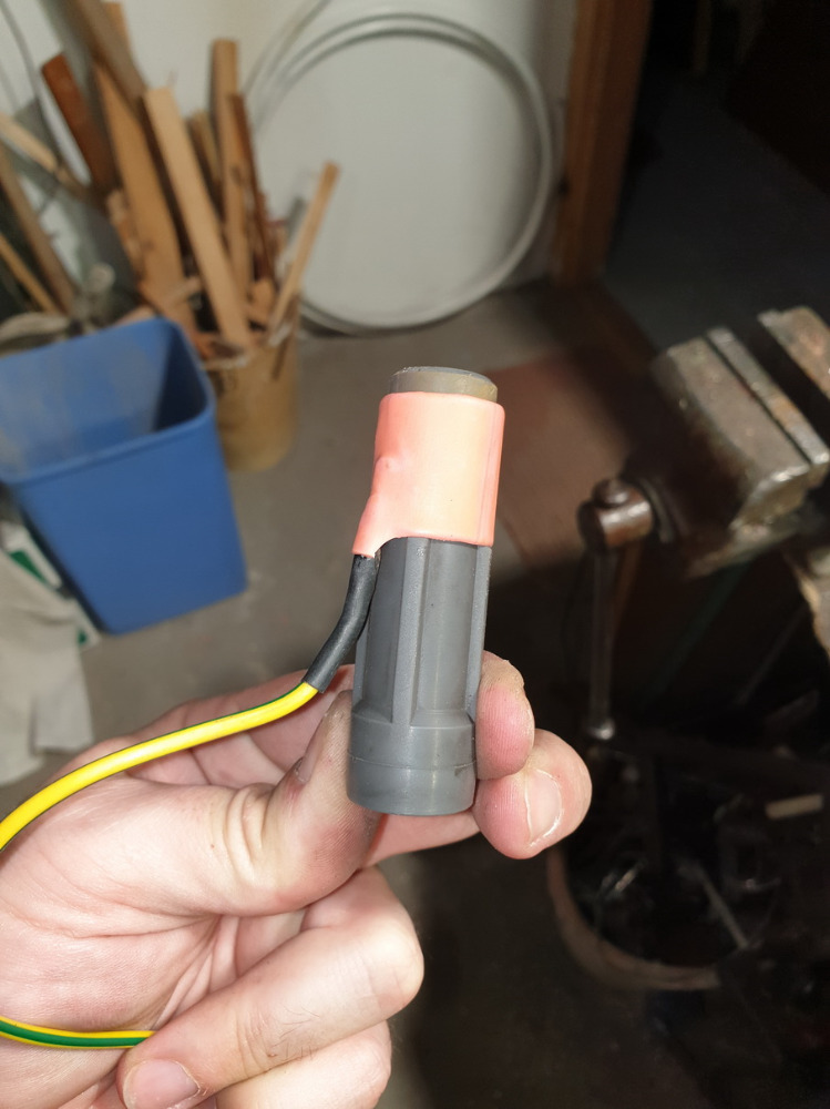

This is quite an old thread and post, but thought to give you some info on my experiments which were influenced by this thread.

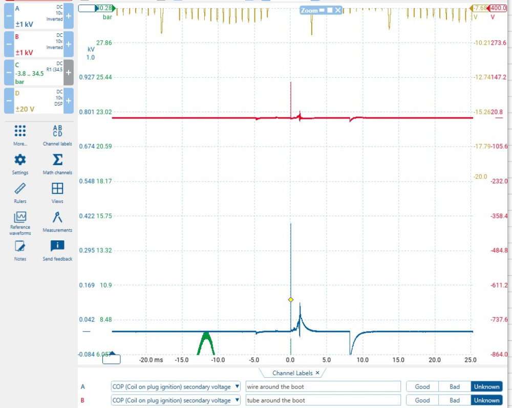

So, tried the wire loop but not the same way as the guy on the video. Actually I tried that exactly first, but the result wasn't too good. The way it was working nicely is that I had no ground connection and I did not use the capacitive pickup, but simply used a 10x probe connected to the wire that had the loop on the other end.
The red trace on the following picture is the result.
The method I found the most usable is pretty much a a combination of the capacitive clamp pickup and the wire loop.

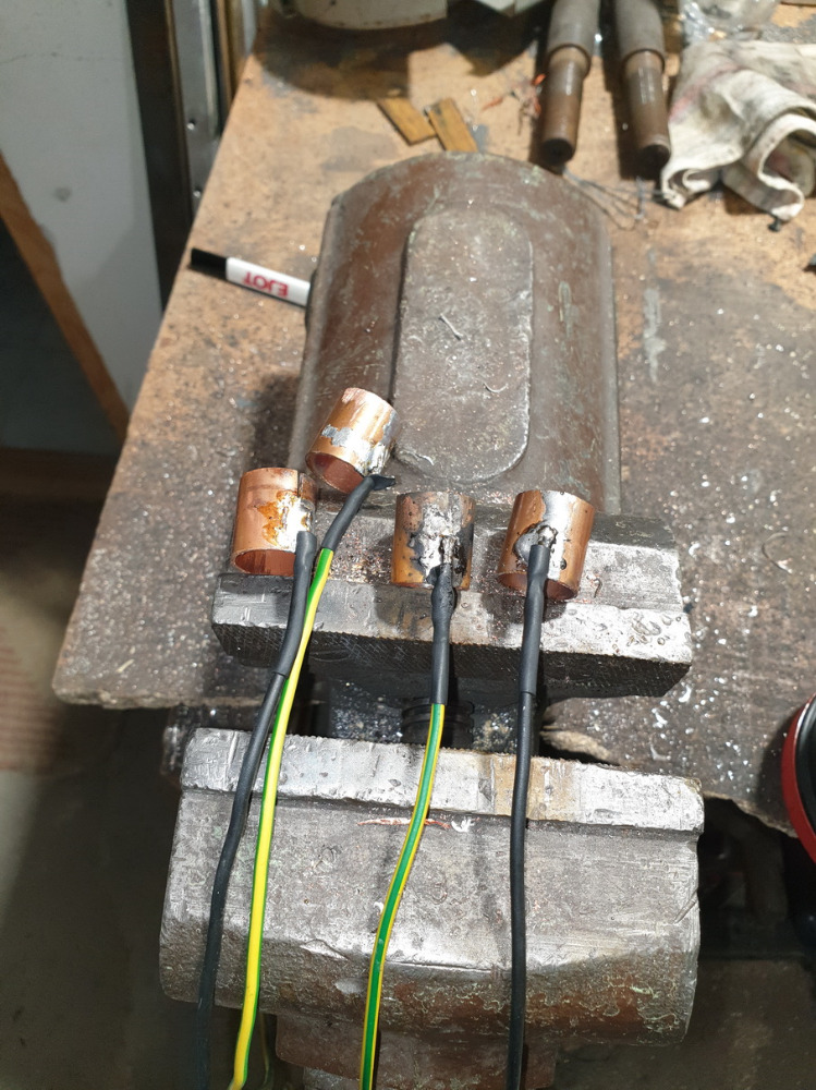

So I took a copper tube that is similar in diameter to the O.D. of the sparkplug boot (make sure it is not a tight fit as the spark plug will expand the boot a bit so you might experience some difficulties to install the COP colis this way. Rather make sure the tube is a loose fit to the boot when it is out.) Soldered a wire on to it, and put heatsrink on top of all that.

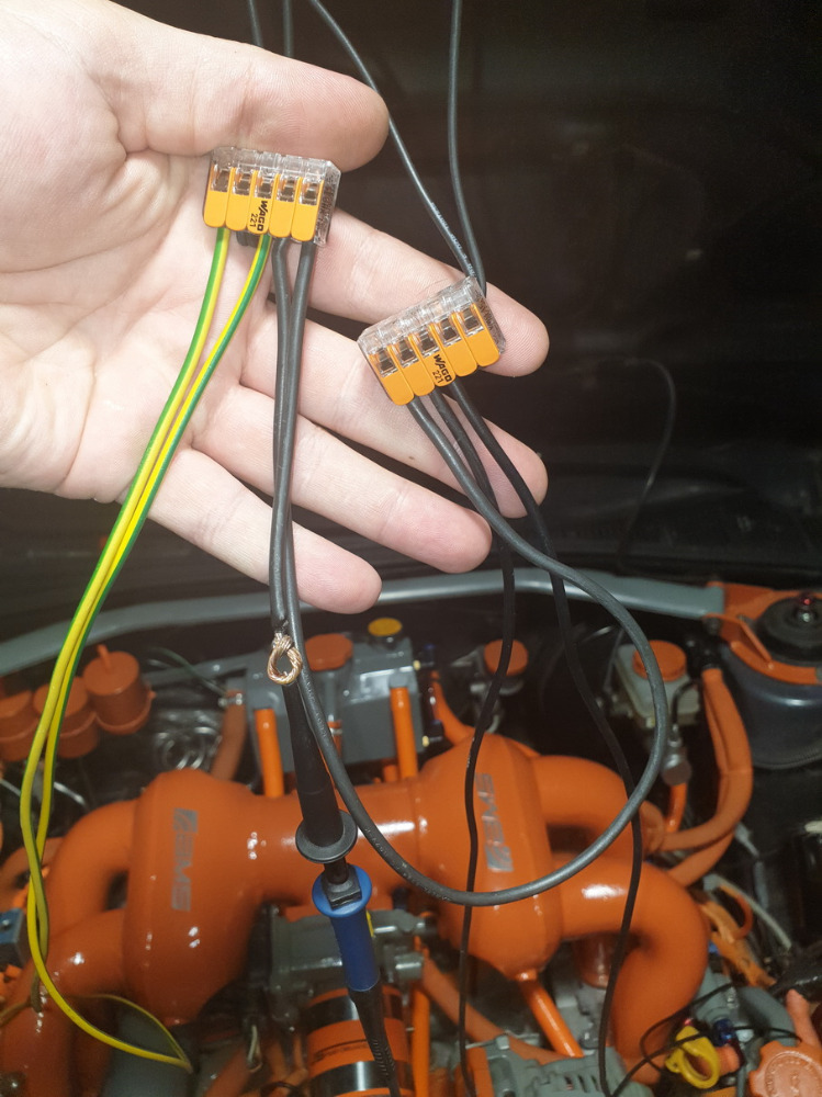

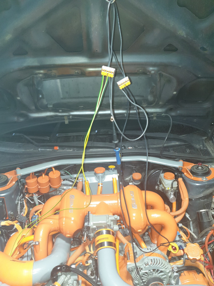

That's it you have the best COP pickup on earth and it costs pretty much nothing. Best of all is that you can build 4,6,8 of them and connect the other ends all together and this way you can measure all ignition outputs on one scope channel.
The blue trace on the first image is with this solution and as you can see, the voltage produced is more then double of the wireloop version, since the area of the tube is significantly higher so it is generating much more capacitance (if that makes sense).
