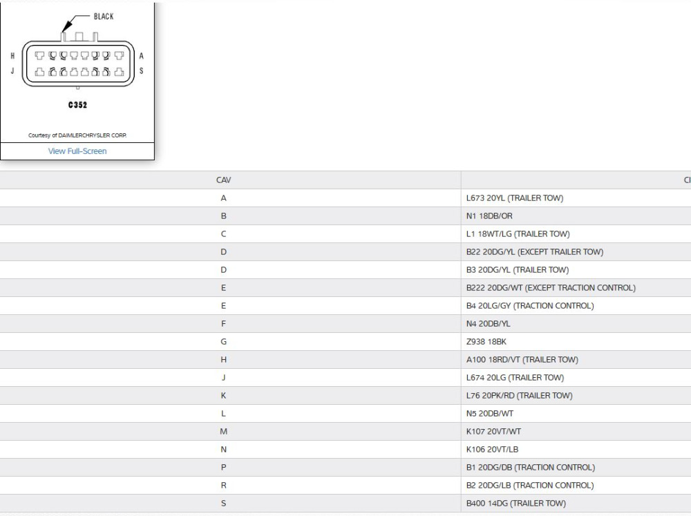

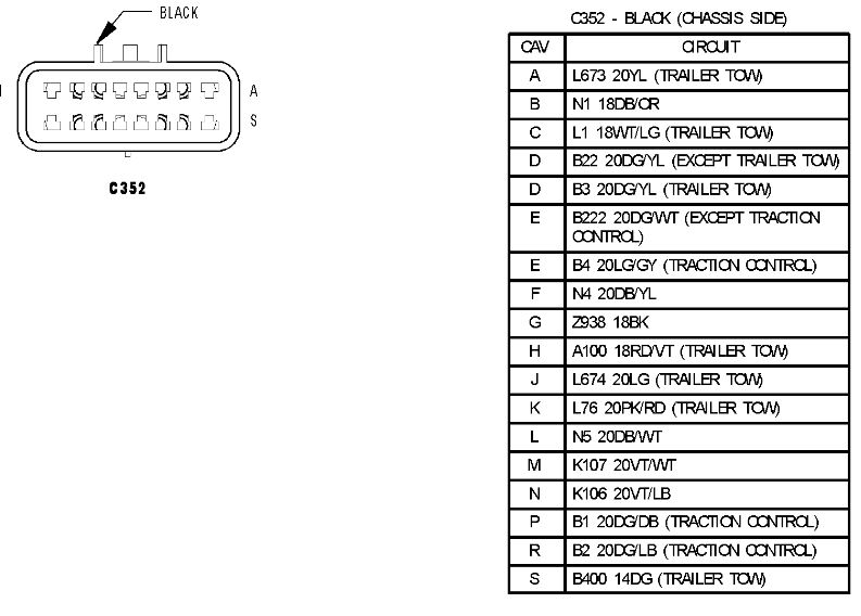

I have been using Mitchell for a while now and am disappointed in the wire diagrams as the inline connectors do not show up. I have had to go back to alldata to have them show up in the diagrams I had a 2005 Durango with no power to fuel pump and had to go back to alldata to have C352 show up.
  • Away
8 years 7 months ago #18824 by Chad
Replied by Chad on topic All Data vs Shop Key ( Mitchell)
Hinderliter wrote: had to go back to alldata to have C352 show up.
This is from Mitchell.
This is from AllData.
I, actually, found it quicker in ShopKey. I think, a lot of it has to do with familiarity with the software.

How do you go about locating it in mitchell?
Alldata shows it in the wire diagram so you know that it actually exist in Mitchell it does not show in the wire diagram so I would have not known that it even existed to look for it.

Ephratah wrote: How do you go about locating it in mitchell? Alldata shows it in the wire diagram so you know that it actually exist in Mitchell it does not show in the wire diagram so I would have not known that it even existed to look for it.
In the Service Manual section under Electrical/Body Electrical/Connector End Views. You can also find it in the Electrical Component Locator under CONNECTORS.But, as you stated, you need to know you're looking for it.
