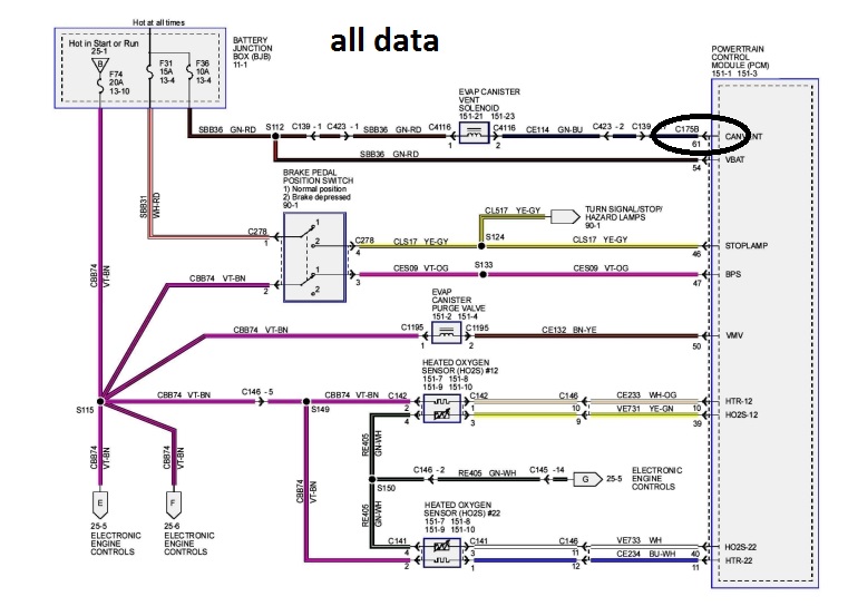

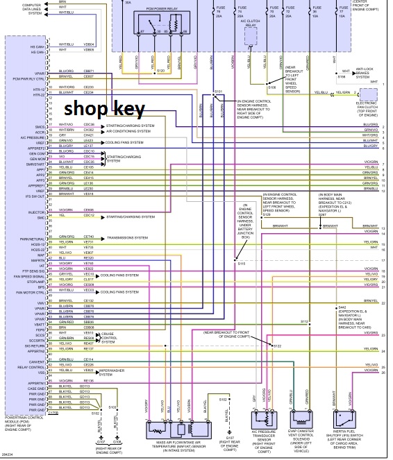

- Ephratah
8 years 3 months ago #20601
by Ephratah
Replied by Ephratah on topic All Data vs Shop Key ( Mitchell)
I tried Shop Key and ended going back to all data had 2 vehicles with electrical issues and went to trace out wires and found shop key was missing the inline connectors I called shop key and spoke with a rep. and was told that vehicles prior to around 2008 were missing the inline connectors that at some point a update was done to the diagrams and the inline connectors got missed some how. I was in a trial period so I cancelled my contract and went back to all data.
- Ephratah
8 years 3 months ago #20602
by Ephratah
shop key was missing C175B and all data had it

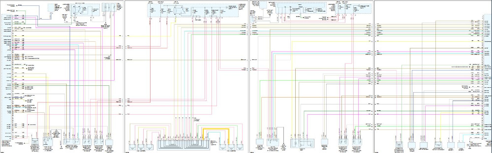

I've been using ShopKeyPro and Alldata, side-by-side, for a few weeks. I was, previously, a ShopKey fan. But, I must say, I really like the NEW AllData. One thing that I, still, like better about ShopKey is the Labor Estimating. Labor times are, pretty much, the same, but I like the format of Shopkey better. It is easier and quicker, for me, to find what I'm looking for. Another thing is during Vehicle Identification, Shopkey ALWAYS offers the 8th VIN digit as a selection. AllData rarely does but, over-all, I prefer their vehicle identification format much better. It is MUCH easier to find previously selected vehicles. And, in my opinion, the game winner is the way AllData will span all pages of a schematic (just like you have seen ScannerDanner tape them together). Zooming and scrolling from page to page is a breeze. Alldata is $24/month cheaper, too.
In summary, I was a loyal ShopKeyPro user for about 5 years. But , AllData has won me over.
