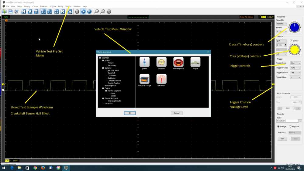

The Hantek 1008C is remarkably cheap it comes bundled with a few handy leads and a DIS ignition probe. It has 8 channels (!) with BNC connectors in reality it isn’t useable as an 8 channel scope because the signal processing is shared between all the channels. To get useable capture speed don’t expect to get useful work out of it with more than 2 or at very most 3 channels turned on. Like most Chinese made scopes I have used the Windows software leaves a lot to be desired it is tedious to use but it has a menu that offers pre-sets for most automotive tests and Y scale settings for most automotive probes. A quirk of the software is by default it installs in the Cantonese Chinese language, this can be fixed by simply deleting the Chinese language files after which it defaults to US English. The Hantek 1008C only differs from the 1008B model in the probes bundled with the scope.
The Hantek’s hardware is perhaps not the best quality and it lacks an AC setting and any built in filters but it can produce some fairly decent captures.
Hantek range includes more expensive faster automotive scopes, I have never used one but it the software interface is the same as that used on the cheaper model,

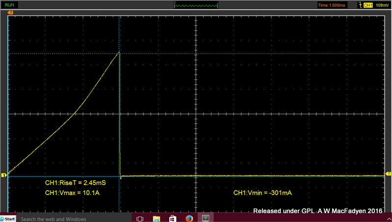

Coil Ramp Hantek 1008 taken with Hantek Amp clamp

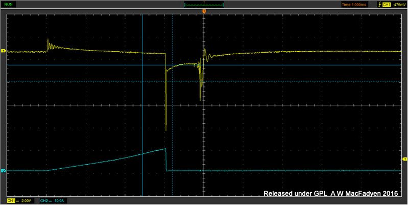

Hantek Ignition Secondary

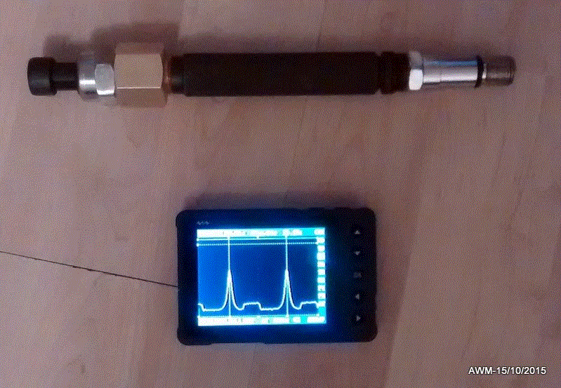

In cylinder Pressure test taken wit DSO201 Nano running Ben-F firmware and home built sensor.

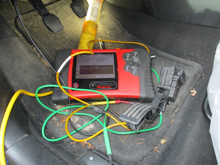

I just completed a rather challenging engine swap and without the Vantage Pro I never would have been able to troubleshoot any of the suspected problem systems. Despite the fact that it cost me twice the price of a Uscope, it easily cost justified itself during this swap.
There are numerous good reasons to buy a used Vantage Pro. Here are what I see as the most important.
First and foremost is the Snap-On component troubleshooter. Packed with information, the troubleshooter gives; troubleshooting procedures, component locations, pin outs, expected voltages and signals, sample waveforms, etc,. It makes use of an amp clamp a no brainer operation.
Secondly, and most relevant to this thread, is the fact that it is a 2 channel scope! I’ve used mine to do cam/crank correlations, O2 testing, injector testing, APP signal testing, relative compression, and several other things.
Consider the fact that the Vantage Pro offers the component troubleshooter and the 2 channel scope it is my opinion that you’d be hard pressed to find a better limited budget scope option. Another consideration might be an older used Modis - 4 channels!!
If your personal budget is such that a Vantage Pro is something you can consider, I say go for it! Prices will vary based on update version and condition. Used Vantage Pros can be found on eBay and Craigslist.

The in-cylinder pressure tester was quite simple and cheap to build istr I wrote it up in the old Scanndanner forum since them I added a couple of refiments so I will rework it and post it again. I also built a Firstlook style pressure pulse sensor using a contact microphone and a plastic Mustard bottle.

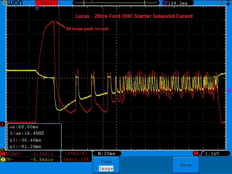

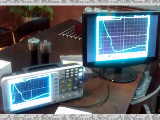

Time for a report on my Owon SDS7102v Labscope with optional battery
Purchase cost at December 2015 £360 including optional bag and battery
I really like using this scope I can get up and running a grab a decent capure fairly quickly, but it isn't designed for car work and while it suits me it won't suit everybody. The battery life between charges was never as good as expected and after a years use it has died completely. When I bought the scope I was offered a special deal on the battery and bag bundle and I suspect the seller was off-loading a suspect load of batteries. As a replacement battery is fairly costly at £60 I am reluctant to commit to buying a replacement which may suffer the same short life as the original, in the interim I am continuing to use the scope on 230v power. I am very tempted to buy a new scope a Carscope Viso.
Good points
Real not virtual knobs, automatic setup, decent memory, excellent built-in software filters, USB ports for Flash Disk and PC connection, VGA port for connection.
Bad points;
Labscope not specialist Automotive Scope, Fairly bulky, Disapointing battery life between recharges, 230v mains power, battery has died after 1 years use. Channel 1 trace is difficult to see in bright sun light, Owon's PC software interface is not good.
Last edit: 9 years 5 months ago by Andy.MacFadyen.
