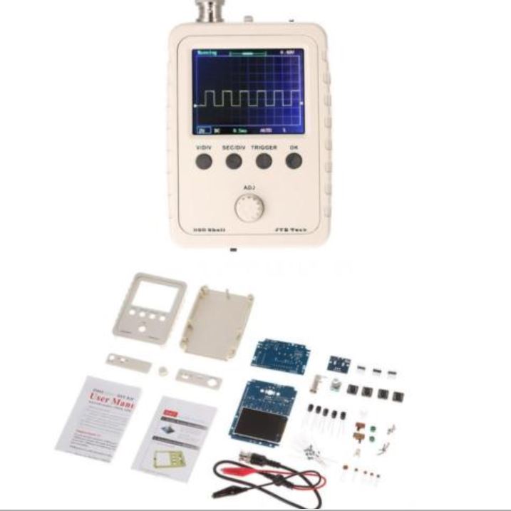

No eBay APP ID and/or Cert ID defined in Kunena configurationA really low cost option for an oscilloscope if you have a soldering iron is this kit from ebay. It is less than $30 and is surprisingly good. I bought mine several months ago and am amazed at its features including storing the trace and calculating max, min, avg voltage in the trace as well as duty cycle, frequency etc. I have not had an occasion to use it on my cars yet but did diagnose and fix problems on a powered loudspeaker and a signal generator. You can find several listings on ebay but here is one:

Secondwind wrote: A really low cost option for an oscilloscope if you have a soldering iron is this kit from ebay. It is less than $30 and is surprisingly good. I bought mine several months ago and am amazed at its features including storing the trace and calculating max, min, avg voltage in the trace as well as duty cycle, frequency etc. I have not had an occasion to use it on my cars yet but did diagnose and fix problems on a powered loudspeaker and a signal generator. You can find several listings on ebay but here is one:
I just picked up with of these and will start building it soon. Straightforward instructions. I'm not so good with small component soldering, so we'll see if it works when I'm done.
