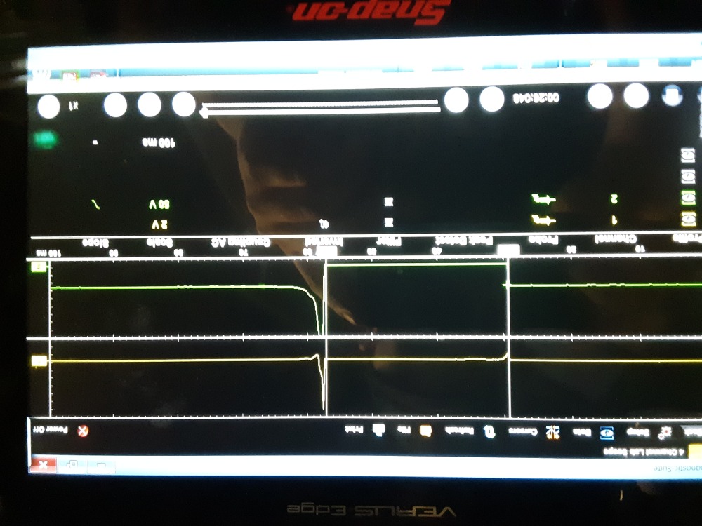

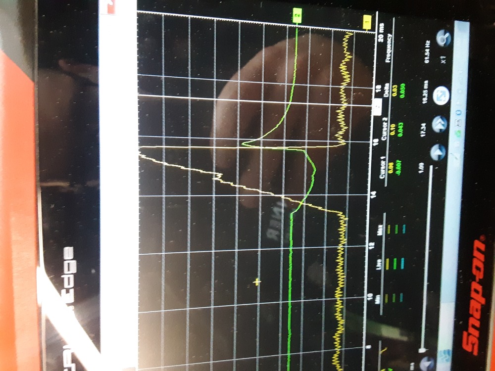

6 years 10 months ago - 6 years 10 months ago #34195 by Noah
Replied by Noah on topic Injector Testing With Secondary Probe
Here's a capture touching the purge solenoid on my Honda with a voltage trace on the control wire for comparison.
Sorry the forum uploads my pictures sideways and upside-down :(

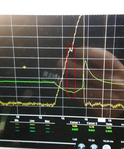

6 years 10 months ago - 6 years 10 months ago #34197 by Chad
Replied by Chad on topic Injector Testing With Secondary Probe
I believe I can see pintle opening.
Last edit: 6 years 10 months ago by Chad.
6 years 10 months ago #34198 by Noah
That's where I was looking also. Guess I need to find a car with a stuck injector now

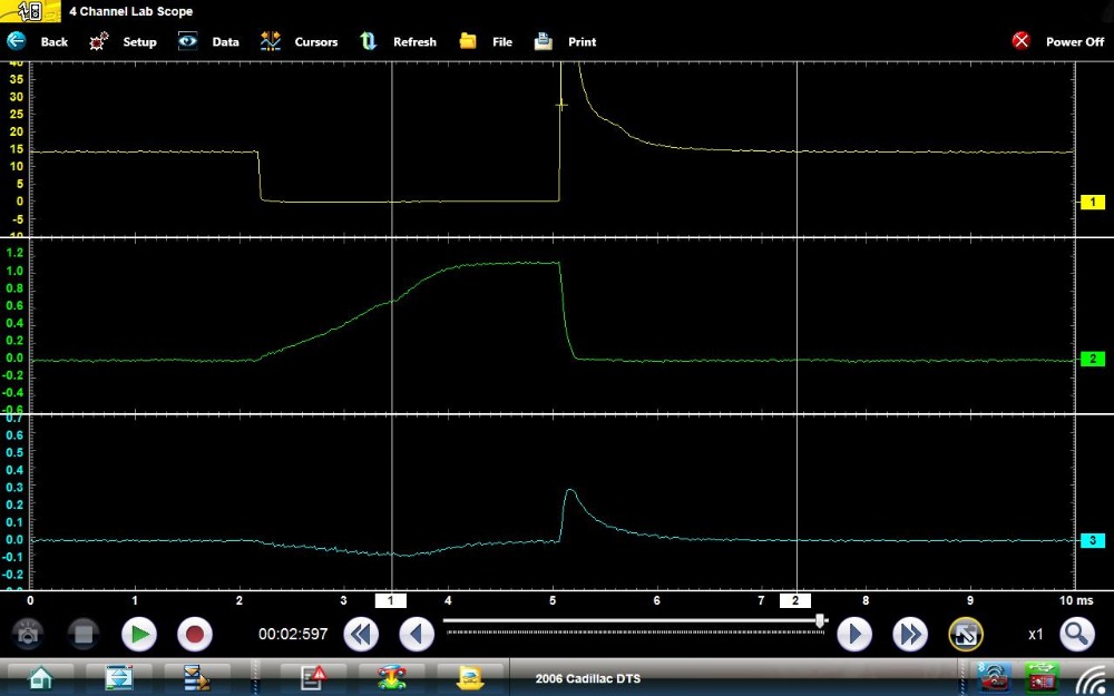

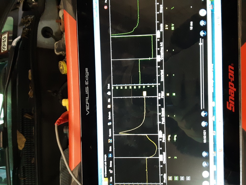

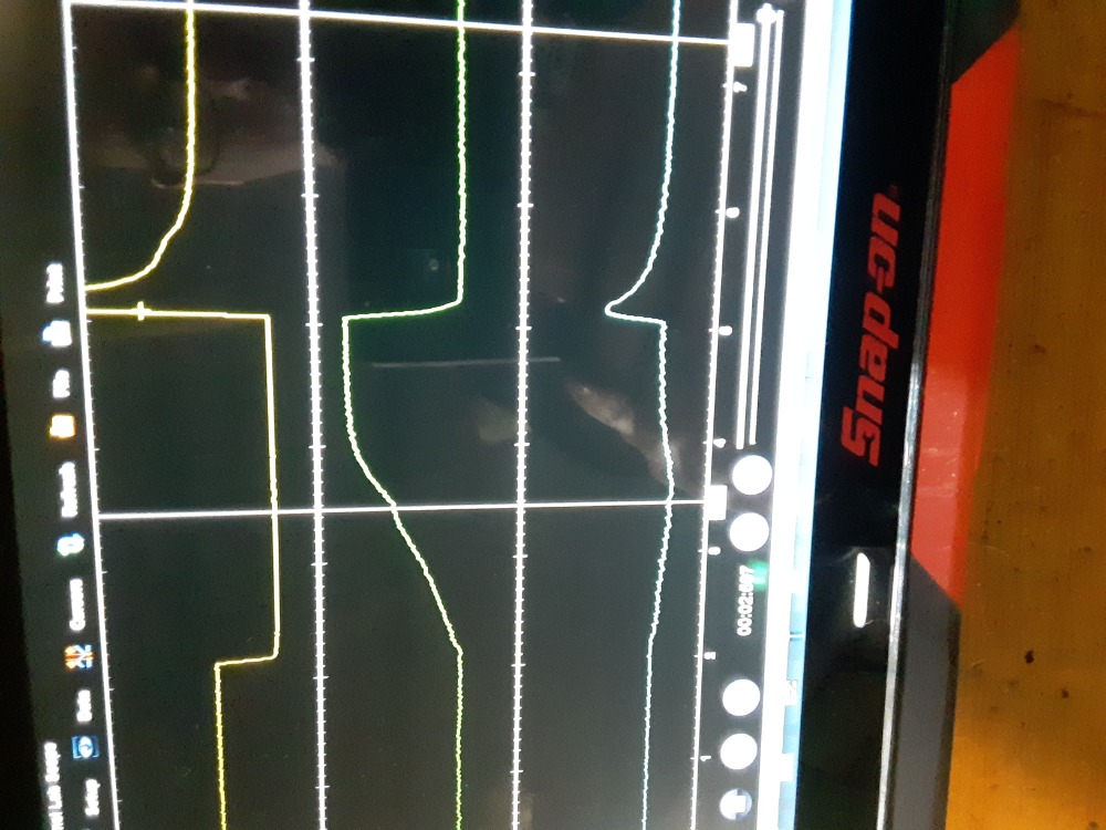

6 years 10 months ago #34348 by Noah
Here's another one I had a chance to hook up to today.
2006 Cadillac CTS 4.6l
It looks like when the downward slope of the blue trace begins to climb is when the pintle hump is visible in the current ramp.

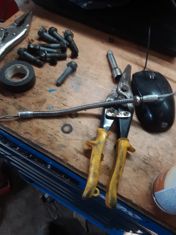

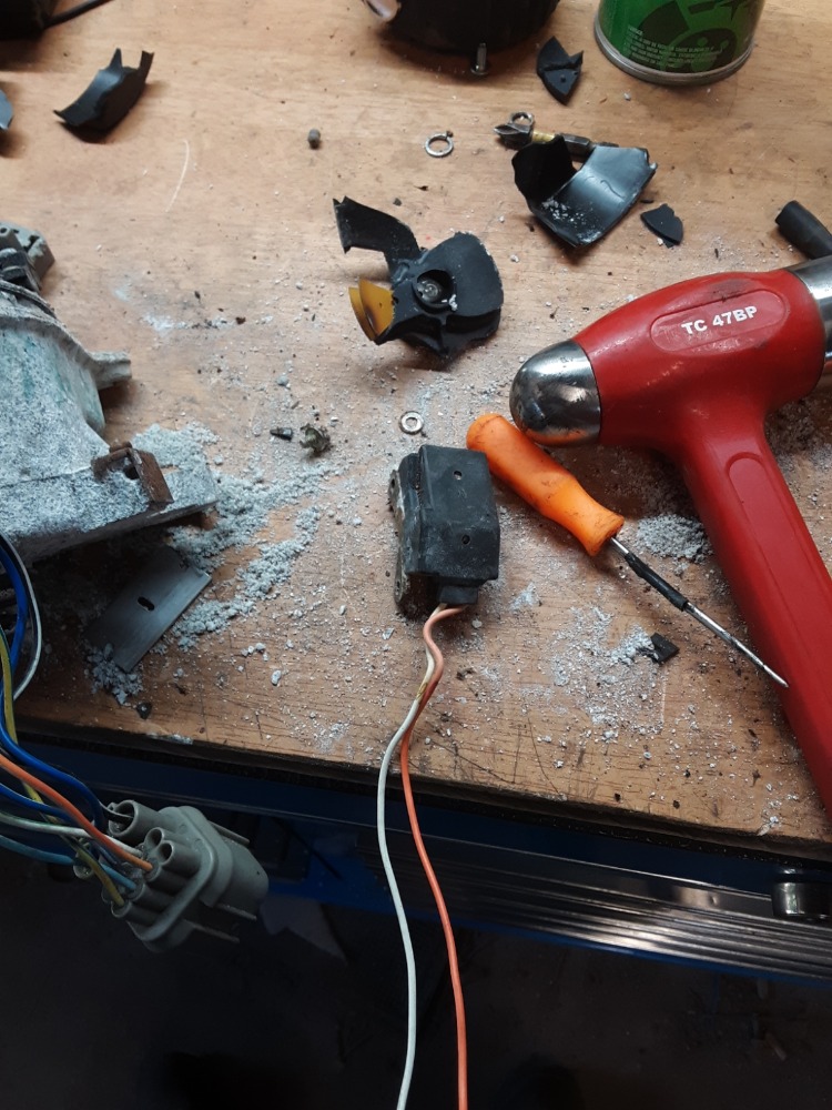

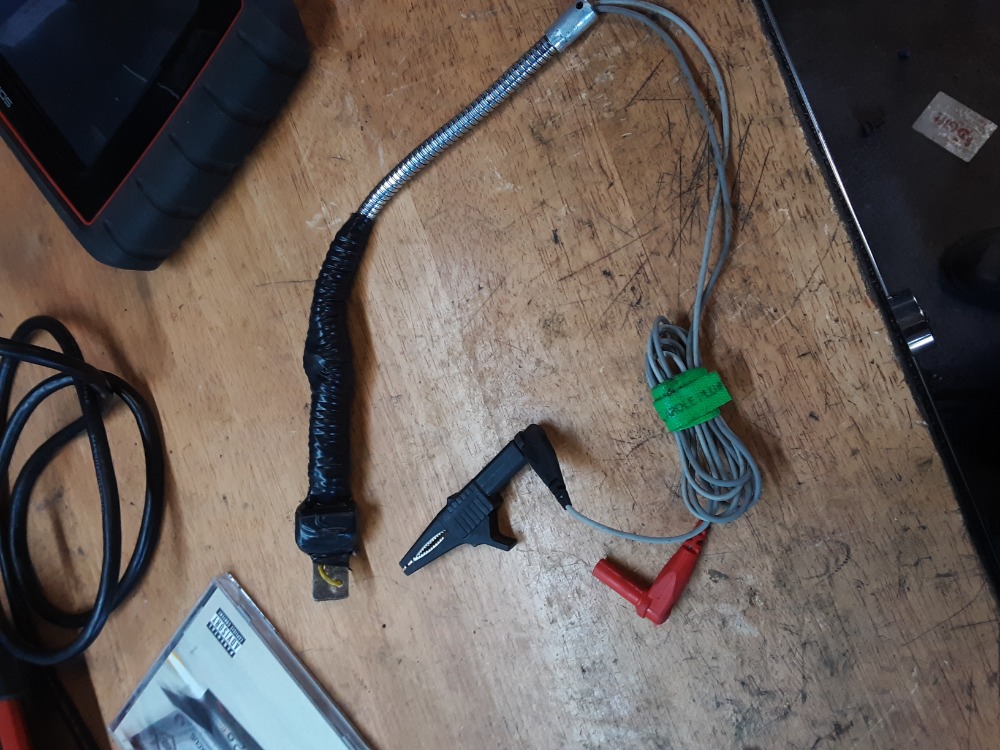

6 years 3 months ago - 6 years 3 months ago #40315 by Noah
This is the build for Andrew.
It's seriously not fancy, so don't be too disappointed.
I deftly extracted, well, more truthfully brutalized an old Civic distributer to get the pick up out of it.
That's the little tid bit in the middle.
It's much larger than that to start. After I harvested it I ground much plastic off it (per Tyler's instruction) to get it down to that little giblet.
For the handle i used the flexible neck from my Astro rechargable light, which was also brutalized in an unrelated event.
I fed an old set of meter leads through the handle and connected them to the leads of the pick up. It was a total shot in the dark as far as determining polarity. I figured if it sucked it could always return to the trash from whence it came.
I wrapped the whole deal in mastic tape which gives it a nice rubberized-ish handle and a not-so-piece-of-crap look.
One lead goes to chassis ground, the other goes to the scope.
Then it's just a matter of fiddling with the scope to get the best pattern.

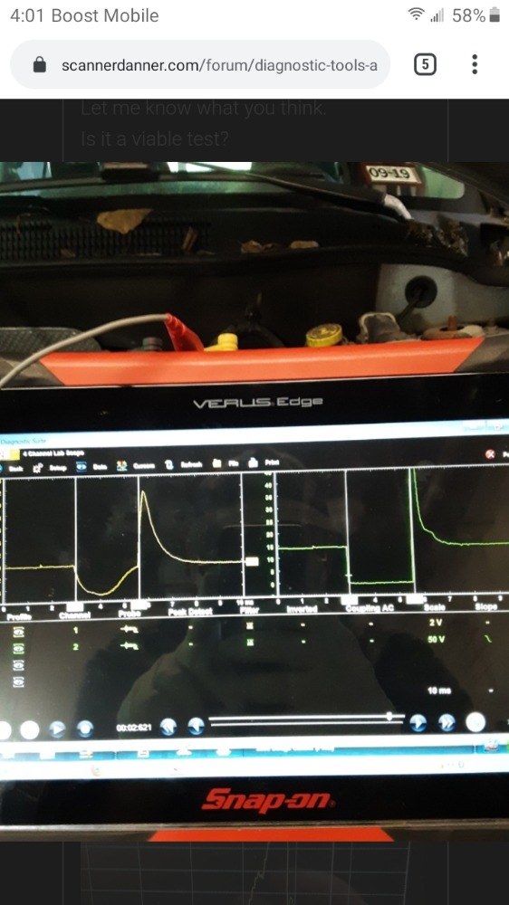

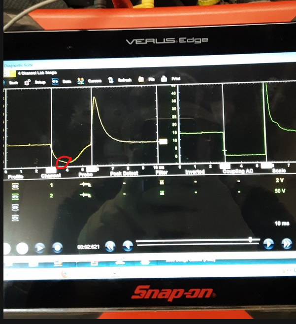

6 years 1 month ago #41145 by al514
Replied by al514 on topic Injector Testing With Secondary Probe
Is that what that roundness is on the yellow trace ( 2pics up)? I assume the green trace is a backprobe reading? If this is true, then genius! Next level, another quick test to take a peak at injectors. And if we can learn wave forms under different circumstances, then that's another step up in testing, and it's so basic.
6 years 1 month ago #41146 by Noah
That one?
Yes, that's a home made secondary ignition probe touching a fuel injector in yellow with the control voltage displayed in green.
Thank you for your interest :)
