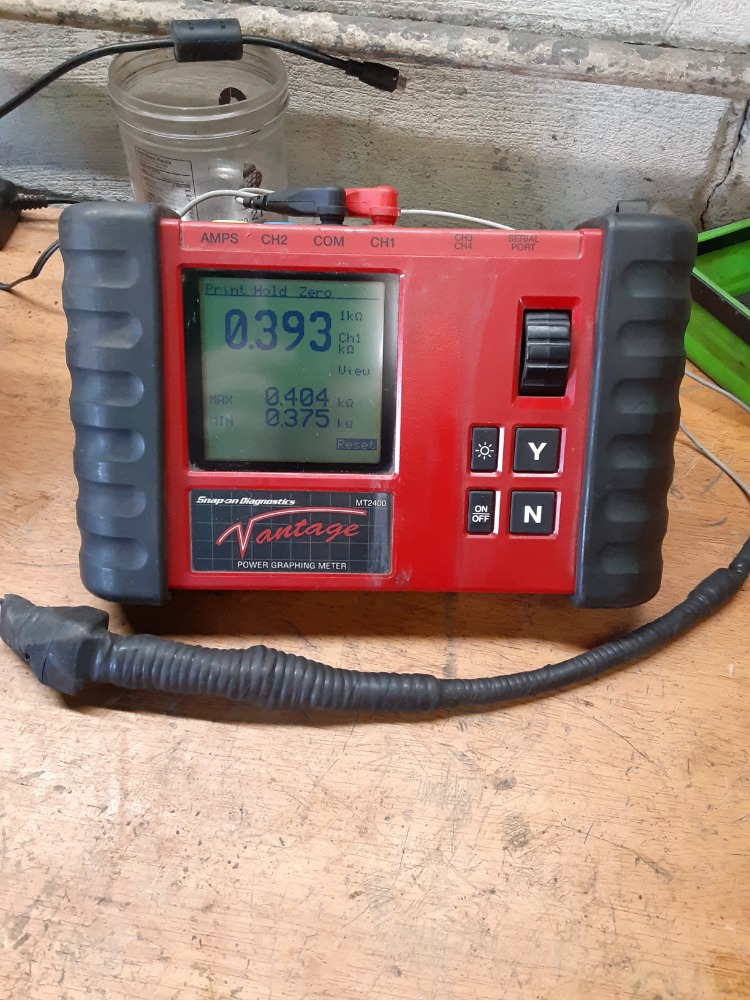

So only 2v scale, what's that yellow trace hitting for voltage reading in the 2nd picture down? And sorry for all the questions, it's like I can't stop wanting to learn more, considering I hated highschool lol

Not sure what the voltage peaked at. It's a 50v scale and it's off the screen so it's more than 50v

Hey Noah, I may have asked already but do you know the resistance of pickup coil you used? I have a coil that might work, it's about 550 ohms. Or does it not matter, this coil I have has a ton of windings too, not sure if that changes anything.

About 400 ohms.

How do I wire up the coil, do both leads get hooked up to the coil or one to the coil and one to ground?

I dunno how Noah wired his? I had one lead going to each wire off the coil. I connect one lead to a lab scope channel, and the other to scope ground.

Same. One lead to the scope, one lead to ground.

Without your scope grounded at all? What about running the 2 scope leads to the coil, then an additional wire going to ground somewhere? So you would have 3 wires. Isn't that how most leads are set up?

I think when I used it I grounded the scope out of caution, but I don't recall it having any noticable effect on the trace.

al514 wrote: Without your scope grounded at all? What about running the 2 scope leads to the coil, then an additional wire going to ground somewhere? So you would have 3 wires. Isn't that how most leads are set up?
Many probes are set up that way, in case there's a secondary voltage leak and a spark hits the probe. With the third wire to ground, hopefully the secondary voltage will go to the vehicle and not your scope. :silly:

That's what I'm worried about, especially with diy probes. Maybe I'll throw a 20x on just in case on the first try.

In my experience, most arcing happens in and around plug wires (rubbed through, open wire, moisture). Genuine COP's will rarely arc to the top of the ignition coil, where you'd have the probe laying for testing. They might arc around the coil tip to the plug tube, but it won't reach the probe, and you'll see that on the secondary trace. ;)

My diy probe worked awesome bud, I could see the injectors and ign coils perfectly. Thanks for the advice, I saved a ton of money building my own tools.
