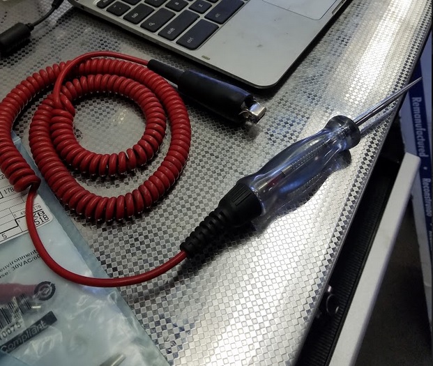

For reference, this is what I started out with:

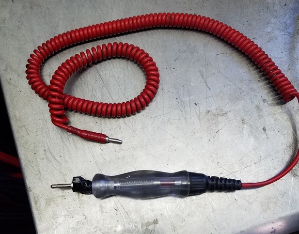

My original idea was to drill and tap the pointy end for one of these . As it turns out, the shank is stainless steel, and (spoiler alert) SS does NOT like to be drilled or tapped. :blush: Solder didn't work, either. We have a MIG welder at work, but the wire won't stick to SS. So, this is where I ended up:

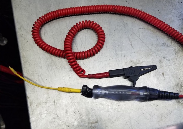

"Tyler, is that two zip ties covered with electrical tape?" Yes, yes it is! :lol: I was really hoping some something more elegant, but it works. With some accessories:
If this ends up working the way I want, then I'll either buy some better drill bits, or some SS welding wire.

One big advantage of having the banana jack on the rope end is being able to use it with my AESwave Power/Ground adapter . Before, I'd have to stick my pocket screwdriver into the red port, and clip my light to it. Frustrating. :angry: But now, I can just plug it in and test away!
