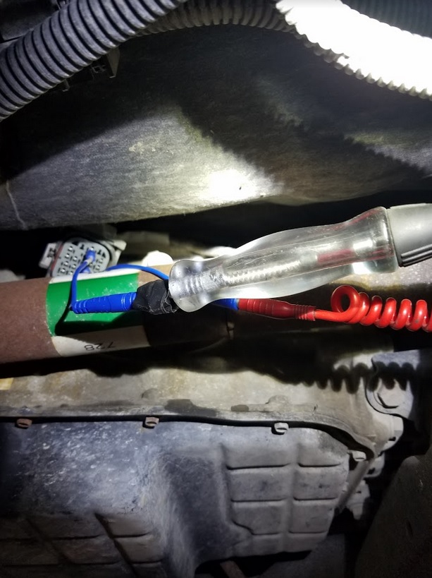

Also, got some more use out of the homemade light. Can confirm, works well with the AESWave uTest kit .
Last edit: 9 years 8 months ago by Tyler.
9 years 8 months ago #6434 by Noah
Replied by Noah on topic Test light + banana jacks?
You pulled the trigger on the U Test kit? Nice!
Looks like a Chrysler trans? Jeep maybe?
  • Tyler's Avatar Topic Author
9 years 8 months ago #6439 by Tyler
Replied by Tyler on topic Test light + banana jacks?
Noah wrote: You pulled the trigger on the U Test kit? Nice!
Nah, I wish. :( The shop bought that kit from the Matco truck. Though, using it really makes me want one of my own. :lol:
Points for you! 2006 Heep Grand Cherokee. How'd you know? :blink: The trans pan?

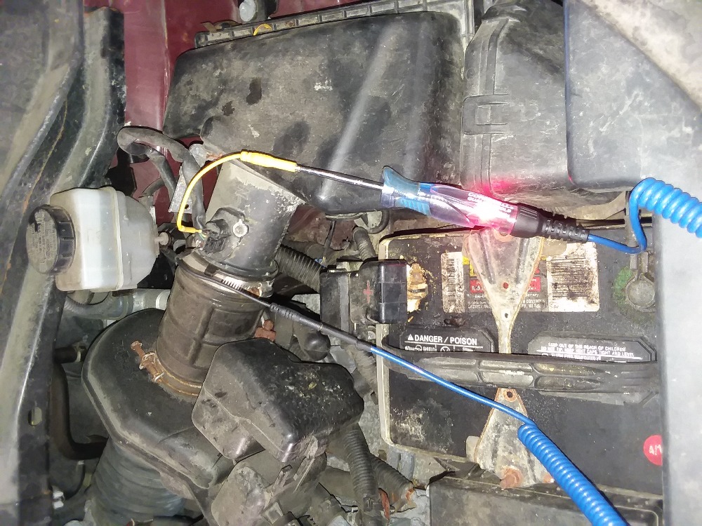

8 years 9 months ago - 8 years 9 months ago #17254 by bruce.oliver
Replied by bruce.oliver on topic Test light + banana jacks?
Made mine today. Works very well.

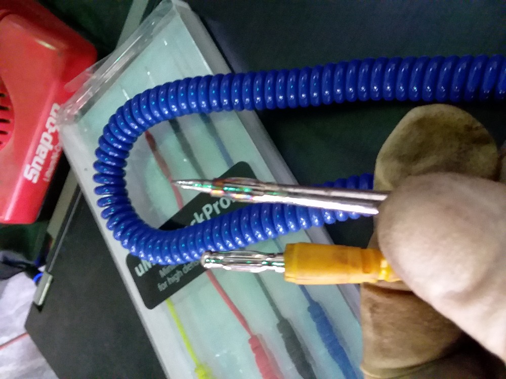

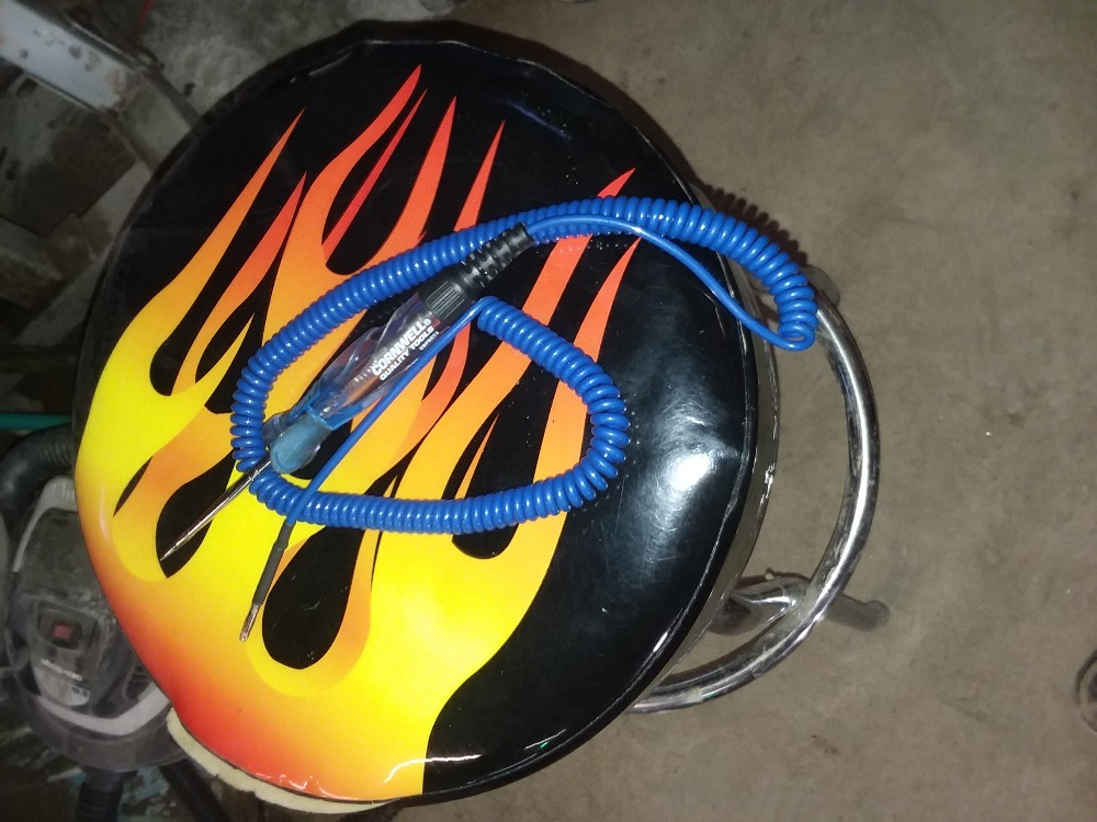

8 years 2 months ago - 8 years 2 months ago #22491 by Noah
I took the flare off an old male test lead and just slid it into my testlight.
It's inconspicuous, and doesn't get in the way if i don't want to add an accessory to the tip of the light.
I also soldered a male end on the cord. Now I can use my back probes or whatever I want on each end of the test light.
8 years 2 months ago #22513 by Tyler
Yessssss. B) This is what I should have done with mine. For anyone following along later, this is the way to build yours. ;)
