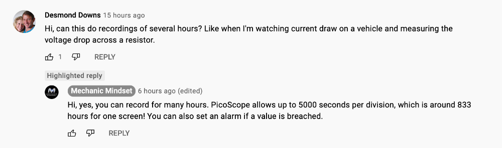

It's been a while since I visited :) Our workshop oscilloscope has finally died and needs to be replaced. While I'm waiting for the company
to spend a few grand on a 'proper' scope I'm wondering if any of these budget scopes have a good recorder scope option?
For example - when I'm tracing a current draw on a vehicle I measure the voltage drop across a piece of wire in series with the
battery over several hours, so I can watch as things turn off and the current drain falls away on some of these fancy European cars.
Sometimes I want to zoom in to an area of the screen especially when I have measured over 3-4 hours.
I had one of the Hantek 8 channel budget versions but couldn't even find out where to turn on voltage reading, let alone record
for extended periods.
is there a cheaper scope out there that is easy enough to use that can do this?
4 years 11 months ago #51272 by Matt T
Replied by Matt T on topic Budget scope with long term recording?
A cheap Pico will probably do what you want. IIRC all their 'scopes have USB streaming which is what you're gonna need to record for that length of time.

Ok, I found the 2204A for $350. Just not sure if it can do the long time recording function.
  • juergen.scholl
  • juergen.scholl's Avatar
  • Active partschanger
4 years 11 months ago #51283 by juergen.scholl
Replied by juergen.scholl on topic Budget scope with long term recording?
You may want to ask Darren from Mechanic Mindset. He is knowledgeable on the 2204 topic.
  This link takes you to a video on how to make the 2204 work with the​​​​pico 6 software.
He's got a website too where to contact him.

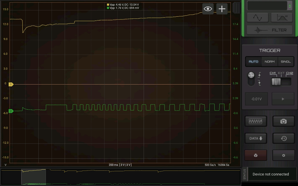

Make sure that Hscope will connect with the device before you pay for the modules. Martin will not refund and he has stated that you must check compatibility. Now I have a Samsung S5 it works on and I use my Lenovo 10" tablet most of the time. Once you pay for the modules go sign up to be a beta tester, Martin encourages it, and you will get some pretty cool features he's working on. If you are the real geek, he designed his own scope as well and other modules that you can build.
In hscope go into settings, then click probes. In here you can download from the cloud a bunch of preconfigured probes or custom configure here. Just have a look, No problem if you want to use a in cyl press transducer, its probably already there or make one yourself. The hantek secondary probes are x10000. Not many cheap scope will let you configure that, I know my other ones won't.
Zoom feature, WOW, spread or pinch your fingers and it will zoom in a very very very long way. Same thing with time base. You can vary the rate of capturer from 50ns to 2 seconds per div. When you get the license it will enable longer timebase. Without the license its useless software.
He has a very strong following in the automotive module and he adds new stuff all the time. I used it to show someone a few months back that they had a bad cyl. and it took all of about 10 min. When you have a picture of the failure, its hard to dispute it.
4 years 11 months ago #51726 by Grouchyoldman
Replied by Grouchyoldman on topic Budget scope with long term recording?
If you look at the bottom you will see a window. that window is the whole capture and you can zoom and scroll the entire window. This waveform is off my truck, cam and battery voltage drop and it does have a failure in it, just not in that shot.

In the automotive module using 1KSa/s will allow you to record(at least on my tablet) 5 hours and on my phone for some weird reason will record 11 hours at 250 samples a second. I think my clamps would wonder after that much time. At those rates it won't be the best looking but it should get the job done.
