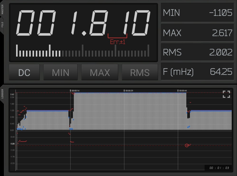

Monday morning and it's quiet at work which gave me some time to set it up. The data logger will come in useful
for long recordings monitoring charge rate or current draw. In the automotive module I can get about 2 1/2 hours
recording time but my voltage is stuck at 5v? I have to use the 10X function of the probe to keep it on
the scale and then it's not very accurate. How do you get a 12v scale?
- Desmond6004
4 years 11 months ago #51855
by Desmond6004
Replied by Desmond6004 on topic Budget scope with long term recording?
Ok, I worked it out. use a 10X setting on the probe and then set probe to "10X" on the screen - duh!
Now I have up to 50v.

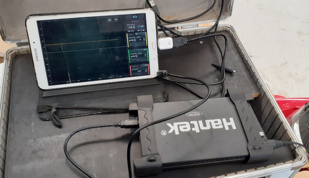

With the red USB of the Hantek plugged into a phone charger and the other one plugged into my tablet it ran
most of yesterday morning and dropped to 25% after lunch set to record long term. When it isn't plugged into
the charger it drops 10% in a few minutes so I'd say the charger was supplying the Hantek when I had it connected.
I went through the probe downloads last night - looks like some useful stuff there

I didn't get any cables with mine. Can you show me the cable? Is it the USBx1 port?

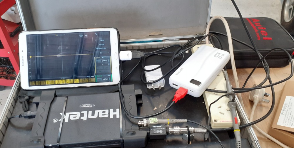

- Desmond6004
4 years 10 months ago #51906
by Desmond6004
This morning I plugged it into my 20 a/h 'brick' that I received yesterday and after it running for an hour
the tablet showed 73% and the brick was still at 100%.
I unplugged the scope and plugged the tablet directly into the brick and it took 1 1/4 hours to charge the tablet up
again to 100% [with it still switched on] and the brick showed 99%.
