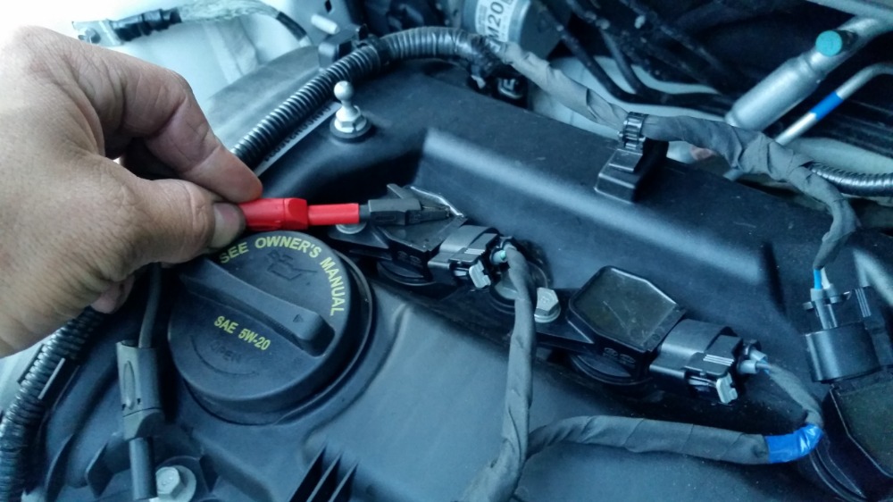

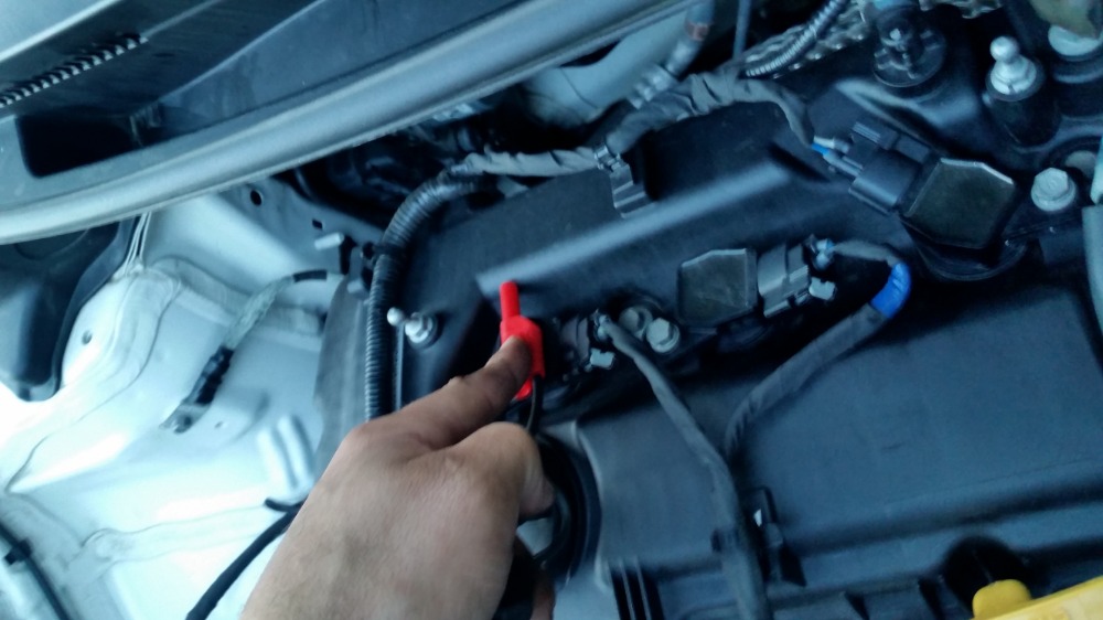

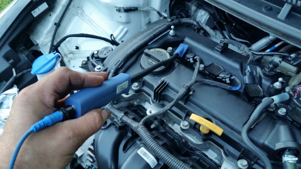

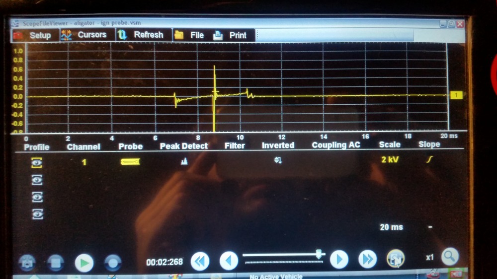

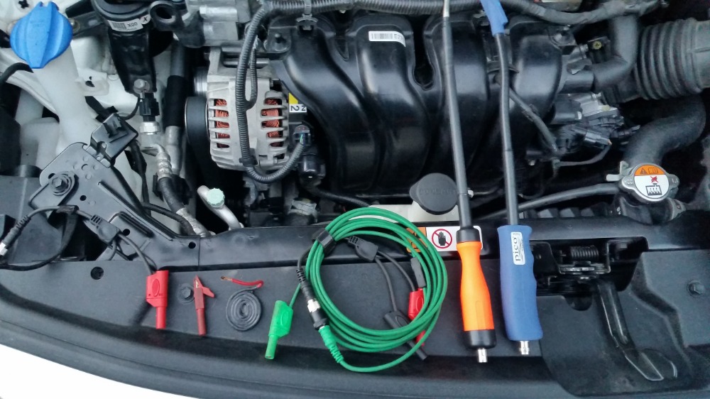

Hi Guys

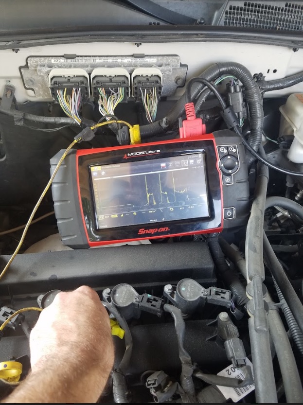

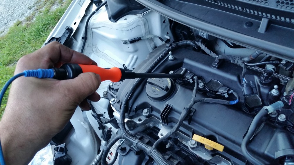

I have been having a hard time with ignition probes and decided to make a side by side comparison.
Vehicle: 2017 Kia Forte5 2.0L - Cyl #1 Coil. (All coils presented same waveforms.)
Here are the contestants and how they were used.
Pico Probe. Cost: $149 + Shipping
Wyze Probe 15". Cost: $139 + Shipping
Alligator Clamp. Cost: You probably have one
Banana Plug. Cost: You probably have one

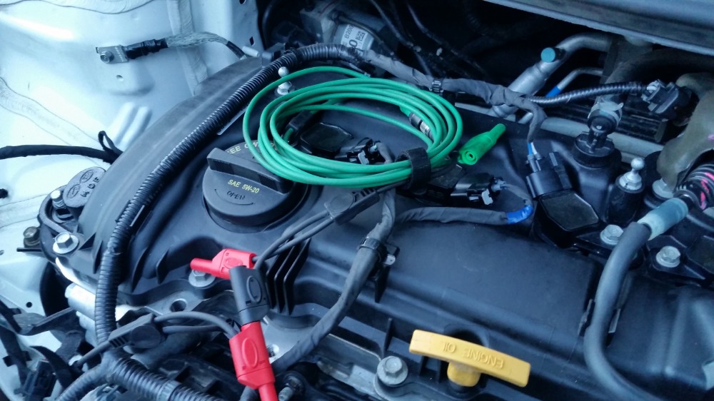

Test Lead Coiled - Using shielding as the inductor - Added a Current Ramp to the Waveform to pin point Coil #1
DIY Probe. Coil of Wire. Cost: Pennies
Last edit: 7 years 11 months ago by graywave.

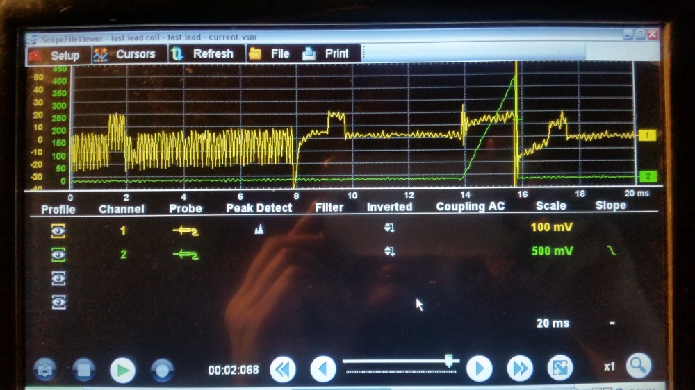

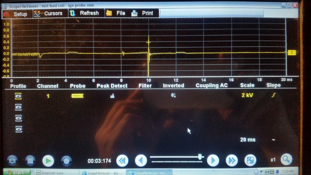

  • graywave

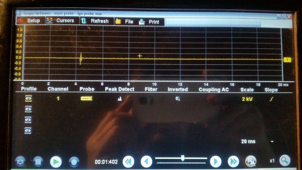

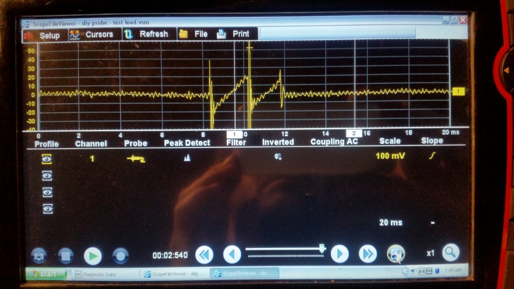

7 years 11 months ago - 7 years 11 months ago #23319 by graywave
Pico Probe. Scope Probe Setting: Ignition
Pico Probe. Scope Probe Setting: Test Lead

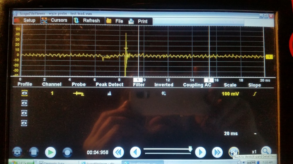

Wyze Probe. Scope Probe Setting: Ignition
Wyze Probe. Scope Probe Setting: Test Lead

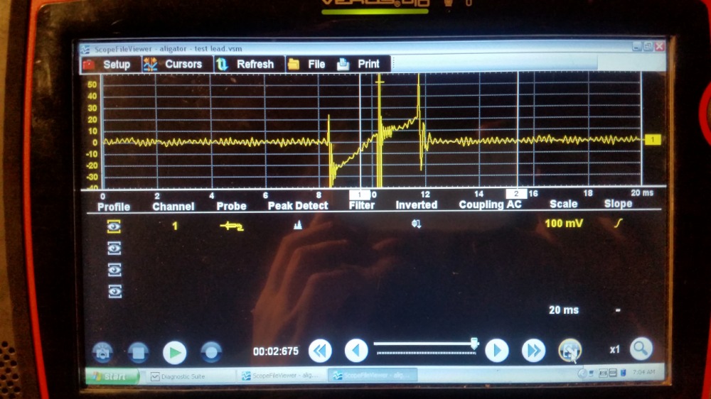

Alligator Clamp. Scope Probe Setting: Ignition
Alligator Clamp. Scope Probe Setting: Test Lead
The following user(s) said Thank You: Andy.MacFadyen, Lupe

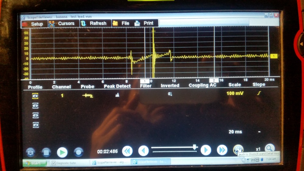

  • graywave
7 years 11 months ago #23320 by graywave

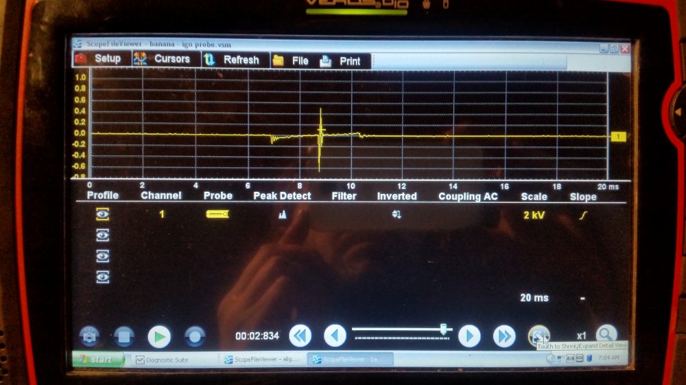

Banana Plug. Scope Probe Setting: Ignition
Banana Plug. Scope Probe Setting: Test Lead
Test Lead Coiled. Scope Probe Setting: Ignition
Test Lead Coiled. Scope Probe Setting: Test Lead (Added Current Ramp for #1 Coil)

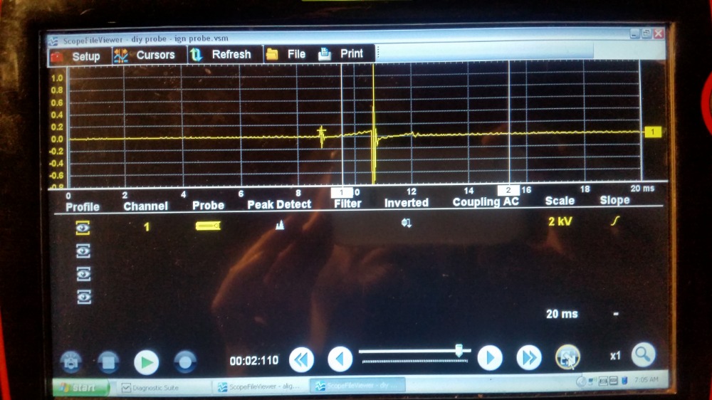

DIY Probe. Scope Probe Setting: Ignition
DIY Probe. Scope Probe Setting: Test Lead

7 years 11 months ago #23333 by Tyler
No, but you can bet I'm interested now! :woohoo: Excellent comparison, sir.
The quality of waveform you get out of the 'impromptu' probes is blowing my mind. Is the coil of wire thing just wire and shrink wrap, or is it more intricate?
Hoooooold up a second here. You think everyone reading this thread has alligator clamps just lying around?! :angry:
  • graywave
7 years 11 months ago #23341 by graywave
Tyler wrote: No, but you can bet I'm interested now! :woohoo: Excellent comparison, sir.
Just plain wire. I believe it was 16 AWG wire. I tightly wrapped it in a circle using super glue to hold it together and used Liquid tape, about 3-4 coats to cover it up. I also tried 18 awg wire with more wraps and two layers of wraps but didn't make a difference, if anything it made it less effective. I think the second layer (all one strand of wire) might have had a negative effect.
HAHAHA Well if you don't I feel sorry for you!! O wait... No I don't... :evil:
  • graywave
7 years 11 months ago - 7 years 11 months ago #23342 by graywave
Now we all have to remember that these Professional Ignition Probes are attenuated. I think they are around 1000:1 . So 1v on your scope should equal 1000 volts. Though these coils must have some shielding. I have tested ignition coils that completely go off the scope. That was before I had 4x 20:1 attenuators.
So using a coil of wire might work on some coils, but may over power your scales on your scope on other coils. I am thinking that 1x 20:1 attenuator may not be enough to bring the waveform within your voltage scale on some coils or wires. I have 4x, so maybe stacking them together. That might be where the professional probes come in. I will be keeping the pico probe for this reason. I also like that there is no metal exposed so a spark shouldn't jump to the probe unlike the wyze probe.
Edit: I don't know if there is a calibration difference between Pico and Verus in terms of scaling for the attenuation. AESWave tells me I should be using the "test lead voltage scale" with peak detect on and possibly inverted to use a pico or wyze probe.

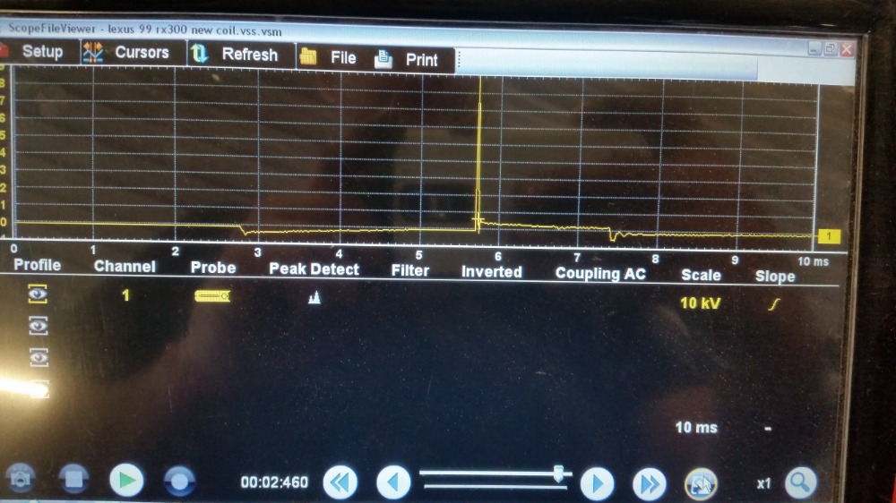

  • graywave
7 years 11 months ago #23370 by graywave
Tried the pico probe on a 99 lexus rx300. Waveform was unusable and look like what I had on my kia.
I used my DIY Probe (coiled wire) and it worked perfectly. I have snap shots of it.
  • graywave
7 years 11 months ago #23371 by graywave
Good coil
Bad coil (no spark at all though i see a biy of a firing line so must be arcing internally? All the hash I am see I think would tell me high resistance.
For some reason it saved off the screen
The following user(s) said Thank You: hobbsautomotiverepair

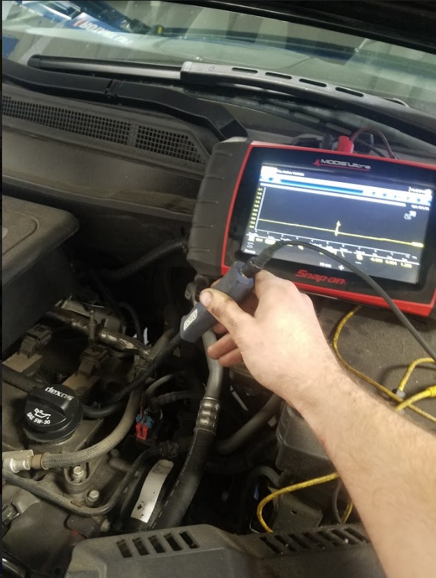

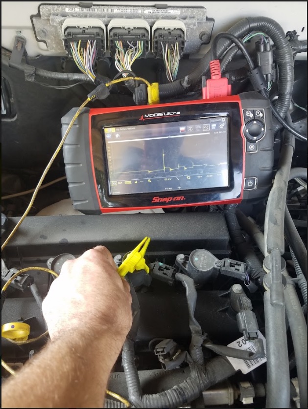

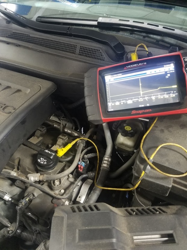

7 years 11 months ago - 7 years 11 months ago #23372 by Tyler
Had to run with this concept. :cheer: So I tried it out on my personal fleet.
First up is an '09 Escape with the 2.5L. The attenuation factor that graywave was talking about is VERY evident here. Here's a shot of the alligator clip on the top of the coil:
I don't have my Pico TA204 on hand to compare to, but I can say this waveform is very close to what it'd generate. Note this is on a 50kV scale, the highest the Modis (and probably the Verus, too) has in the Ignition Probe mode.
Then I went for the bottom of the coil:
Whoa. :blink: The Ignition Probe mode just doesn't know what to do any more. You'd have to go over to a regular voltage scale to see anything useful. Still, this begs the question: Why did I buy the TA204? :dry: :lol:
The attenuation thing is super evident in this video:
drive.google.com/file/d/1uOmGDT-h00PBXGc...08T/view?usp=sharing
Then I had to try it out on the Scion. I've never had luck with secondary waveforms on the Toyota four wire coils. Too heavily insulated. But I was very surprised to see this:
The detail isn't amazing, but it's there! :woohoo: Then I decided to take it a step further - could I see a lean cylinder with the same waveform?
drive.google.com/file/d/102qGqGt66tms36L...lDp/view?usp=sharing
Eh, maybe? It's not super clear. If this were a customer diagnosis, I'd back it up with an injector drop test.
Last edit: 7 years 11 months ago by Tyler. Reason: Stupid video tags
The following user(s) said Thank You: kevinedward1234, hobbsautomotiverepair
  • graywave
7 years 11 months ago - 7 years 11 months ago #23375 by graywave
Better snap shot of bad coil. No spark externally. Maybe secondary shorted internally.
Important stuff to note down that I noticed with this waveform.
1. Spark Line. There is a definitive spark line which caught me off gauge since this cylinder was dead.
2. Downward Angle of spark line. I think downward angled spark lines mean high resistance. Though there is a path to ground?
3. Hash/Noise at beginning of high spark line. I think this also a sign of high resistance within the secondary side. Energy not being able to discharge fast enough and ringing its self out a bit?
4. Snap throttle test. You can't see this from the image obviously but during a snap throttle, the spark line never shortens. It never fluctuates based on internal cylinder conditions like the other coils do. This could be a big hint when diagnosing a coil that has a spark line like this.
5. Hash/Noise in the "Turn On" of the coil. Not sure what this could be but some how related to a secondary shorted?
I'm Interested to hear your thoughts.

I am pretty impressed with my DIY Coil of wire probe. I want to make it into a wand and use smaller magnet wire.

7 years 11 months ago - 7 years 11 months ago #23377 by graywave
Here is an image of the "NEW" coil I installed. DIY probe had to be set to a 10Kv scale and still slightly goes off the screen. So coil shielding will probably mess this the KV readings but I wonder how close this is to an actual voltage output for an idling engine. I've never actually research how much voltage a coil needs to produce at idle for a normal .040" +/- .010" GAP. I know its not an exact science as other variables are at play, fuel mixture, compression, piston head design in terms of how turbulent the air is etc..

7 years 11 months ago - 7 years 11 months ago #23409 by Andy.MacFadyen
I dismantled an old style Hantek conventional plug wire clip on secondary probe that the cable had got burned on an exhaust, it not only had attenuation but used diode pairs on the output to protect the scope. I have the Auto-Ditex pick-up and also Hantek wand but I found I can often getl a useful trace using my just hand as capacitive probe
I find a lot of snags using ignition probes on plug top coils not the least because different brands of coil can produce totally different waveforms even on the same engine, and different probes can produce very different looking results.
Last edit: 7 years 11 months ago by Andy.MacFadyen.

7 years 11 months ago #23480 by Tyler
Andy.MacFadyen wrote: That coil of wire it is working as a capactive probe not an inductive probe.. inductive probes need both ends of the coil connected.
I... honestly didn't know the difference. :blush:
Had a slow day at the shop, so I started poking around more. As I expected the TA204 barely worked on this GM 2.4L COP:
Then I threw in the alligator clip. It produces a stronger signal, but the spark line looks inverted? :huh:
A newer Hyundai looked the same way. Inverting the signal produced a more familiar burn line, but an inverted firing line.
The following user(s) said Thank You: Alexandros Vasilis
