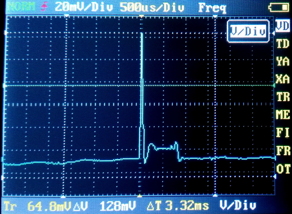

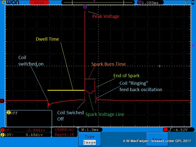

7 years 11 months ago - 7 years 11 months ago #23499 by Andy.MacFadyen

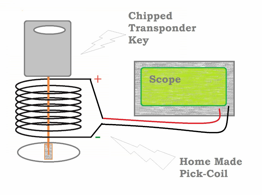

This was taken using the 3 turn inductive probe I made for the imobiliser thread using a little DSO201 Nano but I cannot get to produce a clear signal on my more powerful labscope no matter how I ring the changes on aquisition settings and filter. I may try iy on my Hantek 1008 if I get
time.
If my high school physics is correct this is actually showing the secondary current rather than voltage.

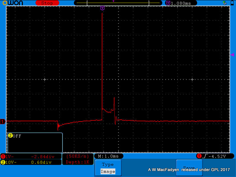

7 years 11 months ago - 7 years 11 months ago #23501 by Andy.MacFadyen
This is the sm#ame coil at idle taken with a Hantek capacitive probe -- it has been inverted as the spark is reverse polarity..

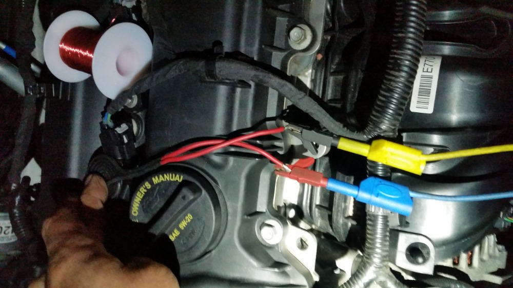

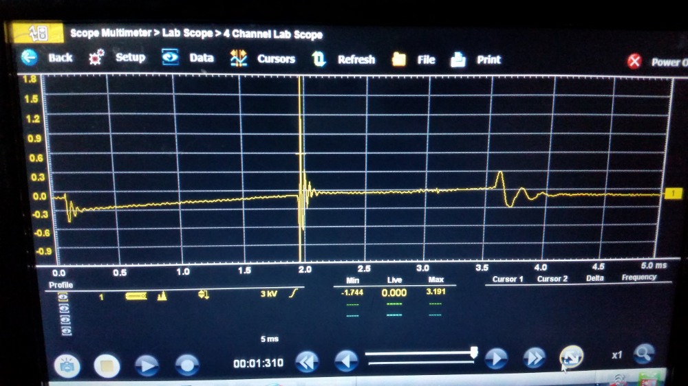

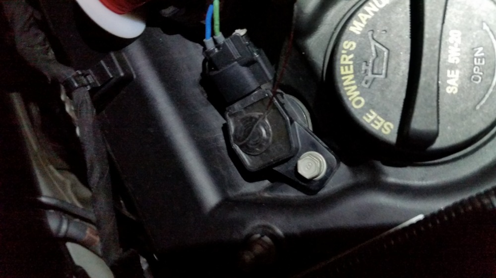

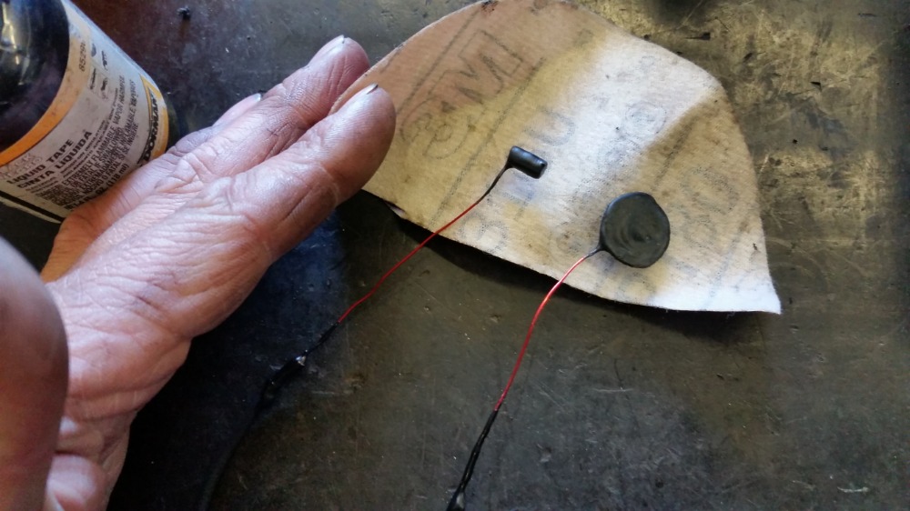

Did some more testing. Made some more ignition probes from 22awg magnet wire.
Interestingly enough, The amount of turns didn't make a difference at all. All my probes produced the same signal strength with very minor differences. My original ones with 16 awg wire had 5 turns and my new ones are 22awg with 13 turns. Produced the same strength signal with the original one possibly having a bit more signal strength.
I also tried using the dual ended probe which I suppose is an inductive probe. Problem with that is using both ends, one end to the ground on the scope and one end to a channel 1, scope not grounded; the signal was very weak. Didn't seem to invert either when flipping the probe over. If disconnect the lead that is connected to the scope ground terminal, the signal drastically increases in strength. So it seems only probes with 1 wire works. The other end covered and not connected to anything.
Now I am wondering if surface area has anything to do with signal strength. I made a probe with 22awg magnet wire that had 3 turns, tiny mini probe and the signal was very weak. I am wondering how a penny or quarter soldered to a wire will do.
2 Probes, Both 13 turns. Wound differently. The flat probe worked the best

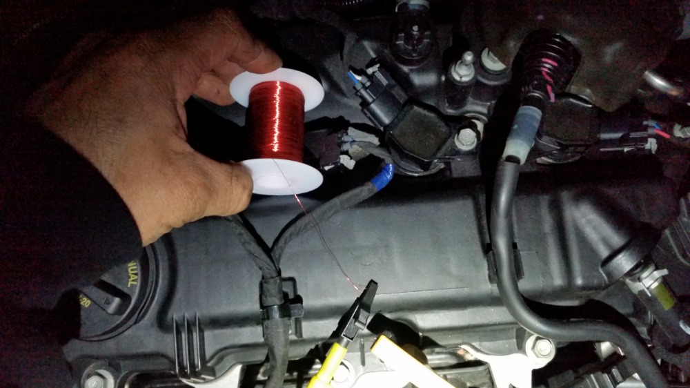

Also tried the entire roll of 22awg magnet wire, produced a weaker signal than the probe, probably has something to do with the orientation of the roll. Similar to the 13 turn tiny probe in the first picture above.

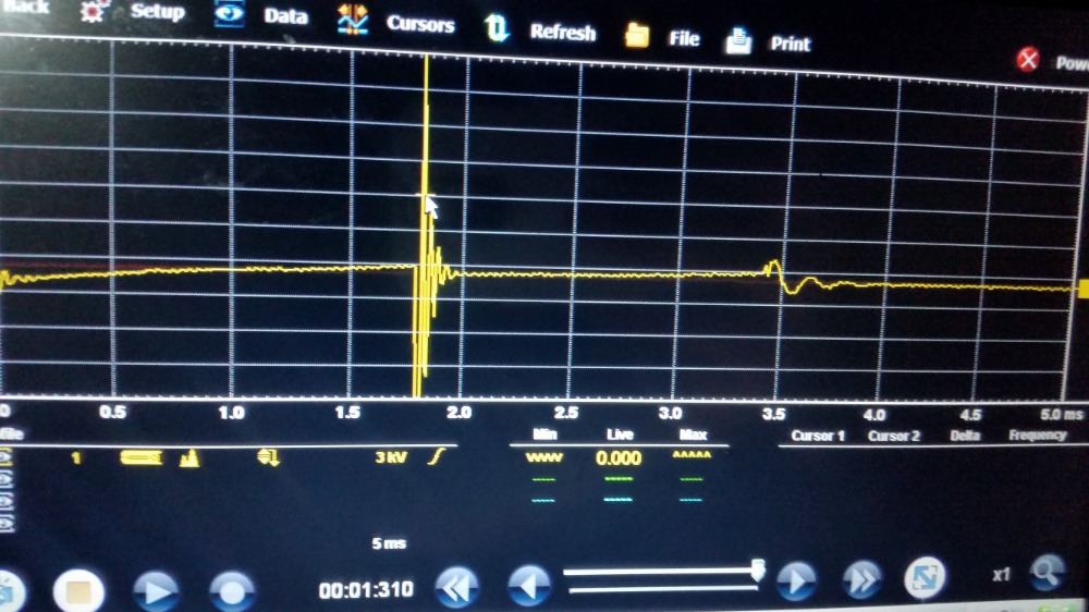

22awg,13 Turn Probe
22AWG 13 Turn Probe Signal

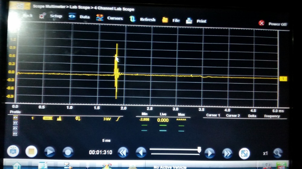

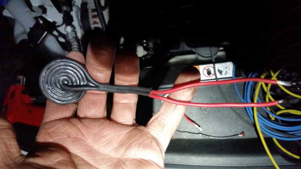

16awg 6 turn Dual ended probe which had a much weaker signal when using both ends.
Dual End Probe using Both Ends
Dual End Probe using One End. For some reason this probe is weaker on these coils but sometimes produces stronger signals on other vehicles. Odd. On my car, this probe was weak for what ever reason.
