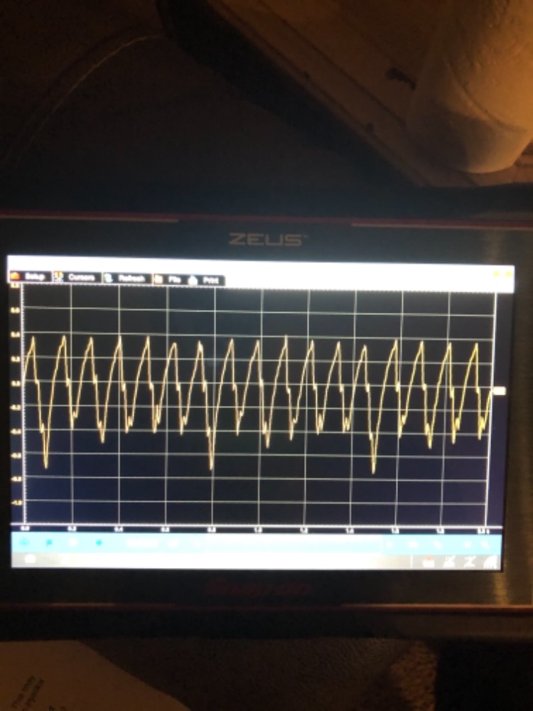

Relative compression was created by Mike T
I did a relative compression test on my 1997 Dodge Ram 2500 5.9L Cummins it has some blow by. On the test it showed good compression but after every 6 compression spikes there was a down dip that I didn’t understand any help would be greatly appreciated.

Mike T wrote: I did a relative compression test on my 1997 Dodge Ram 2500 5.9L Cummins it has some blow by. On the test it showed good compression but after every 6 compression spikes there was a down dip that I didn’t understand any help would be greatly appreciated.
Is that waveform current or voltage? It looks inverted which'd make your dip the top of the best cylinder's compression stroke....

5 years 9 months ago #46488 by Matt T
Replied by Matt T on topic Relative compression
Mike T wrote: It’s on voltage. I’m pretty sure it’s not inverted. The old truck runs good and strong.
I guess I could have worded my earlier reply betterer. It looks like a cranking voltage waveform that hasn't been inverted. That makes it upside down, compared to a cranking current waveform, with the compression peaks at the bottom of the trace instead of at the top.

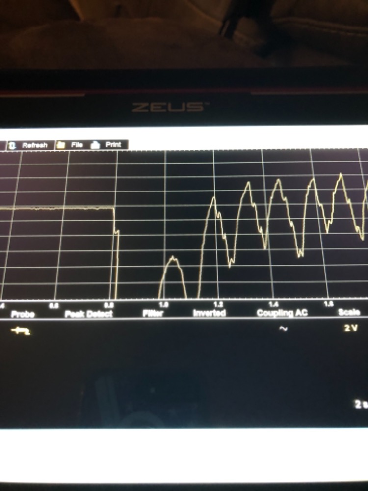

Here is a pic of it starting

5 years 9 months ago #46494 by AJeep18
Replied by AJeep18 on topic Relative compression
Yes your waveform is upside down. When the truck first starts cranking is when it will draw maximum current, but in your picture it is going negative. Hit the invert button on your scope.

5 years 9 months ago #46495 by AJeep18
Also if you notice on the original waveform picture, it looks like (because it is inverted) every single has the exact same amount of compression, and while they should all be very close, I don't usually seem them in a perfect line like that.
