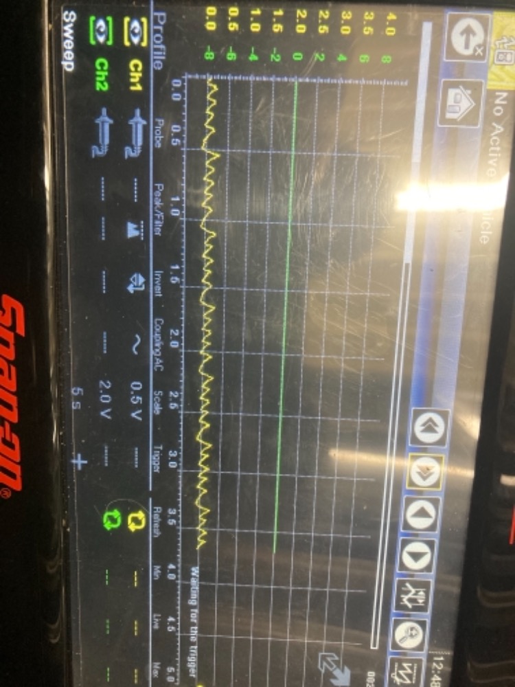

This is a screen shot of one of my other dodges it’s a 2002 Dodge Ram 3500. 5.9l 24 valve second gen and it’s not inverted either but now I’m confused. What way is up?

I know I might be driving you crazy with this lol but if that one is upside down then it’s almost perfectly matched on the compression

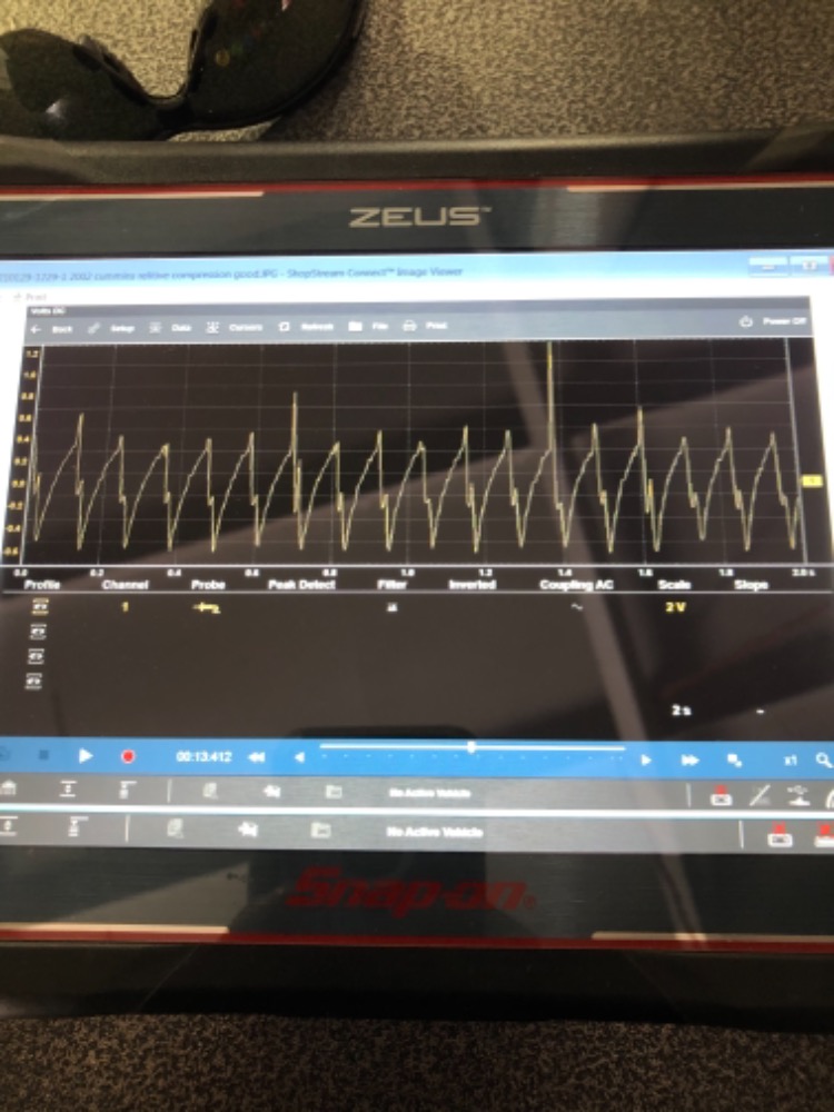

These are the settings I used and the capture I got on a 6.7 Cummins with a bad cylinder, black lead on ground yellow lead on the positive battery cable
The following user(s) said Thank You: Mike T
5 years 8 months ago #46523 by AJeep18
Replied by AJeep18 on topic Relative compression
I do not use an amp clamp. Just use Volts with AC coupling on

Did you see that picture i put of my 2002 dodge the compression looks so close that it looks right side up and its not inverted the spikes across the bottom of the screen witch should have been the top are straight across... lol
5 years 8 months ago #46566 by DougS
Replied by DougS on topic Relative compression
Hi Mike,
It looks as if you did use a voltage scale on your 2002 Dodge and that is how it should look normally. As the starter is cranked, the voltage load on the battery drops as a cylinder hits it's compression stroke and then comes back up until the next cylinder hits compression when it will drop again and so on until you stop cranking. There is actually no need to invert your pattern because that WOULD make the result confusing. Also, unless there is an uneven cranking rhythm (like in your capture of the other Dodge), I would not be too concerned with trying to find a way to synch your capture with something. At some point in the past, I thought Snap-on had a way to synch a diesel by means of clamping some device connected to your scope to a diesel injector tube.
