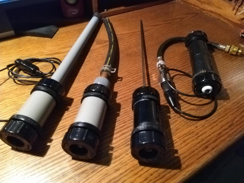

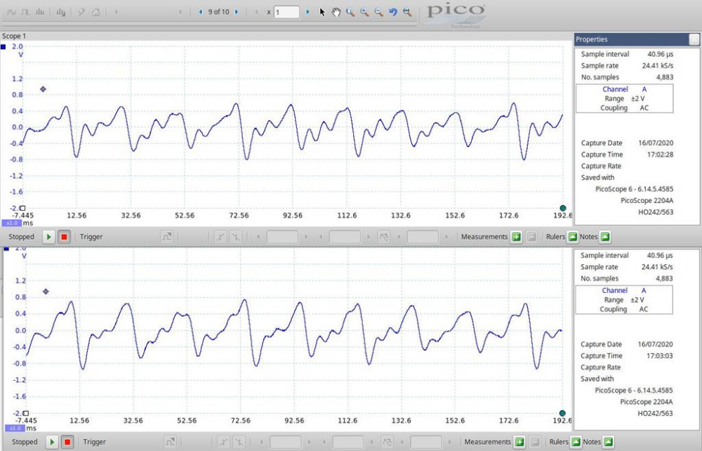

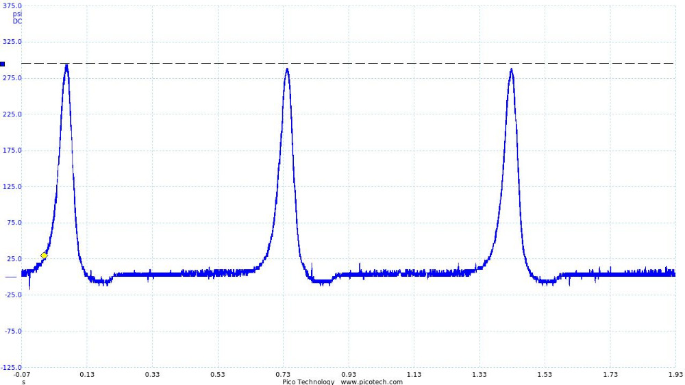

5 years 8 months ago - 5 years 8 months ago #47125 by Wightscope
Show us your homemade Test Equipment was created by Wightscope
This was mentioned in the Rotkee vs Pico thread recently.
I've made quiet a few sensors and get good results.
Some very useful ideas to be found on "gadgets playlist" on YT, I got the stethoscope idea from there.
With a piezo sensor and the range of cheap pressure transducers off ebay (£13/$15) I get some decent results, you just need to build a stable 5v supply - which I did before realizing it would be much easier to use a cheap phone powerpack as they have 5v USB :)
L-->R, COP sensor, exhaust/intake pressure pulse, stethoscope, 5v supply with an in-cylinder sensor on it - It's also used for fuel pressure with a 100psi sensor, I cut/welded an injector and did in-cylinder on a diesel, cut/welded an HO2S with a 15psi for exhaust back pressure.
Diesel in cylinder (this was a 1000psi sensor so resolution not so good)
Exhaust pulse V8 Jaaag

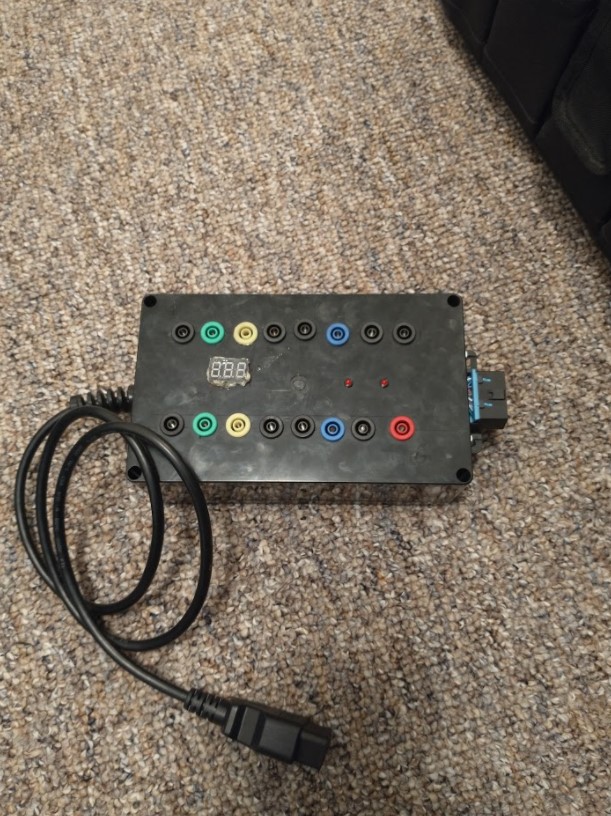

5 years 8 months ago #47126 by Tyler
Replied by Tyler on topic Show us your homemade Sensors
Can we open up the discussion to include homemade test equipment in general?
'Cause I got a gem here :lol: - my homemade DLC BOB:
Yes, I drilled the holes by eye. Yes, that's Gorilla Glue holding the voltmeter in place.

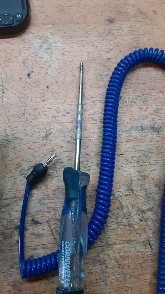

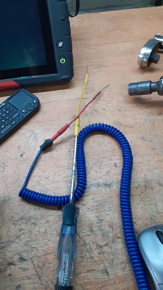

5 years 7 months ago - 5 years 7 months ago #47310 by Noah
Replied by Noah on topic Re:Show us your homemade Sensors
Banana jack test light!Works with all my back probes, piercing probes, alligators and spade connectors. Plus it plugs right into my Power Probe extension lead and Power Probe cigarette lighter adapter, making it super easy to have a good ground or battery feed anywhere you are in the car.

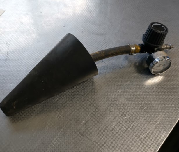

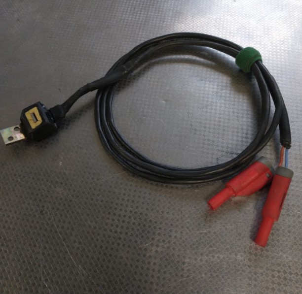

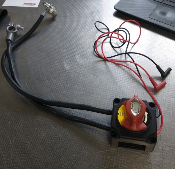

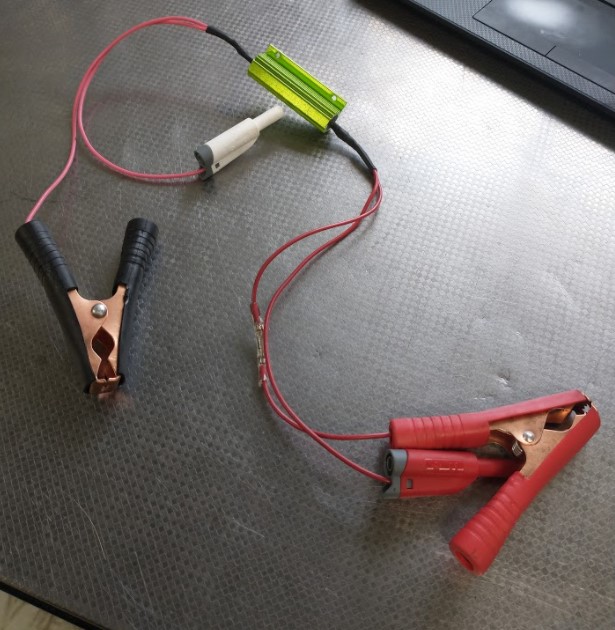

5 years 7 months ago #47338 by Tyler
Replied by Tyler on topic Show us your homemade Test Equipment
First up, my MVP for parasitic drain testing:
Then there's the less used Pico drain tester. Only comes out when I want to measure draw overnight or longer:
The classic exhaust leak pressure tester! Gauge doesn't work anymore. :blush:
My go-to for COP secondary waveforms. Guts of a Honda distributor, some Amazon cable and Digikey ends.

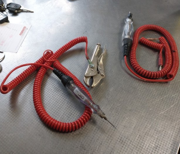

Last but not least, my test lights! Moe and Joe. Moe got sucked into a fan blade awhile back, hence the mid-coil repair.

  • Wightscope
  • Wightscope's Avatar Topic Author
5 years 7 months ago #47344 by Wightscope
Replied by Wightscope on topic Show us your homemade Test Equipment
Like the vice grip earth. I saw that Eric O does that, seems like a good mod. Looks like you do a lot of parasitic drain testing!

5 years 7 months ago #47357 by Tyler
Wightscope wrote: Like the vice grip earth. I saw that Eric O does that, seems like a good mod. Looks like you do a lot of parasitic drain testing!
Oh I blatantly stole the vice grip thing from SMA. :silly: After doing that, I can't go back to normal test light clips.

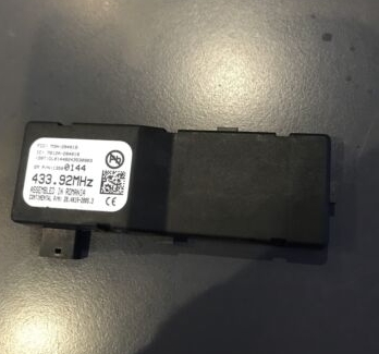

  • Wightscope
5 years 7 months ago - 5 years 7 months ago #47539 by Wightscope
Right so bought the first antenna I came across on eBay , looks just like ones I have seen before, it's off a 2012 Vauxhall (GM) Astra. However when it arrived it's got 4 wires. All the info I have is for 3 wires. I am assuming it's just an extra ground.
Does not appear to be any info available on it - typical! Before I give in and buy another one does anyone have a plug out for similar?
Last edit: 5 years 7 months ago by Wightscope.

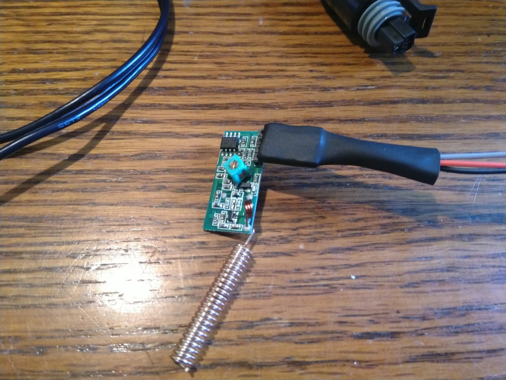

  • Wightscope

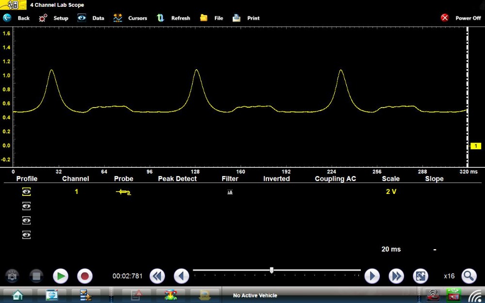

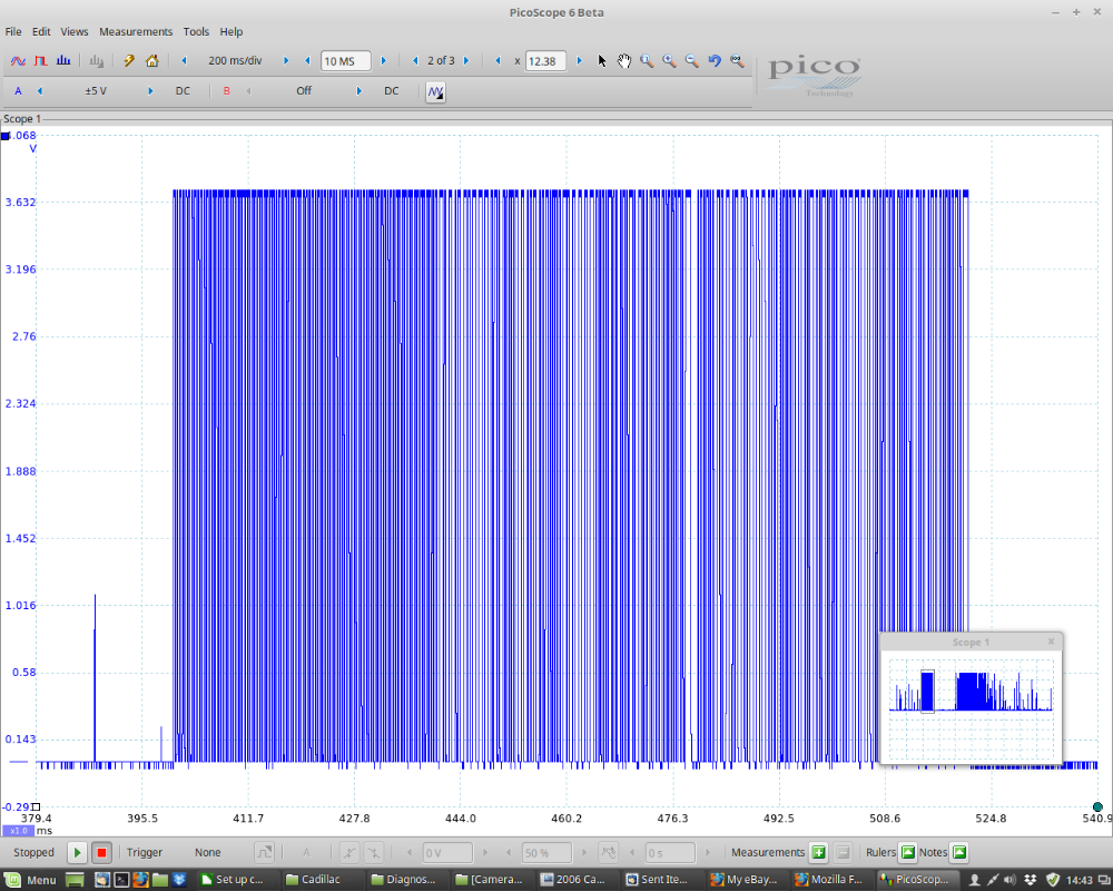

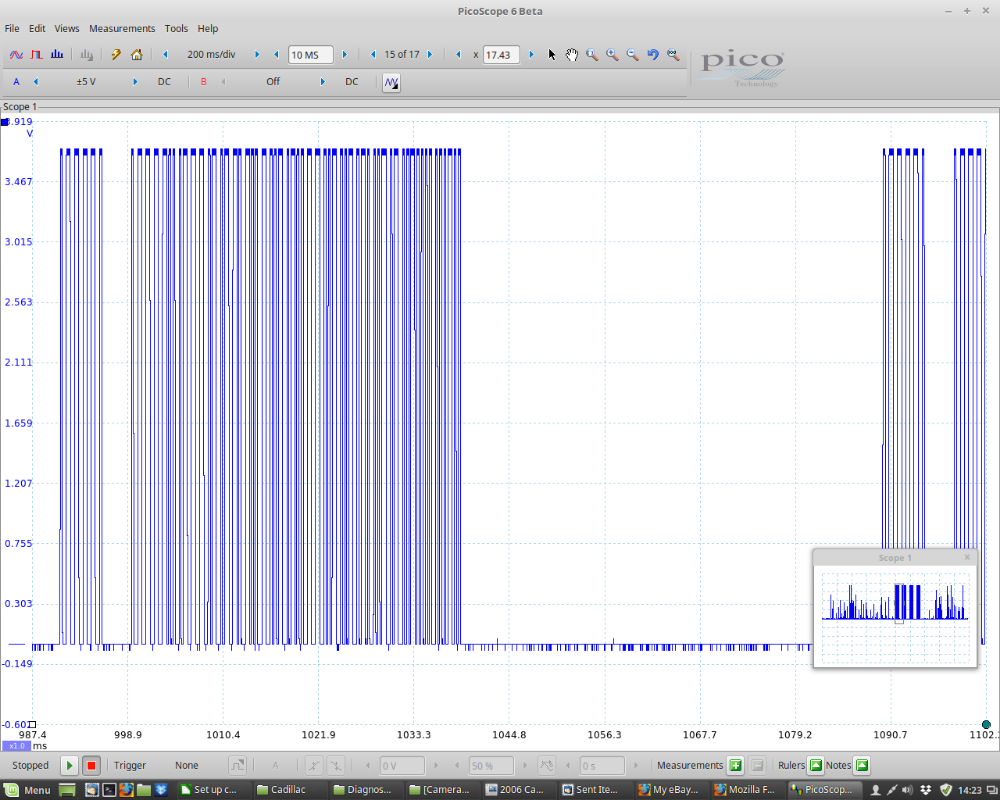

5 years 7 months ago - 5 years 7 months ago #47899 by Wightscope
So for the princely sum of about $6 I got a 433Mhz receiver off ebay. Hooked it up to 5v and the scope;
Peugeot Key (single block of transmission)
Jag Key (3 blocks transmitted)

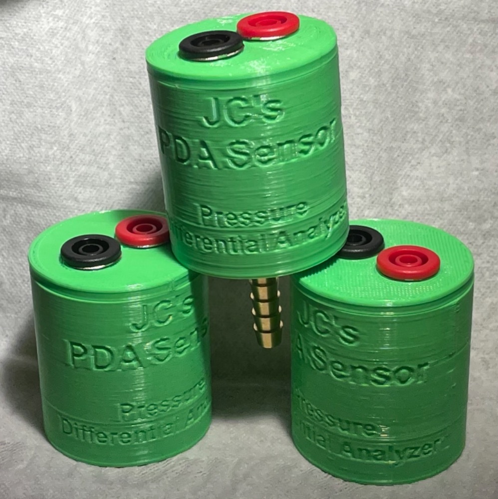

5 years 6 months ago #48311 by John Curtis
Replied by John Curtis on topic Show us your homemade Test Equipment
I’ve got a whole list of things to develop and make. So far this is it.
