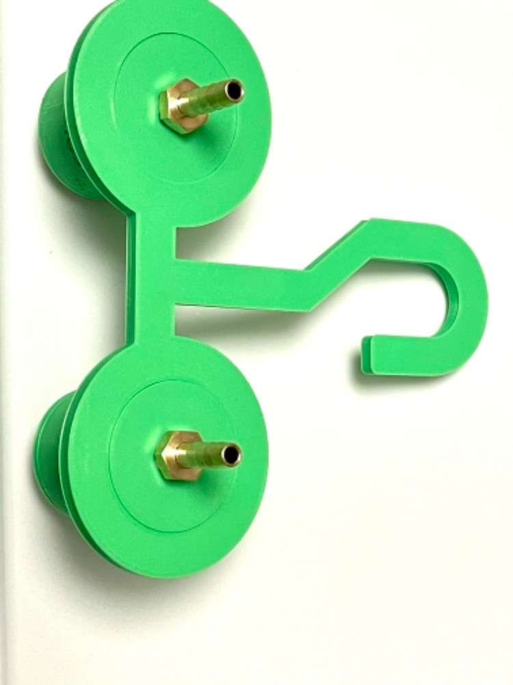

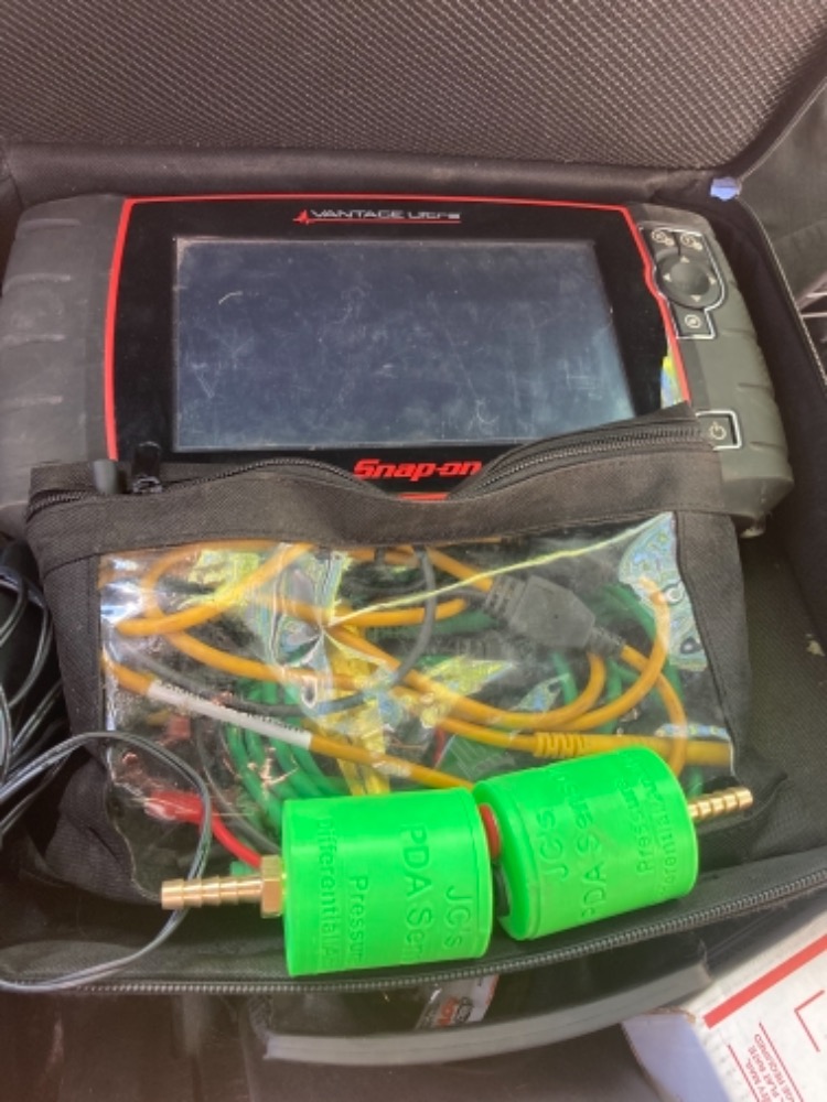

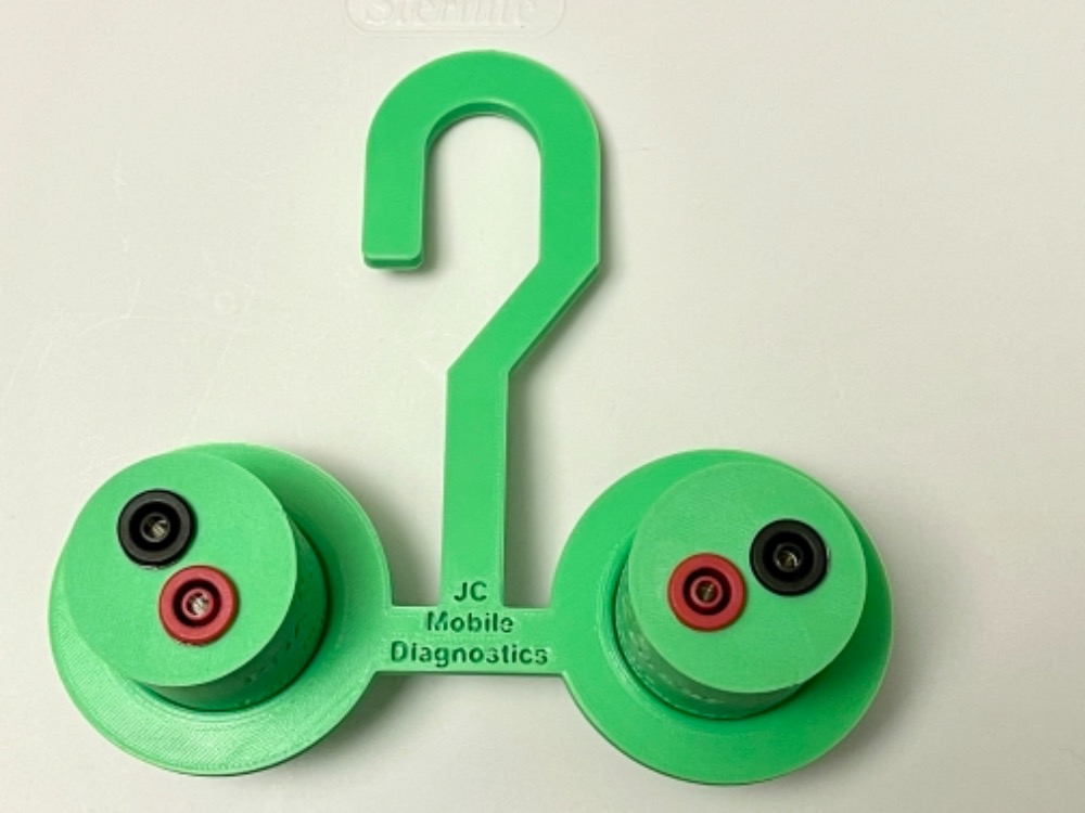

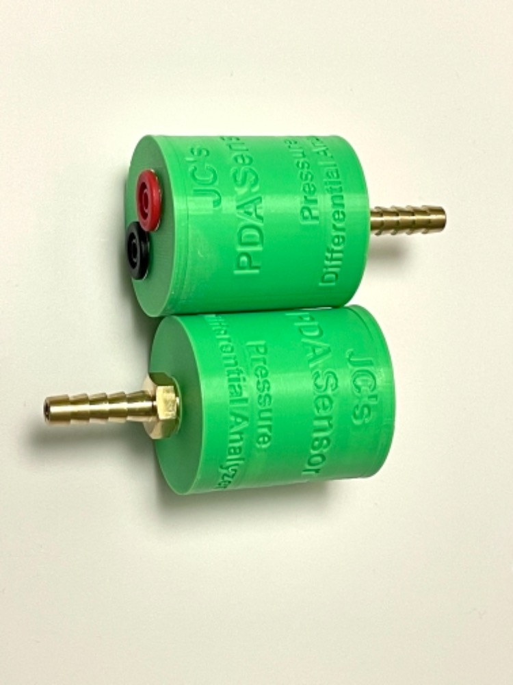

Thanks. Just tuned everything in and fixed the flaws going forward that were in the initial sets. The initial sets are functional but a tiny bit out of square during production. Figured I’d make a holder for them that can double as a way to hold my test leads.
Unfortunately I’ve got about 4 sensors that aren’t perfect visually but have the same functionality.

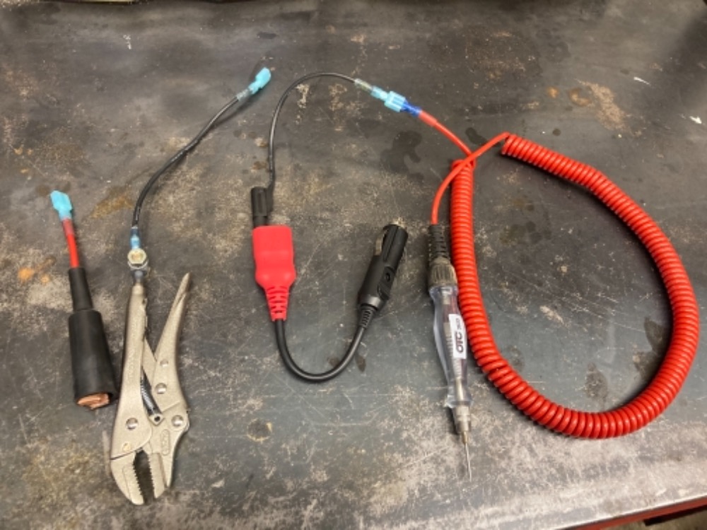

Going off some of the ideas here, I decided to “mod” my test light. Added an insulated female spade terminal to the end and then male ones the the end of the attachments I wanted, I think it worked out pretty well! And no need to have 3 different test lights with different ends!

Nice !

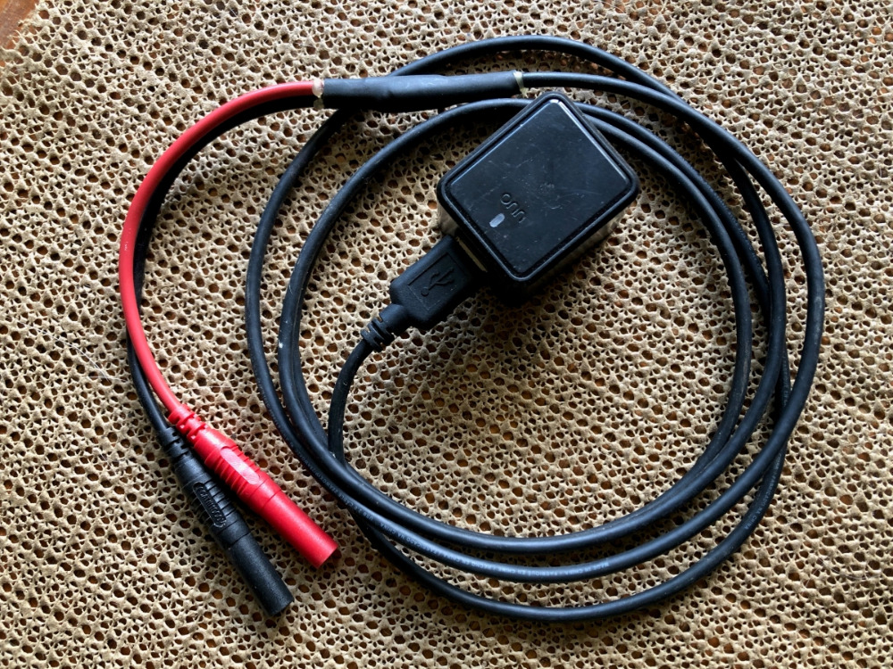

I have been using stackable banana plugs - effectively both male and female so one on the test light one on the earth clamp and all my probes also fit so I can alligator or probe for a jumper.
Also got a 10ft double ended retractable reel that has two wires, one I put stackable bananas on each end, others are alligators.
Just made a cable today for using a phone power bank as a 5v power supply for pressure transducers, added 33ohms of resistance else the powerbank shuts off after 30s. Sadly 150ma was too much for the LED I built in to it!
5 years 6 months ago #48518 by Matt T
Replied by Matt T on topic Show us your homemade Test Equipment
Wightscope wrote: Just made a cable today for using a phone power bank as a 5v power supply for pressure transducers, added 33ohms of resistance else the powerbank shuts off after 30s. Sadly 150ma was too much for the LED I built in to it!
Good thinking about the resistor. I've had problems with both a power bank and a 18V>12V/5V power tool battery adapter shutting down at low load with my USB>Banana cable. The tool battery adapter was also shutting off the 12V with my 10-30V "transducers". Hacked it to to run 18V straight from the battery to the 12V port.

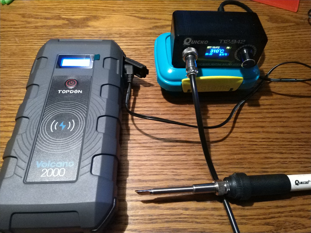

For 12v stuff I bought one of those 20AHr Lithium jump starters with a 10A, 12v output on a 5mm plug.
Mainly use it via a 12/24v buck to run a Quiko soldering iron set up - that works really well -and I have a Jump starter handy as a bonus.
Most of my transducers are 5v but I just got a 10Bar absolute (ie complete vacuum to +9bar) sensor that is 12v, - going to need a load cable for that too.
