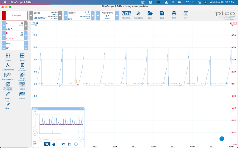

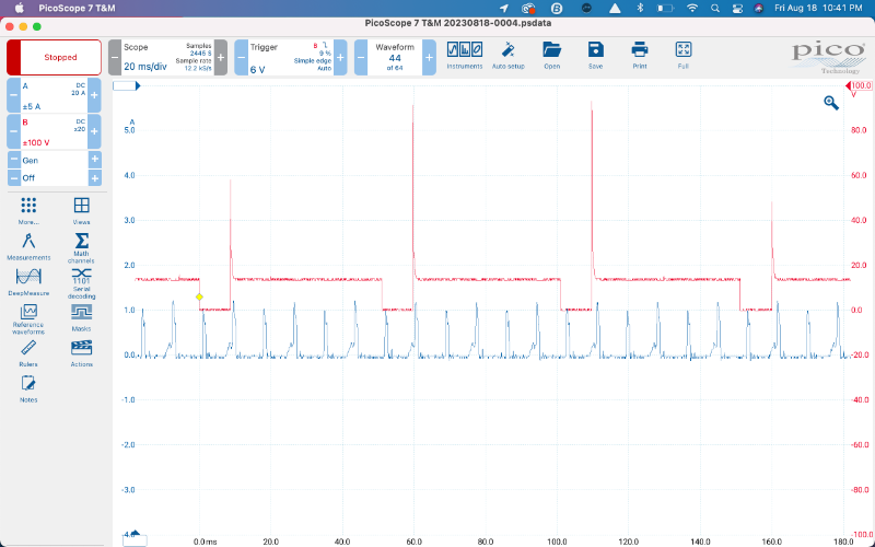

Ok, so i just re attached my lead to the trigger wire directly at the number 3 coil. I am now getting a different look. I also swapped out the only aftermarket coil from 5 to 3 and that seems to be where the lower amperage spike is now.
Here is the new screenshot.
So, what do I need to do next? Josh had mentioned testing the injectors and others have mentioned testing voltage drops. If you guys could walk me through how to perform these tests, or point me to a site that explains it I'd appreciate it. I will also try to drive this again and make it misfire to see what the scope reads considering my previous attempt was wrong.

3 years 2 months ago #62655 by juergen.scholl
Replied by juergen.scholl on topic Cannot fix Single cylinder misfire under load.
I 'suppose' in the other capture you did not connect to the coil but to an injector.There are a couple of reasons to believe this:
1 - how would still current flow through the coil as indicated by the blue trace without being triggered?
2 - the shape and time of the sync signal (red trace) looks nowhere normal for a coil trigger.
Where the signal onthe red trace disapperars is probably when the kijector was shut down.
Though the difference in coil current is not normal I would not focus on that for now. It maybe caused by different coil designs, simple as this. 9 amps is still enough to fire a coil under heavy load in my book.
Try to capture both injectors of the missing and of a good cylinder when the misfire occurs, one cylinder at a time.
You also may want to take crank sensor capture under different load and rpm conditions to check for any possible deviations that may cause the ecm to see a misfire, be it real or not.

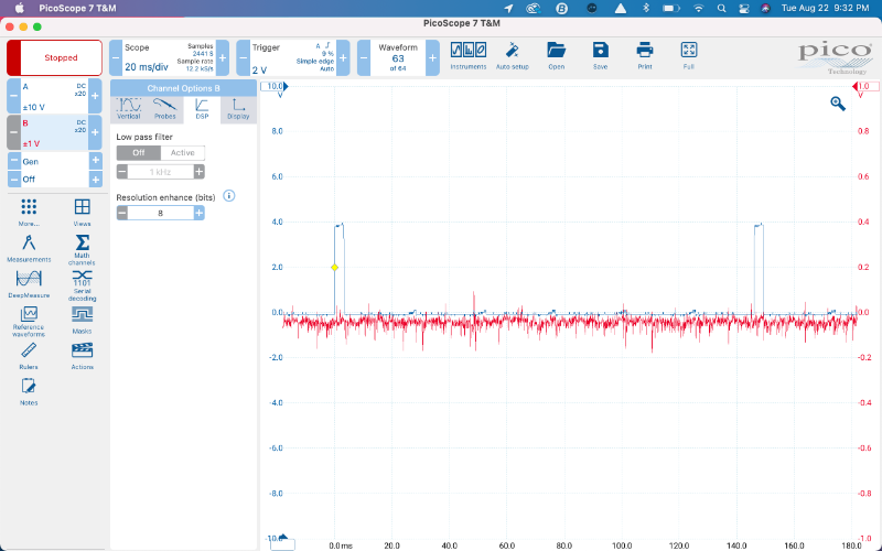

Apologies for late report. Its a bit tough to get out and mess with this thing having a toddler.

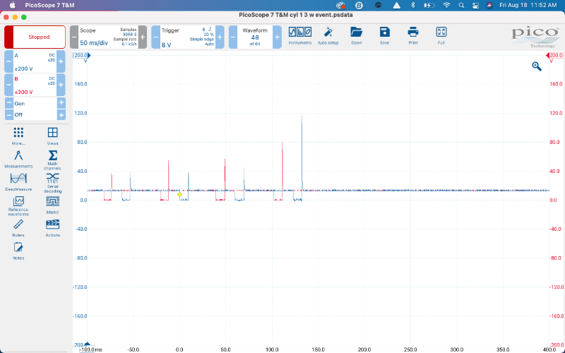

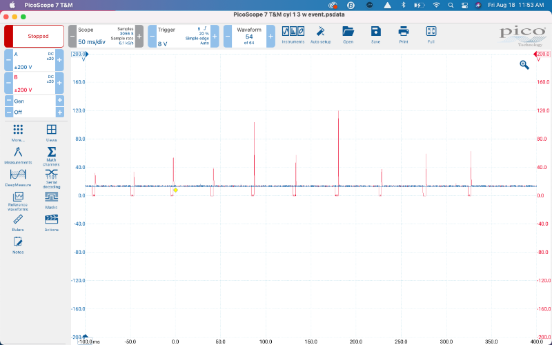

So I hooked up my 2 channel scope to the port injectors on 1 and 3 to get a comparison and then made the truck misfire like before. It looks like the port injectors turn off at around 2300 rpm, so I will need to try the direct injectors next. All I could tell from the capture was that both of the injectors turned off at 23-2500 rpm and after the misfire happened at around 3500 rpm, only number 1 injector came back on when the engine rpm came down.
This is where both turned off at around 2300 rpm or so.
And this is after the misfire and as the port injectors turn back on.
3 years 2 months ago #62681 by JoshuaK
That makes sense. #3 was shut down after the misfire to protect the catalyst.

  • juergen.scholl
  • juergen.scholl's Avatar
  • Active partschanger
3 years 2 months ago #62682 by juergen.scholl
Get one capture connected to #1 port injector on one channel and #1 gdi inyector on the other channel. This should show the transitions between both injection system on acceleration and deceleration while working normally.
Then get another capture, this time connected to #1 and #3 GDI injectors. .
This may allow to relate the misfire on #3 with 'somerthing' concerning the direct injection..
Did you ever play with the GDI injectors, swapping them around or looking for pressure changes in the rail while activating them?
Often GDI injectors' power feeds are grouped in pairs, so probably no fault there.

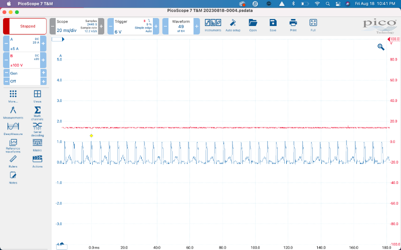

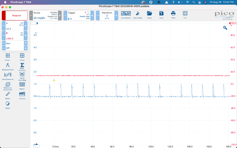

Ok, so I went out and hooked up the amp clamp to one of the wires that feed the direct injectors and the other channel I hooked to the number 3 port injector. With this unfortunately, the trigger goes away when that injector turns off but I wanted to see what that injector was doing. I may try again using the number 3 coil for reference.
I can not see any differences in the current ramping between the cylinders, but there is definitely a hump every other firing. Once the misfire happens, that humps no longer exists. I don't know why, but thats the only thing I could see that was different before and after the event. I will add photos below. I did the same tests with my trigger on cylinder 1 port injector and the capture looks exactly the same.

3 years 2 months ago #62686 by juergen.scholl
Because of the low sample rate the meaning of the amp capture is limited. You may want to select a shorter time base and crank up the sample rate ..
Is there anything else on this circuit that provides power to the port injectors?
So it's the port injector that (gets) shut(s) down, good to know.Do the same test with the GDI injectors.
Misfire detection is based on crankshaft acceleration so a varying/defective ckp signal may cause an issue. I would look at the ckp signal under varying load/rpm conditions, again with the highest sample rate possible, alone and with the CMP signal.
Is there any misfire count for the companion cylinder, mane in Mode 6?

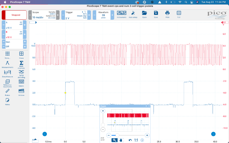

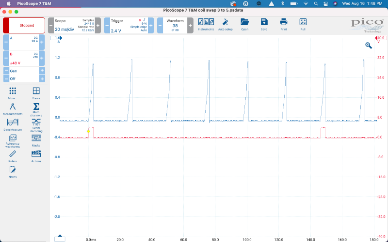

I tried unplugging the direct injectors and the motor would stall at idle after it warmed up and wouldn't run at all even with my foot on the throttle, so that was a no go.
I did another current ramp test on the power feed to the coils and made the truck misfire. I see nothing in waveform that suggests that the coil isn't firing.
I tested the CPS to see if it was acting up during the event and again, I see nothing to suggest that.
I then tried hooking up the IGF for a shot of its waveform and I couldn't get a signal. I checked as best I could online and in the wiring diagrams I've been using for this truck to see if toyota uses that extra coil wire for a ground or for IGF and it appears that I should be getting a squarewave out of that wire to signal that the coil did in fact fire. All I'm seeing is what appears to be a random trash signal that doesn't see to match anything. I'd really like to confirm this at some point if possible. I am currently watching ScannerDanner video "operation and testing coil over plug ignition (4 wire) toyota/lexus" so if my truck is the same as this one, I should be able to get a signal. I am using my main lead on the signal wire at the ecm for bank 1 and the ground is grounded to the frame of the truck (same ground I'm using for the other lead). This is the only waveform I got from this.
I will try again next chance I get to do this test again, with both banks.

I’m curious. If the ecm can’t get feedback from the coils, would it shut down the cylinder? I’m shooting in the dark of course, but it’s a valid question
